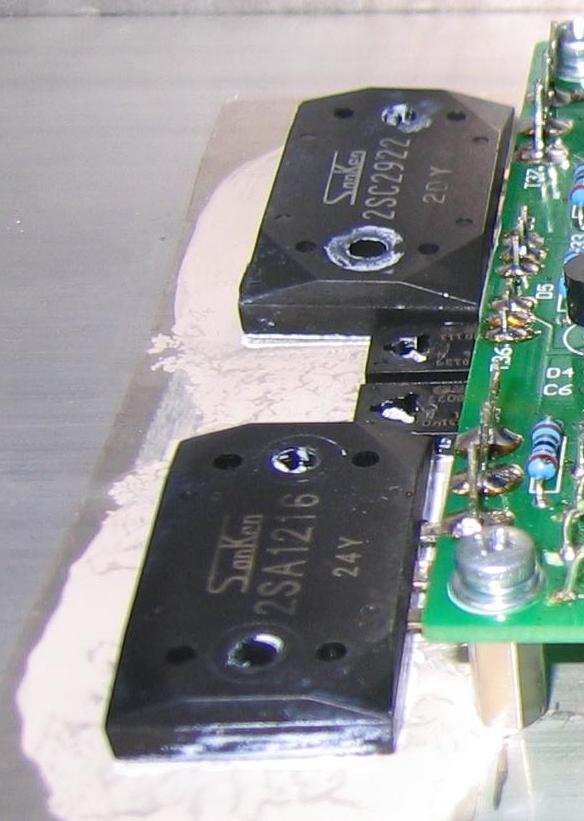

The piece we have spoken about has had horrible output DC fluctuations without any signal source, just with input terminals shorted. There is a kind of instability inside, difficult to find. My strong suspect goes to output stage local instability initiated by transients from supply diode switch off and transient recovery voltage spikes, through rails. Based on further measurements.
I can't really comment on something I've not seen myself but such behavior could certainly be attributed to the loop stability, which has improved with the suggested change of capacitor values. It is not outside the realm of possibilities that on some builds the loop stability is marginal due to larger than expected variations in parts or wiring/hookup.
I'd be happy to try and address any such issues with anyone experiencing DC fluctuations on the output. Just post your query in this topic and be sure to include detailed photos and a description of your build.
One known issue with DC offset I am aware of was due to the fact that a few people used counterfeit 2SA1216/2SC2922 parts. These parts also failed after a short period of use as they couldn't cope with the dissipation.
I had a similar experience with 2SA1302/2SC3281 fakes some 12 years ago.
Sander, in your experience, genuine or fake?
I personally only purchase these transistors from a official Sanken distributor, which is also listed as such by Sanken themselves. I've had many bad experiences with the likes of eBay, Reichelt, ASWO, Nedis, etc. etc.
The fakes are such good copies physically, down to the texture of the case, the printing/font and the plating on the metal parts that you really need to sacrifice a pair and crack them open to inspect the actual die.
In respect to your photo, I can't say for sure, it depends on where these were sourced from.
Unfortunately, I do not know the source. It is the amplifier I was asked to measure.
P.s. there's an excessive amount of thermal grease used, and by the looks of it mica pads? I would advice against that strongly, as the thermal impedance is far too high. Thin, silicone, thermal pads should be used, Bergquist for example has good pads with great thermal characteristics.
Please keep in mind that dissipation per transistor is approx. 50W, that's a lot of heat to dissipate from an area the size of a poststamp, hence making sure the thermal resistance is low enough really is a requirement. Otherwise thermal imbalance will also result in higher DC offset.
Bergquist Sil-Pad 1200 is what I've used often and which works very well, this can be bought from various suppliers in large sheets, so can be cut to size easily with a knife/scissors.
Sil-Pad Products ~ Thermal Materials, Thermal Solutions ~ The Bergquist Company
Most thermal pads of the type you mention have HIGHER Thermal Resistance than thin mica with thermal paste on both sides.P.s. there's an excessive amount of thermal grease used, and by the looks of it mica pads? I would advice against that strongly, as the thermal impedance is far too high. Thin, silicone, thermal pads should be used, Bergquist for example has good pads with great thermal characteristics.................
