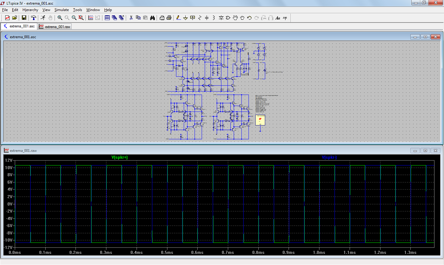

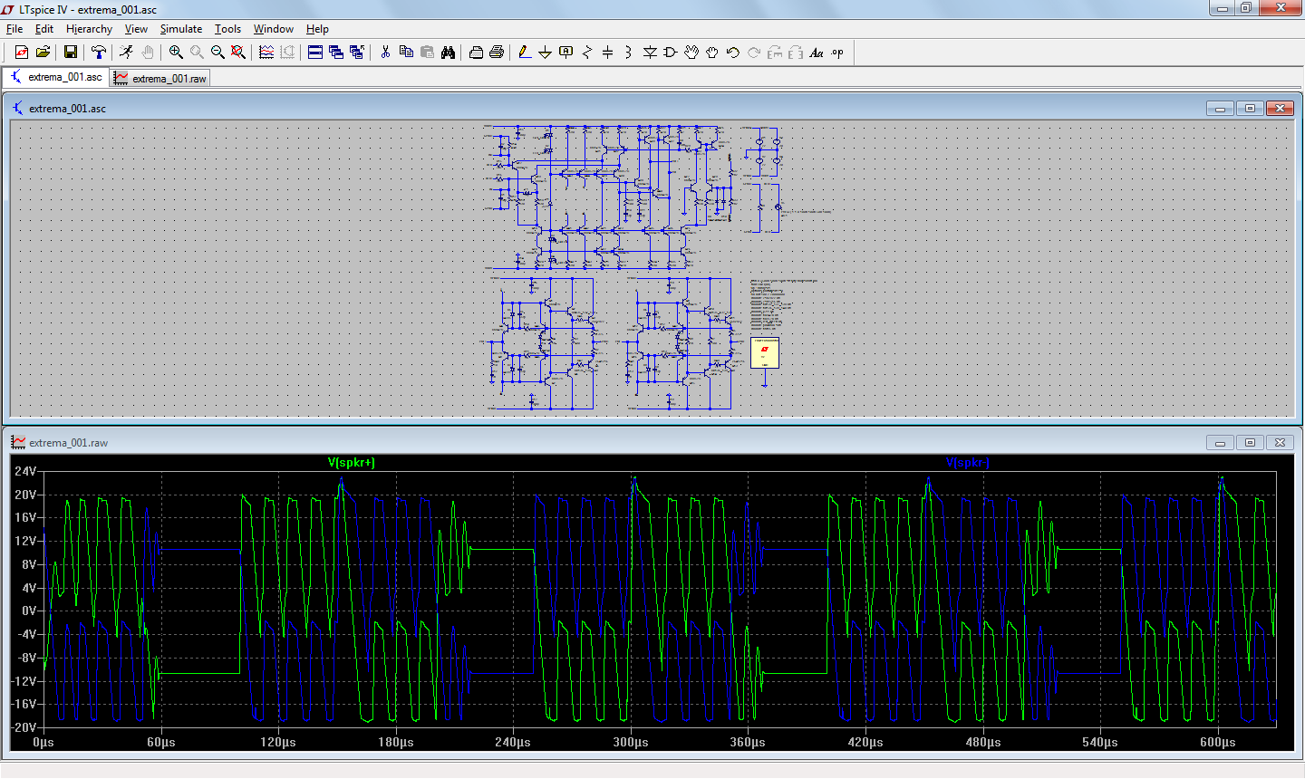

Despite the fact I've already evaluated your suggestion prior to you making it I'll repeat the exercise and post the screenshot below from stimulating the input with a squarewave (PULSE(-1 1 0 100n 100n 50u 100u)). It simply doesn't work, see below noted screenshot from the simulation with C//47K = 10pF.
However the suggestion I've provided and exhaustively evaluated in the simulator works, please refer to the attached screenshot simulating the same squarewave.
Furthermore this has also been verified by two people that implemented these changes on their ExtremA and have looked at the step response independently, their results match the results I've obtained in the simulator.
So I welcome your feedback, but it needs to be a bit more in depth and constructive in order to be worthwhile.
SSassen, if negative feedback C // 47K, leads to instability, it is bad.
Error in search Boucherot 10R + 1 nF ... Total negative feedback must fulfill the function to stability.
I'm starting to wonder whether you've been privvy to the whole discussion leading up to the changes I've proposed to the ExtremA design?
