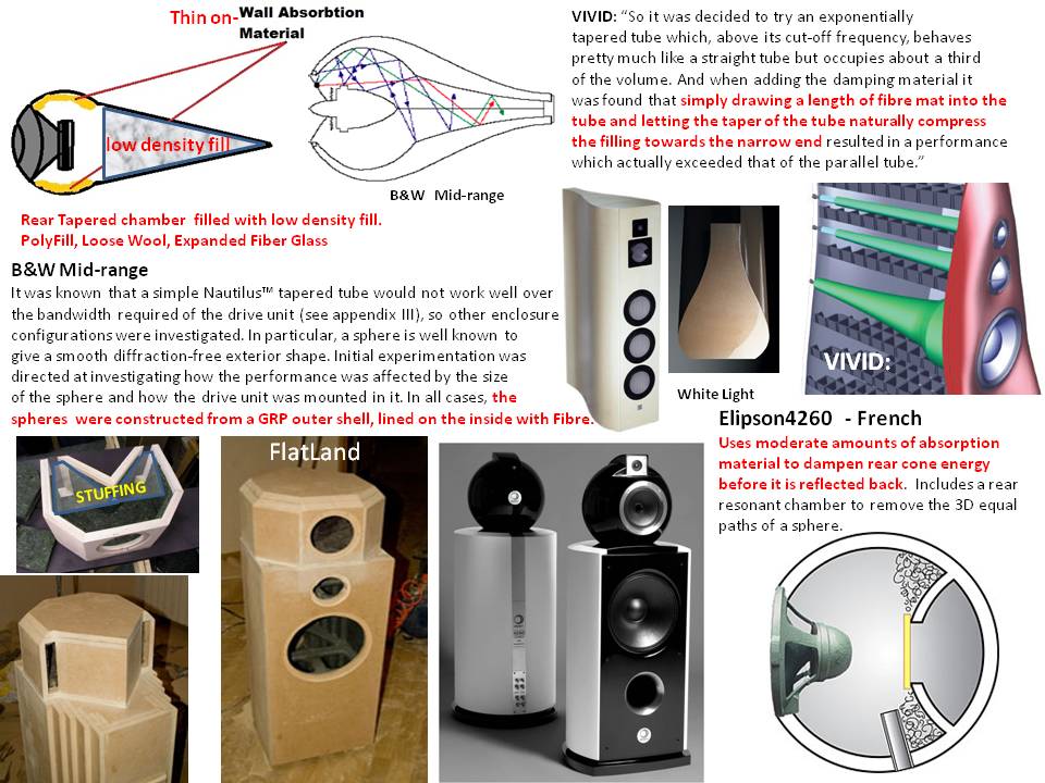

A sphere cabinet shape has several SPL resonances. B&W added a rear tapered tube stuffed with absorption material. French Elipson 4260 uses a midrange sphere cabinet, BUT adds a rear resonant chamber to remove the 3D equal paths resonances of a sphere.
It is best to design cabinets which reduce resonances, and then add absorption material like B&W.
