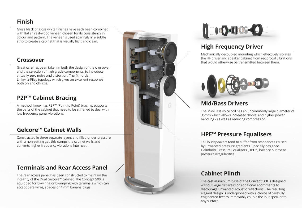

You are referring to Helmholtz Pressure Equalisers (HPE) as used in the Q Acoustics Concept 500 floorstanders.
Q Acoustics Concept 500 loudspeaker | Stereophile.com
"Tuned tubes inside the cabinet quell internal resonances (standing waves) that develop in the longest dimensions of a speaker enclosure.
Q calls this Helmholtz Pressure Equalization (HPE)."
The basic principles are referred to here:
Engineering Acoustics/Noise control with self-tuning Helmholtz resonators - Wikibooks, open books for an open world
For interest's sake, the attachment shows a cutaway Concept 500 revealing the HPE pressure equalisers.
