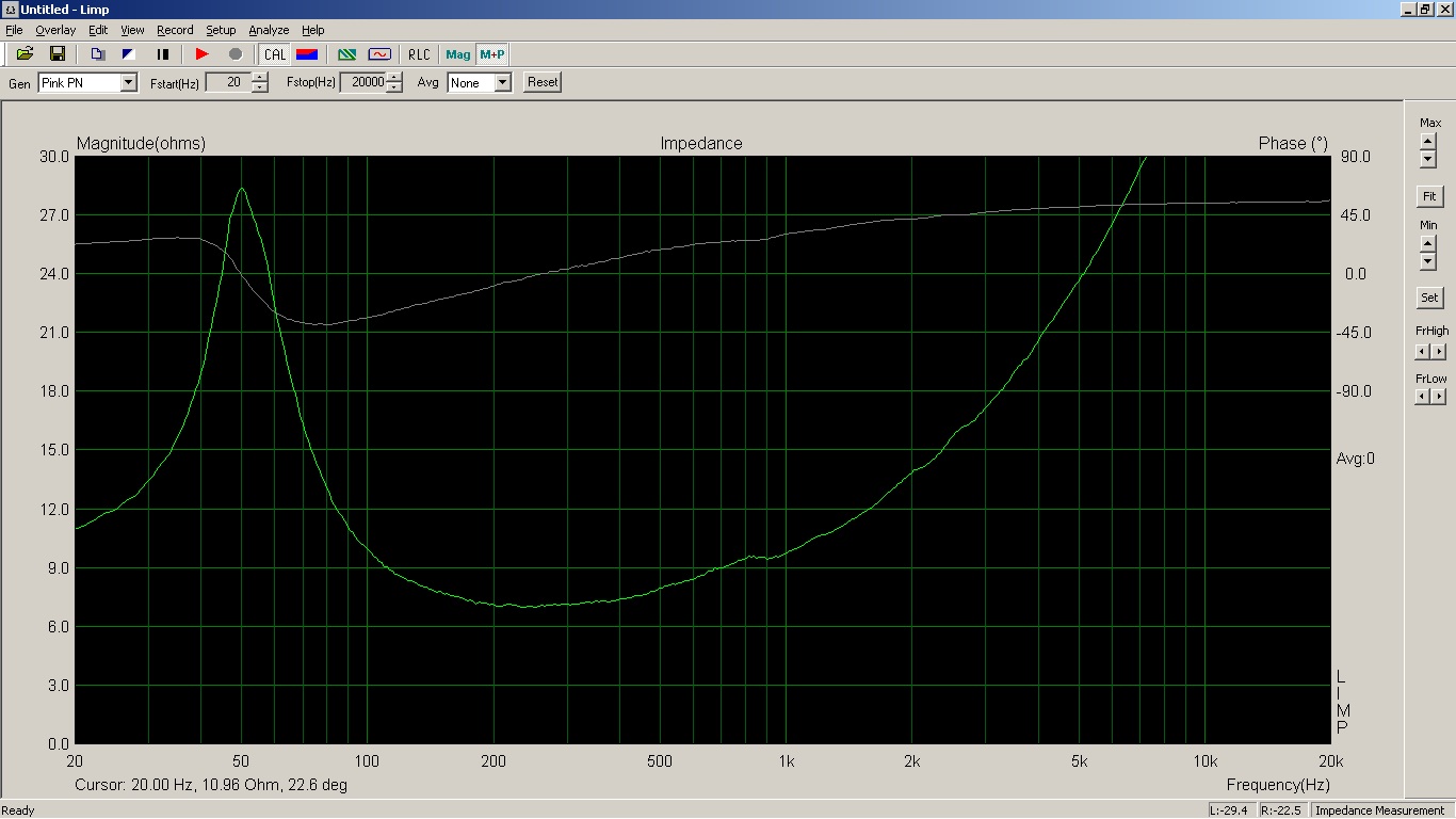

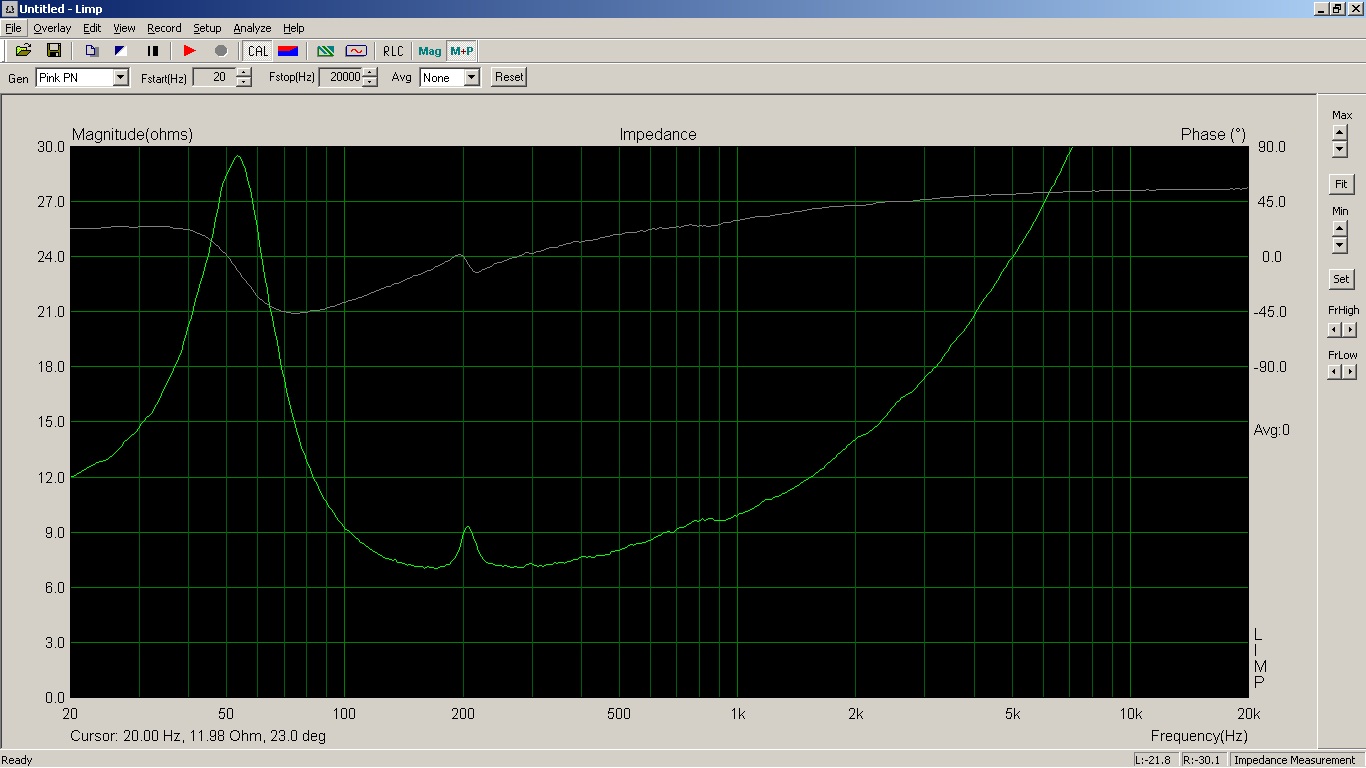

I have no picture of the impedance S, but it was pretty sharp, not over a wide frequncy range. A quick dip and peak.
Sorry, forgot to mention that too: the bass reflex was plugged during the test
Ok -- but this does not change my point: the additional volume of the resonator makes your woofer see a larger volume than it did before. The bass tuning will be different than before.
I did not like the way the impedance curve looked from the resonance of the resonator. Like an S in the impedance curve with relatively high peak and dip compared to the small peak from the original standing wave in the box. I could see the S moving in frequency when I stuffed the resonator, and it disappeared with the resonator disabled.
A figure would have been useful 😉, but it seems the resonator wasn't tuned to the right frequency.

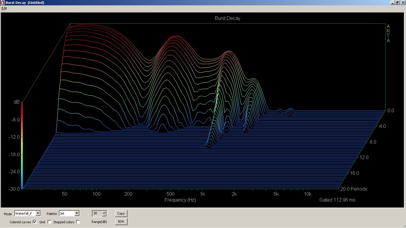

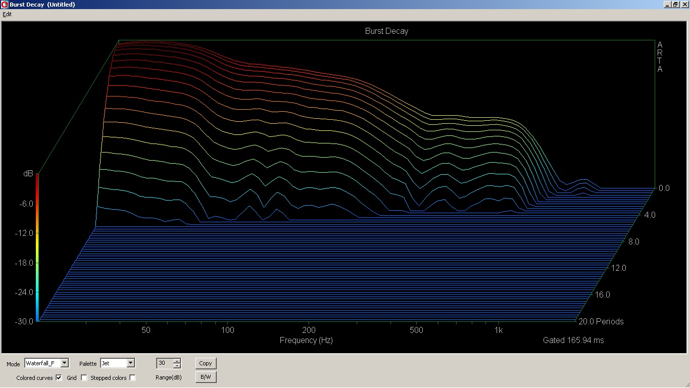

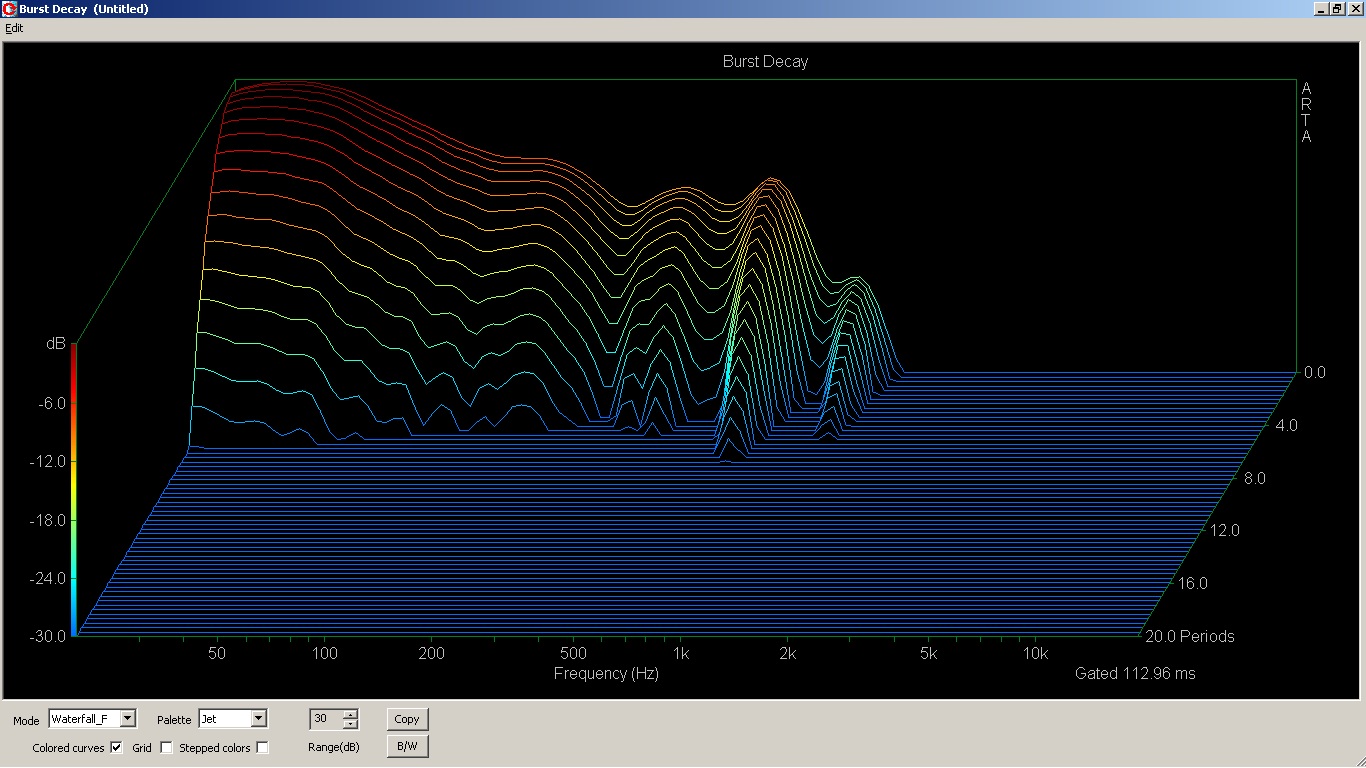

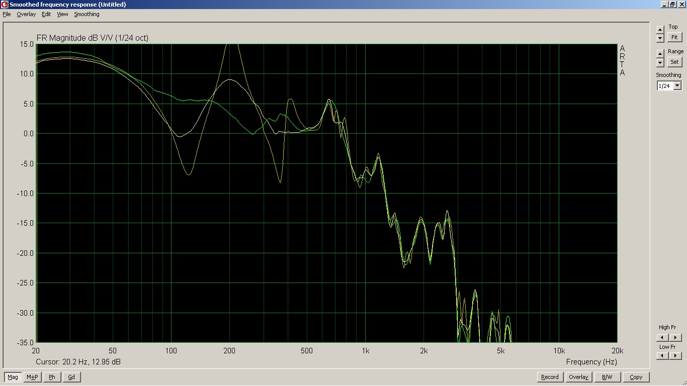

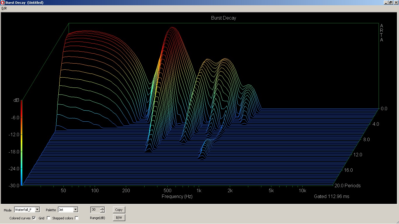

I did some more investigations in this subject yesterday. Now another box and driver than before. This is a Peerless 8" mounted in a tower enclosure (butchered Dali 104). The driver is in the upper end of the baffle, so worst position, but I want it like this to be able to try different mids & tweeters placed separately on top of the woofer cabinet.
The baffle is just clamped on for easy access, and I placed a measurement mic inside the cabinet behind the woofer, to see the actual back-waves acting on the rear of the cone. I also measured impedance.
Empty box -worst case, with high peaks and deep nulls, long reverb on CSD, clear peak on impedance (only for main standing wave)
Angled bottom panel -Almost same as previous
Block of foam in the bottom -clear improvement on peaks and nulls and CSD, small bump visible on impedance
Block of foam in the middle of the box -very good, curve close to flat and CSD looking really nice. However some increased amplitude in the lowest frequencies (inside the box), indicating more pressure for the woofer to work against possibly giving less LF output. However, Fs was same as foam in bottom, and slightly lower than no foam. No peak on impedance.
Resonator in the bottom-cancelled the main standing wave pretty well (similar to foam in bottom), but the other nulls and peaks were still there unaffected. Small peak on impedance, similar to foam in bottom.
The frequency response in first picture shows Empty box, foam in bottom, and foam in center. I think it's easy to guess which is which..

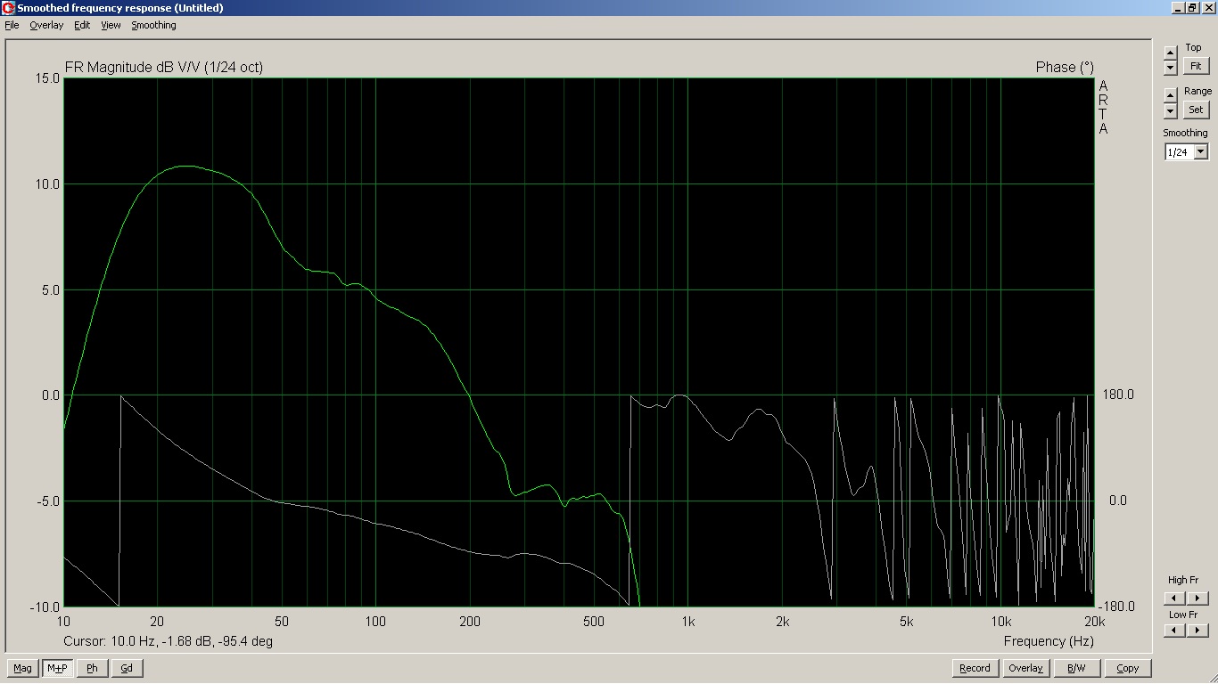

I did some more testing today, moving around the foam block a little, and adding some poly wadding. Partly tuning by ear, and measuring after the fact.
Foam block is placed at an angle in central position, and a little bit of poly wadding on top of that.
I will add bracing for rigidity and add felt to the walls for damping higher frequencies, but I think I have made the best I can of the situation when it comes to standing waves, or are there more suggestions?
I am not sure what to make from your measurement plots because I don't know how your measured those. Are these nearfield measurements taken close to the woofer?
Electrical impedance would be interesting, too. If you zoom in to the frequency range(s) where the resonances happen you can often see a wiggle in the impedance curve. If the wiggle goes away after "treatment" with the absorber, you killed the resonance.

Ok, sorry if I was not clear enough.
All the FR and waterfall plots measurements in post 34 & 35 were done with the mic inside the cabinet behind the woofer, to see what's happening inside the box. You can see impedance plots in post 34 too. I measured with different stuffing, and also tried the helmholz resonator to kill the 200Hz standing wave (discussed earlier), and this time it worked fairly well, but not better than a (big) foam block in the bottom of the box. The foam block damped the 200Hz the same, but as a bonus also the multiples, which the resonator did not effect.
If you compare FR&waterfall to the impedance traces, you can see that impedance plot does not tell the whole story. Mic inside the box gives more details on what's going on, and there are no external sounds and reflections, so measurement is pretty accurate and gating is not really needed.
As a side note, this is a sealed 35L tower with a Peeless HDS P830869 8".
Since the boam block will act as a broad-band absorber, it will "suck out" the energy not only at the resonance frequency, but everywhere. This will reduce the overall bass SPL. The advantage of the chamber absorber is that it operates at the resonance only and does not affect the bass SPL elsewhere.
In my case I'm not worried about maximum SPL that much, quality over quantity so to say, but I get your point.
