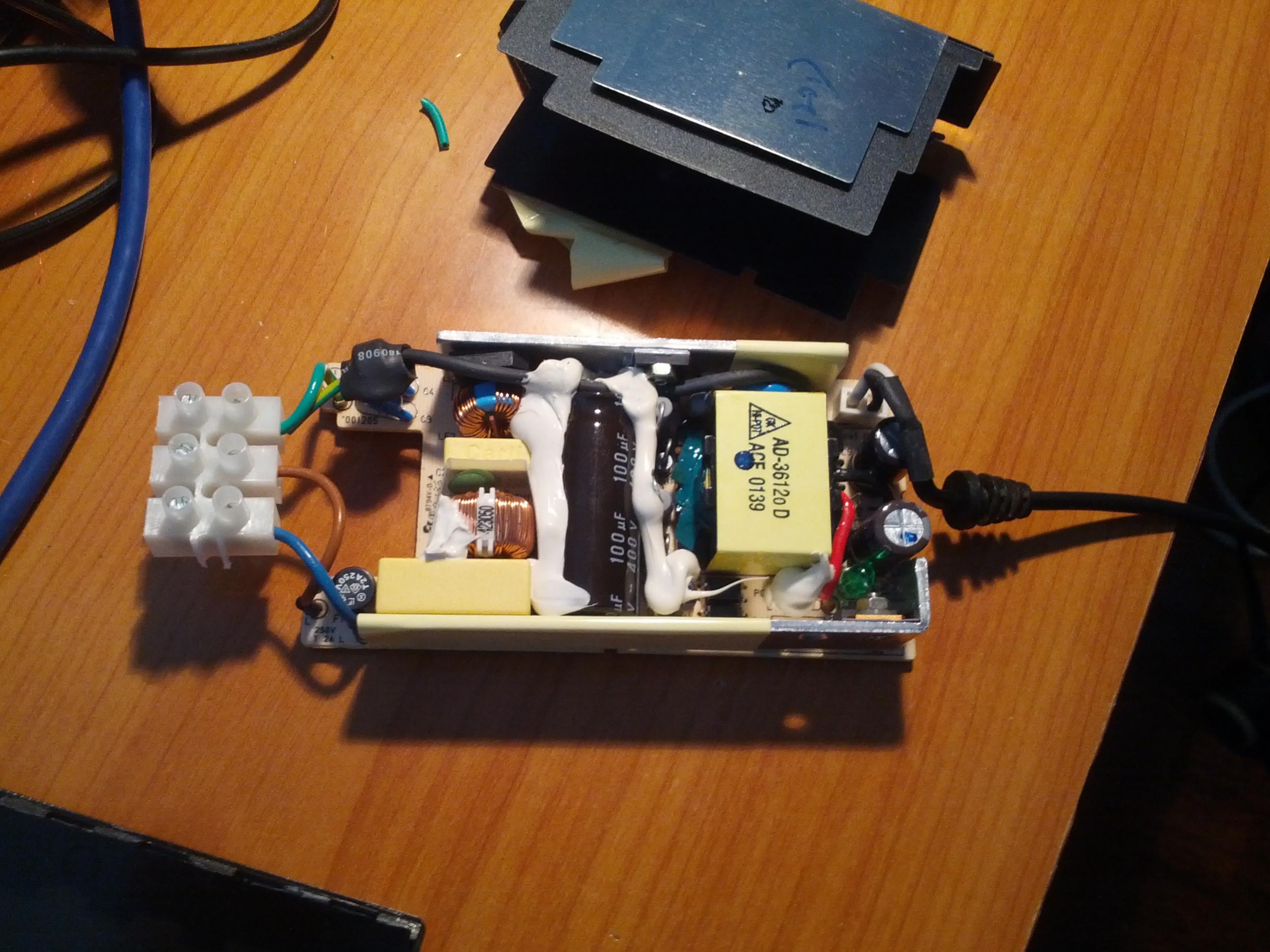

Hi and thanks again for the always helpful advice.
It sounds to me as a matter of try and see. I was thinking to start with 1000uF and see. Nice to hear that usually smps have a current sensing circuit.

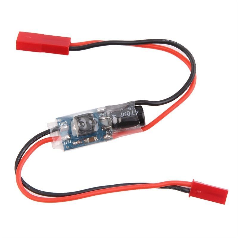

And also I saw on internet some "devices" to be used after a smps in order to suppress the noise.
Maybe I am getting it completely wrong but on principle any noise can be filtered.
So given the excellent convenience of these smps bricks the idea of filtering the residual noise is very very intriguing.

I see. So you are definitely against the idea ...

Some of the filters for smps above mentioned promise to be very effective by the way.

Gino,
Make a simple traditional linear PSU with 10.000uF in an external box. Use a 1A input filter (Schaffner). Use just about any transformer that gives you about the voltage you need. Run the unregulated DC up to your DAC. Put a LM317 regulator in the DAC with 10uF filter on the input and 1000uF on the output. Use a 47uF filter on the adjust pin on the LM317.
That simple solution is all you need and nothing else will improve things further.
I assume there are more regulators on the DAC board that in the end will be the limiting factor.
And please. Forget about the PC power supply for you audio equipment. Why send 100kHz noise to your DAC??

Could something like this work for instance ?
High Quality Power Supply Filter with Switch FPV LC Filter for RC Quadcopter | eBay
But if you recommend me any L and C parts I could assemble one myself.
The higher voltage smps to compensate for any voltage drop across the filter.

Ginetto 61, I'll show you photos and the circuit of the PSU.
Greetings.
The circuit is known (TNT Solidphono).
Greetings.
