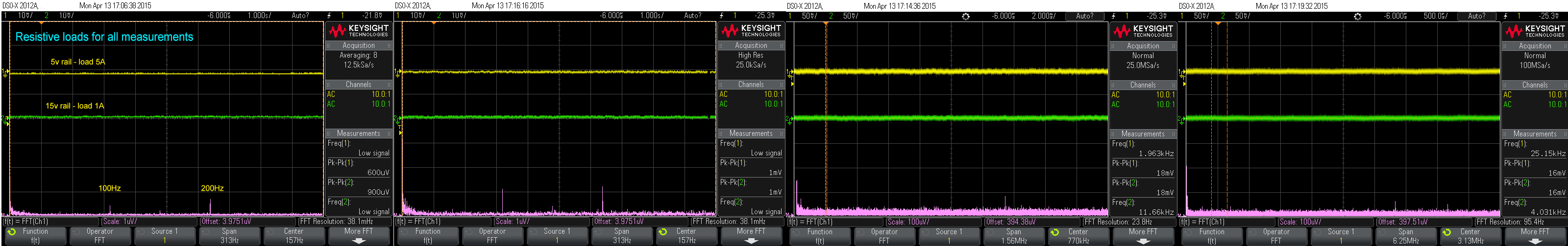

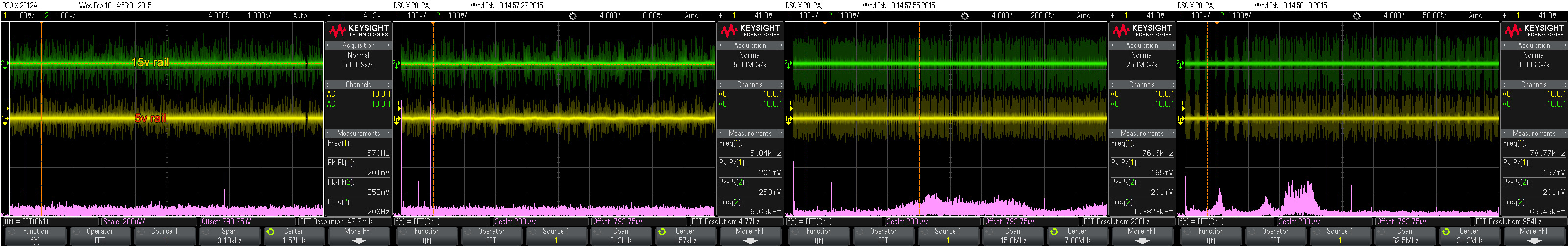

My question is .. is there an instrumental way to assess this ?
i am only able to perform these noise floor graph, for now
I think that they can be useful to spot some issues.
Honestly i have to say that some bad cases aside the results are quite similar. No big variation at least for the noise floor.
Mine is more a question of principle. I see many graph of noise floors and they are usually very flat. That is what i like. A floor must be flat.

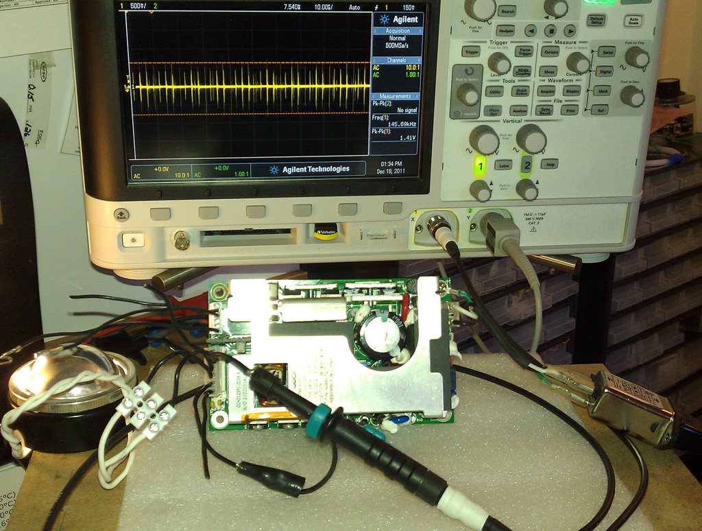

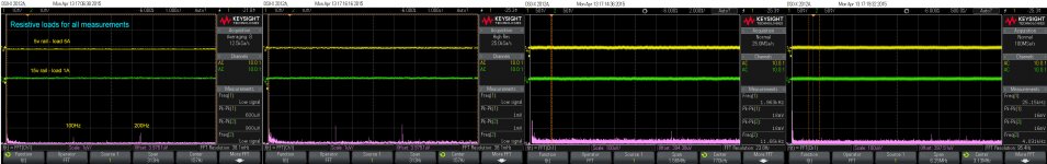

I would like to show here (I`m sure you know also these things very well...), how it looks the outputs of two power rails of a linear PSU and a SMPS one (as primary/main PSUs). This power rails are to provide power further to another small SMPS for digital stage, as power for linear regulators into the system... The conclusion is enough clear, I suppose...
It not matter at all in case of a primary PSU if its outputted noise it is in the audio domain, or not. It is mainly about the amount of overall noise level, and the huge spread spectre of such noise in case of SMPS. And is about a main PSU, to power a complex (digital/analogue) system.
And another exemple: Here is the original SMPS used by Agilent in the scope I own. Can you imagine? A measurement device, powered by a such power supply, with 1,4Vpp noise level... That SMPS is loaded under measurement, for the same current as the device it used. After this scope it got a linear power supply, its overall noise level it decreased dramatically...

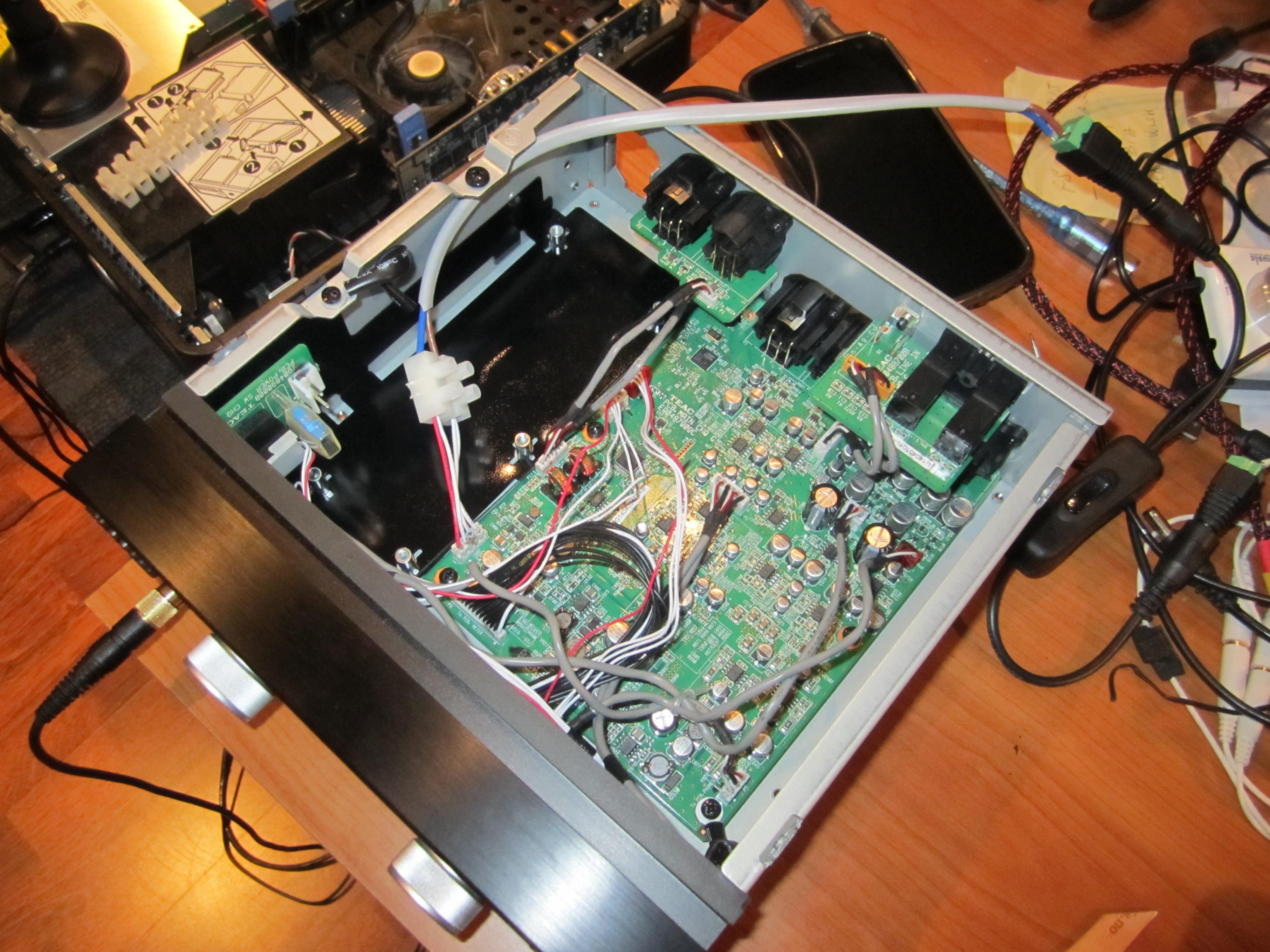

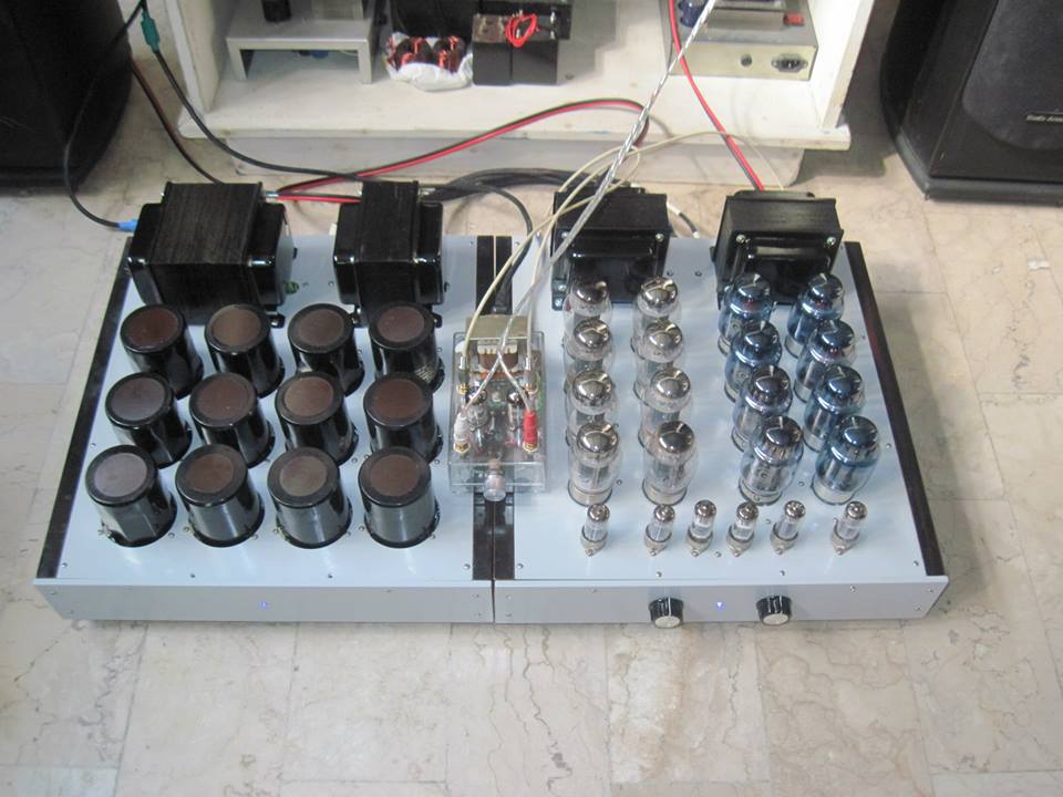

I am attaching a picture of the unit. The idea is to place a proper dc socket on the back panel to free to try any 12VDC around without having to worry with sizes.
Actually this is the most tricky part for me.
I will report asa i will have something to report.
During the weekend i should have all the pieces to build something. Linear of course 😱
Kind regards, gino

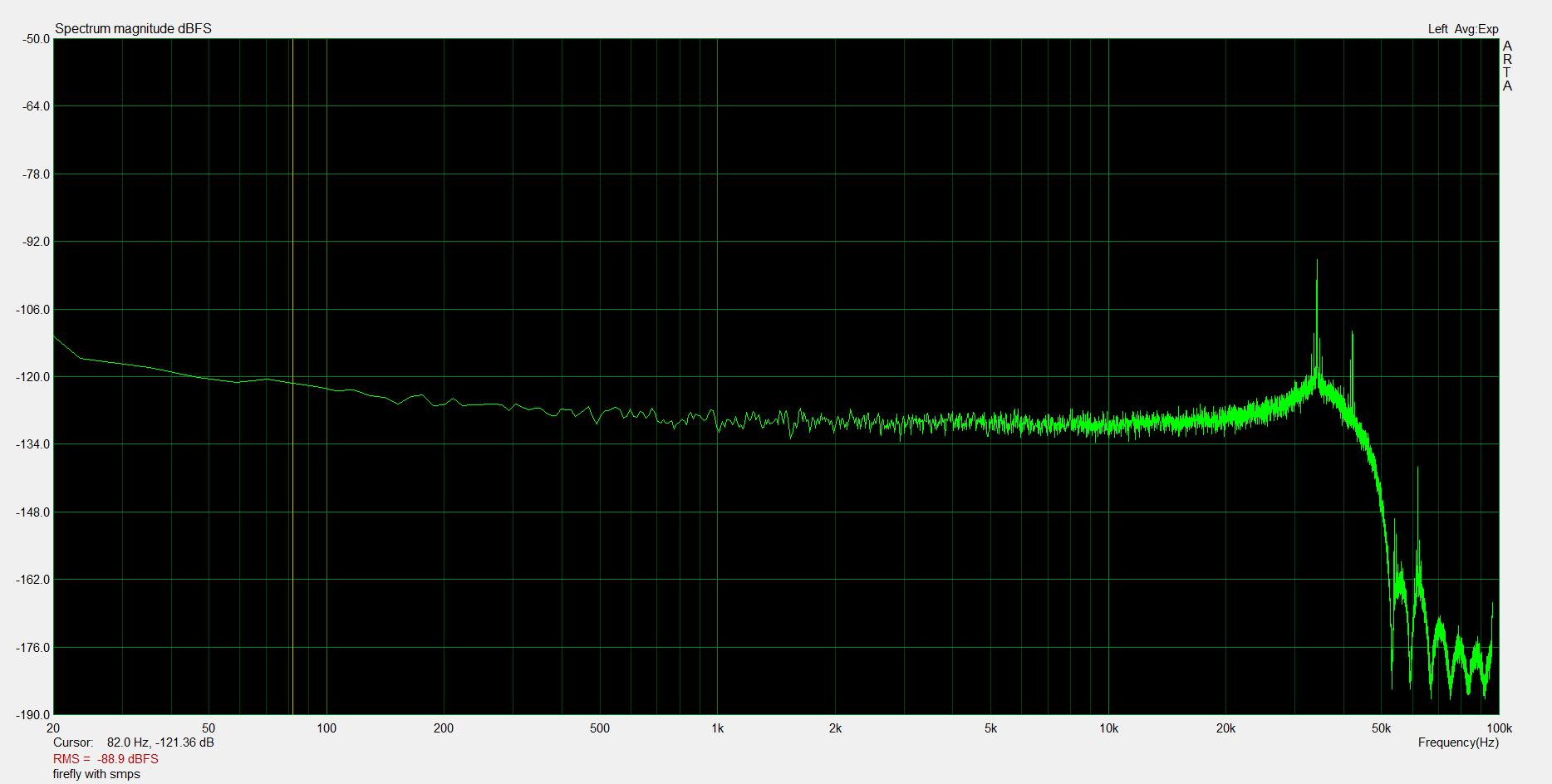

Hi ! thanks a lot again.
This is what makes me drooling 🙂
But let me ask you a trivial question.
I can see on my pc the resulting noise floor spectrum of the soundcard up to 96kHz.
This card has DC to DC converters on board, a very common solution I understand for this type of devices.
I have to test still linear psu. I have tried only smps for now.
But if I will see the same noise floor swapping between a smps and a linear one can I be confident about the good sound from both ?
or maybe the noise above 96kHz, that I cannot see, it is what makes the difference in favor of the linear psu ?
Or there is something that the instruments cannot see ?

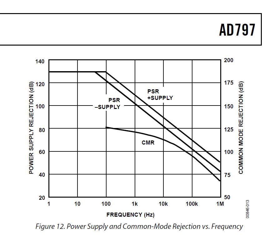

I think that a very important factor is also the PSRR of the circuit that the power supply powers.
For instance some op-amps have PSRR of even more than 100 dB 😱
This means that almost any psu noise will be suppressed to minimal level.
The problem maybe is how this PSRR changes with Hz ?
I am attaching the values for the AD797.
So even if a power supply is more noisy than another the end result can be very similar because the higher noise will be suppressed by the PSRR of the circuit ?
Well, what it is really happen when using a serial/linear PSU on a digital stage of a device is quite interesting, and for sure it have to be analysed more in deep. I didn`t do it myself yet...
What I observed so far is that the quiet linear PSU (with a very low noise on its output resistive loaded), when is connected (as a primary/raw power source) to a digital stage, it become enough noisy... This is quite normal, as the digital system is a very noisy one by nature, and a large spectre HF noises are spread everywhere through ground, power rails, and as EMi emissions. Even thought, the improvements for that digital stage performances, and for the final results produced by that system, are dramatic and obvious at once. My explanation so far is that the linear PSU it may lower somehow the overall noise level into the system, or change its spectre domain, so to produce improvements on either processing or the signals quality. While using a SMPS to power the same system, the increasing of overall noise level into the system, as enlarger its HF spectre and complexity, it looks enough normal to me. The SMPS it contribute with its huge high level noise domain to that of the digital system itself. Maybe someone else may explain better what really happen, but the fact is: a linear PSU powering a digital stage it produce improvements.
Indeed, there is not possible to see just everything on measurement instruments, and to see enough much it mean huge research efforts, lot of dedicated time, and so on. Maybe years of investigations... Personally i prefer more immediate results, and if I get what I expect, then my interest to explain more about one or another, it may decrease quite much, and fast...
I was myself very sceptical to use a linear PSU to power a digital system, as I knew (and it was also confirmed to me) that the noisy digital system it will spoil the quietness of a linear PSU, and such approach is very low effective, it produce lot of heat, and so on. After testing it myself, I experienced the improvements, and so I changed my scepticisme...
Such powering approach it is not possible always, and at least SMPS it have its functional well defined functional domain, as a powering method.
There is quite old the idea to power a entire computer from a serial PSU, to improve its overall performances or for some stages of it. It are also some trials in this directions. In my opinion, this is just not possible (when about usual computer systems), but it may works fine for small (low energy) computer systems. I haven`t get so far yet in my experiments, but I did it for my sound card installed in a SMPS powered computer. I changed the whole power system for my sound card (to a linear one), improving it, and isolate it completely form the rest of the computer. The result is was/is above all expectations...
So, my conclusion and advice is to use such linear powering approach rationally, making a good compromise between system efficiency, available space, the application to be fit it to, and so on...
My experience differs greatly from yours regarding power supplies, again this is all tailored towards SMPSs being bad which is not the case....
Well, I do not doubt at all your experience, but you may admit that these two powering concepts are radically different, when about the quality of their outputs (especially when about noise generation), as their use in hifi fields. We may agree that the linear PSU come much better out of such comparative...
However, this subject it seems to me to be an enough endless discussion...🙂
If you may show a so clear scope line on an SMSP output, as we can see on a linear PSU, then I will not say anything anymore...
Well, what it is really happen when using a serial/linear PSU on a digital stage of a device is quite interesting, and for sure it have to be analysed more in deep ....
Hi and thanks again for the very helpful advice.
From now on I will be experimenting different linear power solutions for sure.
As I said changing smps has not has a big of an impact, stock one aside (why they did not care about that issue I do not understand really).
I will test first the psu outside the box and then I will try to place the regulation stage inside and keep the transformer outside.
I have the feeling that this card as a huge potential indeed as AD and DA converter.
Actually I bought it especially to use it as sub to AES interface as I have another AD/DA converter of which I like the sound.
If the result will be positive I could use a linear psu also with that converter
Thanks a lot again, gino

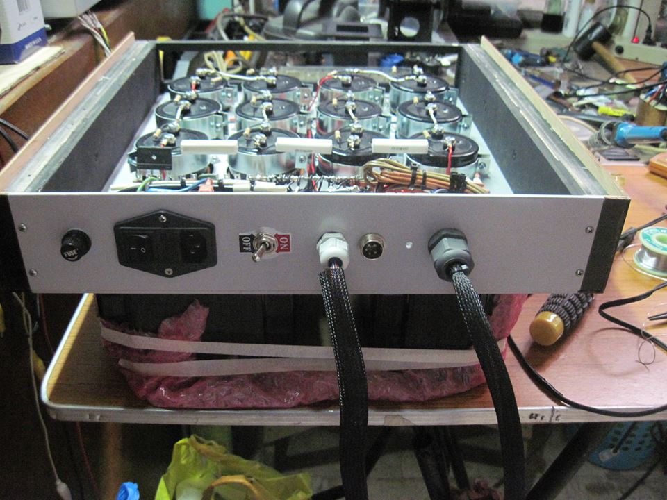

this is the amp i build several years ago....
psu on one chassis and the power amp on another, the two are joined using umbilical chords,
Hi ! very impressive indeed ! great project.
I guess that there is DC going through the umbilical ?
I tend to prefer the AC option, placing reservoir caps as close as possible to the final stages to avoid any lag in the current delivery ?
I read about that concept somewhere but I do not remember where.
Smaller and fast caps close to the output devices ... I like the idea.
Transformers are bad animals. Heavy, vibrating, EMI generators ... better to keep them away from circuits. I would do that with my amp if I had the time. Just extract the transformer and put it in a separate cage.
In this way there will be more space inside the amp for better and bigger caps.
Thanks a lot, gino

thanks, no way i could have done it on a single chassis...
there are two umbilicals one for dc and the other for ac...
