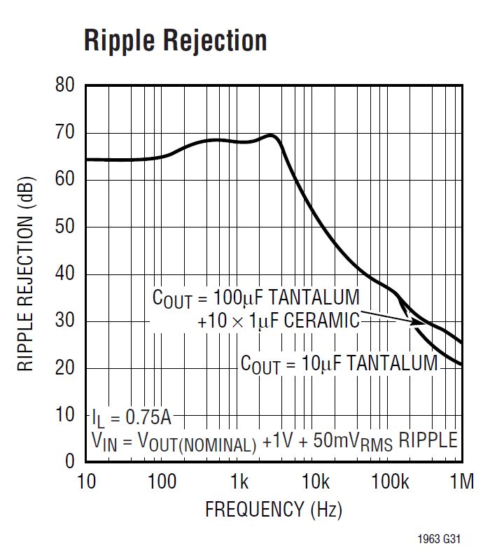

For instance I have found a very interesting video on youtube by Linear.
https://www.youtube.com/watch?v=WxhjLIu-vPg
The designer suggests to place ferrite beads both before and after the regulator to suppress high Hz noise (listen at 2:40)
I wonder if to place one small bead directly on the input pin and another on the output pin of the regulator chip could
actually improve PSRR at higher Hz where, like the designer says, the linear regulators have lower PSRR
(without creating negative side effects of course like magnetic noise or such ... ).
This is a very easy thing to test by the way.

You may not mix switching regulators with linear regulators...
A main linear power supply, or a linear regulator may not need any ferrite bad, but good capacitive filtering. Such components are used also in advanced DC power rails filtering for some local sensitive stages of a device, or to prevent side HF noise (from oscillators, RF processing circuits) to be spread into the rest of the circuits around.
P.S. I live in Norway indeed. Also into Stavanger area...

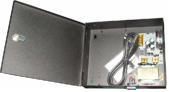

Again what convinced me to go for EI type is what I saw used in control panels power supplies ...
and also lab linear supplies ...
I have ordered an isolation EI type.
So it will provide also isolation from the mains.
