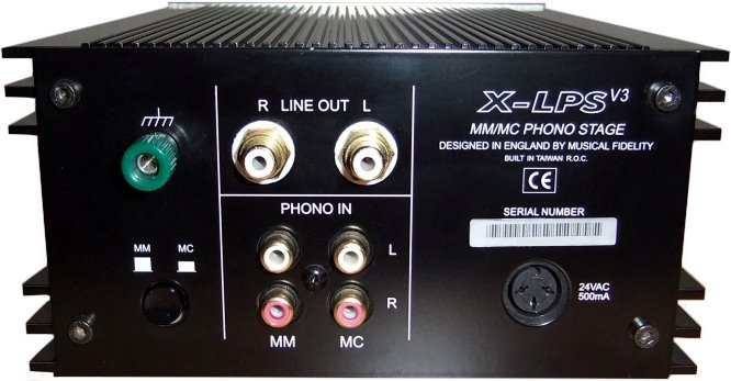

Hi and let me elaborate.
Look for instance here on the low right side ...
24VAC/500mA ... bad design ? this is my fundamental question
Of good 24VDC regulated power supply is full the world, and nevertheless they have decided to go with only an external transformer.
Someone advised me that is better to keep the rectifier very close to the transformer.
So is Musical Fidelity wrong ? and it is not alone
I am sure that an external transformer is absolutely better ... i am sure
Like i am sure that especially for circuits operating in class AB where the current draw is rapidly changing like power amps the closer the reservoir caps to the output stages the better
Instead of big caps far away and small caps close i would do the viceversa.
But to be honest in the end i have seen example of both AC and Dc umbilicals
Thanks again, gino

Hi !
yes. I have recurrent obsessions 😱
But I have decided for the DC umbilical connection between the external power supply and the device, a usb soundcard with 12VDC socket.
Mainly because I do not want to mess too much with the internals.
I should place a regulator and I am not that good at installing things in tight spaces.
Moreover 12VDC power supplies are quite available (I could build something in the next future anyway).
I have opened a similar unit and I can see a 2200 uF cap just after the DC socket 🙄
My guess is that it is acting like a local energy reservoir placed closer to the circuit board ?
I have a question about the max size of this cap. I think that the bigger the better.
But if it is too big it could be seen like a short circuit by the power supply ?
Could 2200 uF be an optimum then ?

'The bigger the better' is sometimes true in engineering. Often it is not true.
There is not a simple answer to your question. You need to consider things like how the PSU behaves when it sees a (temporary) short, what the resistance and inductance of the cable will be, what your aim is. In other words, you need to design your circuit.
'The bigger the better' is sometimes true in engineering. Often it is not true. There is not a simple answer to your question. You need to consider things like how the PSU behaves when it sees a (temporary) short, what the resistance and inductance of the cable will be, what your aim is.

Hi ! thank you very much indeed for your valuable advice.
From my last post there has been an evolution.
I will keep the mains transformer out of the box and put the voltage regulator board in the case as close as possible to the dac.
I have a feeling that an AC umbilical is a better solution than a DC one.
So the situation has changed.
The transformer is likely to be a EI type, or maybe a R-core.
But i am attracted by EI types after seeing them used commonly in control units and lab power supplies.
There must be a reason why i do not see toroidals.
So the real issue now, still open, is the regulator solution.
If you may use Schottky as rectifiers, which are specified for enough high continuous current, then these devices it may tolerate hundreds amps as pick currents... At least the best and safe current limiter (for inrush picks) is the transformer itself. Your power system it can never take a larger current (both picks or continuous) than the transformer it can deliver (without burning...). Some experimenting and done!
Thanks a lot for the useful directions.
My goal now is to select a kit, assembled or not, and maybe replace some parts with higher quality ones, like the Schottky diodes you mention or better caps, in order to enhance its performance as much as possible.
But I really would like to start from a kit or at least a ready pcb.
I need 12VDC/1A at the output of the regulator (actually the dac's current draw is about 0.55 A at 12VDC).
As i said in the end i prefer the AC umbilical solution.
I like to keep the transformer out like i see in some preamps.
If you have any suggestion for a very good regulator kit i am all ears.
It is my main and only interest now.

Hi Gino
Indeed, an AC ombilical is a very right approach in your case, and is at least better to have the transformer out of the DAC box. More confortable/convenient is to have it all in the same box. However, if I may chose myself, I will chose to place the transformer as long as possible far from the rest of the DAC circuits/PCB, but not necessary out of the same box. If outside the DAC box, then is no problem to have it just beside. Few teens cm longer AC connection, it mean really nothing. However, I will prefer an no center tap approach... As your load is a so low current, and stable, as a preamp or DAC or whatever in this range it can be, then is no whatsoever problem with a longer AC connection. And yes, there is preferable a AC power connection, than a DC one.
A quite different situation (AC ombilical) it may be when about a (high) power amp, or even a power supply for a welding device...
