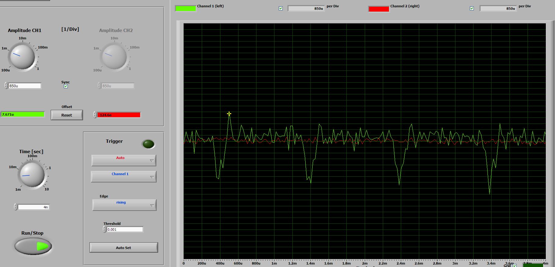

This is a question regarding the kit from nuova elettronica. I tried to use the signal generator, now as soon as I connect the scope probe (the VA scope that is) to the output I see 1KHz and it's harmonics at about -70dB. This is without turning on the signal generator. Now when I try to output a wave, let's say 440Hz + it's 12 harmonics at -40dB to about -80dB at higher freq. What I see is that near each harmonic I also get a sinus 100Hz lower and 100Hz higher. For example near 440Hz I can see 340Hz and 540Hz and this goes on with the rest of the harmonics and they are in about the same level as the harmonics. This makes the usage of this feature impossible. Does anyone noticed something like this before?

Here is a small update... I checked the kit with VA on a laptop computer running from a battery (power adapter disconnected) and I could see the exact same noise at the same level without adjusting anything on VA or the windows sound card settings.
So it could still be VA or it could still be the NE kit interface. Does the interface come up in My Computer as a sound card? If you loaded another generator/FFT package can you tell it to use the kit? Try the package at Soundcard Scope. You specify which input and output device to use in the Settings tab. Use it to generate the signal and to do FFT on it and see if the mystery sidebands are also there.

So I downloaded what was suggested and installed on one of my computers. I connected the scope kit and it is recognized as a normal USB sound card. I loaded the scope program and the second i connected the scope probe to the wave generator output... well, you can see. I think this means the kit is the source of the noise, perhaps the wave generator part specifically.

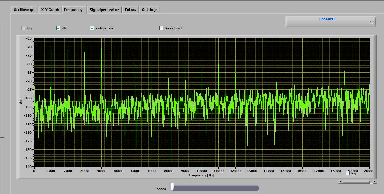

Now, wait just a minute! That's an extraordinary amount of harmonic activity for a sine wave. What happens if you now switch to the oscilloscope panel and view the waveform. Is it clipped or otherwise mangled? Can you post a screen grab?
Hmmm, your version of Scope is a bit different to mine. Mine doesn't have the dB box. What version is that?

Terry, no one said that the noise is a sine wave 🙂
It happened to be that the custom wave I was generating using VA was a series of sines which was important because otherwise it could have been harmonics generated by my wave and not another source. This is way too much harmonic content for a sine, I agree. Even if it was a little bit clipped I would expect to see a small amount of 2nd maybe 3rd harmonic but not more and not this much!
The version is 1.4 from the link you've posted. Included is a screen capt., this is about as good of a picture I can get of it.
Ah, silly me. So, the nasty 1kHz signal appears to be emanating from the NE kit card. What frequency does the DC-to-DC converter (transistors Tr1 and Tr2, T1) run at?

Just a bit under 65KHz.
I managed to get an answer from NE regarding support, they promised that someone is going to call me tomorrow. The idea of asking for a refund was a good one! Thanks!
Yeah, I thought it was likely to be high rather than low. There's nothing else in the schematic that should be singing (unless your schematic is different to the one published in the article). Apart from the crystal oscillator in the big chip, but surely that has to be high. (The parts list in the article doesn't mention the xtal 1 frequency, but 1KHz would be a very big crystal!) And 1kHz is very low for a spurious oscillation. Very strange.

That's pretty weird, space-cake! The errata document cited suggests "Only the ”0A” (16 kHz, 16 bits, Mono mode) setting creates the noise problem." But that's hardly the setting used in the VA application? Surely VA would opt for the widest bandwidth, greatest bit number, stereo setting?
But against that, what is the probability that they found exactly the same problem you found? Is the problem perhaps more widespread than they think?
But then, going on from there, installing a filter? Does that suggest that the codec will filter out all 1KHz signals? That wouldn't be handy!
