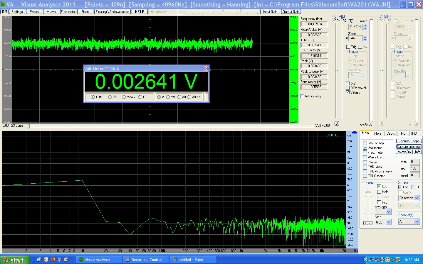

In response to the noise problem Spacecake was having, attached is a screenshot of VA 2011 (not beta) running XP x32 with a low-end, unshielded soundcard. There is nothing plugged into the mic input.
I also tried the beta version which appears to run uover the .NET framework and have found it buggy. I also tried the lone, executable on Linux through Wine..also buggy as expected.

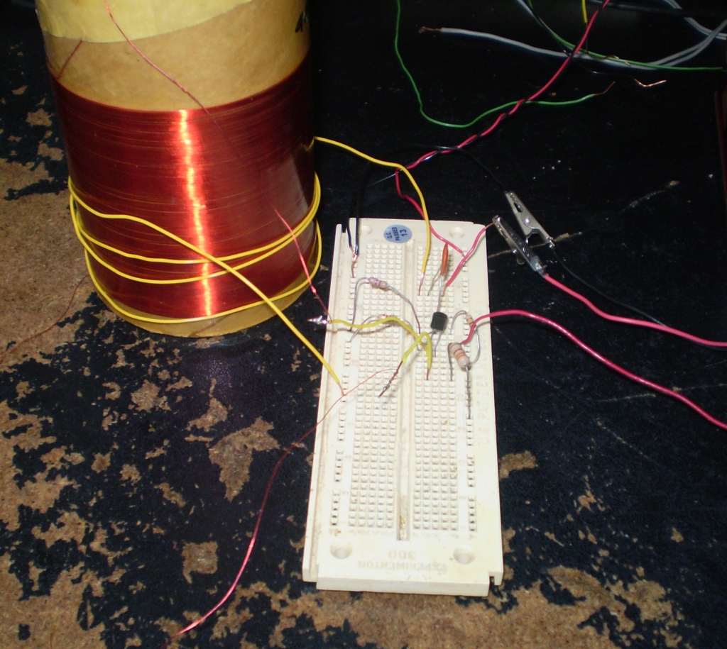

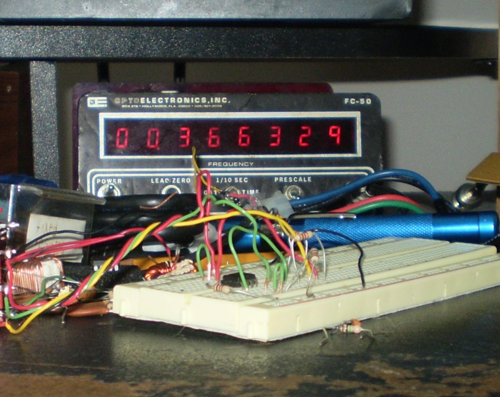

I just finished my little test using a armstrong oscillator made out of a BC547 NPN bipolar transistor.
I used the armstrong oscillator circuit to keep any extra parasitic capacitance's at a minimum.
I must say that I am pretty Awed so far with the accuracy of the measurements that were made by VA !!!
I am just guessing better than .1% to .01% or much much better.

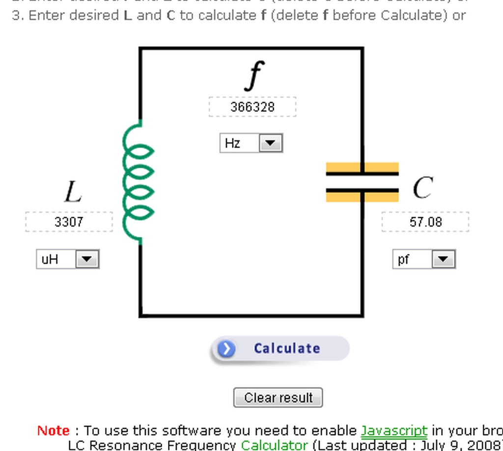

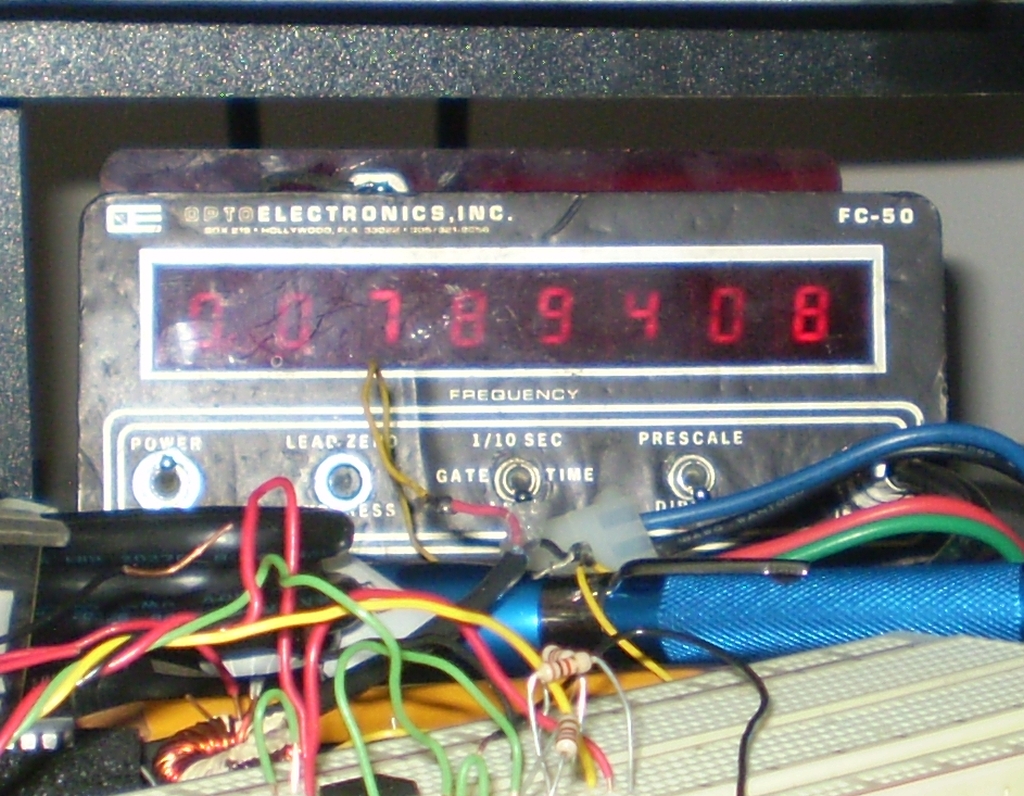

The frequency's with my home made coil of 3305uh ( as measured with VA) were spot on using values of capacitors that where also checked with VA.
With no added capacitance my stray capacitance of my coil and oscillator circuit showed to be about 15pf to 16.5 at 710.1Khz.
Adding in more to the tank cricuit the frequency was spot on within a few 100HZ and no more than 300HZ maximum of error at 256.4Khz with a added 100.5pf and 188.5Khz with a 220pf capacitor that VA said it was about 200 to 205pf or so.
This is including any drift that was occurring as well.
I am completely amazed at this and is a revelation to my bench.
Now I can actually do something more advanced than what I have been doing, now that I have a precise measuring tool instead of sitting here studying the theory as I have been doing the last 35 years!!!
Cheers !!!!
jer 🙂

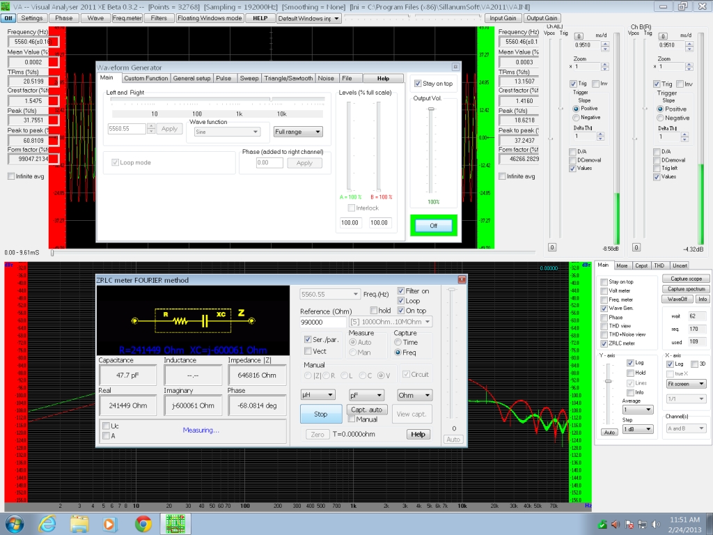

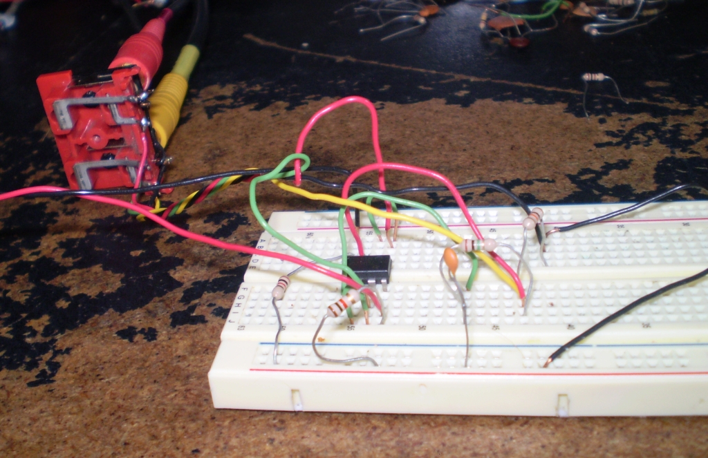

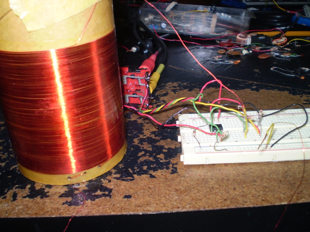

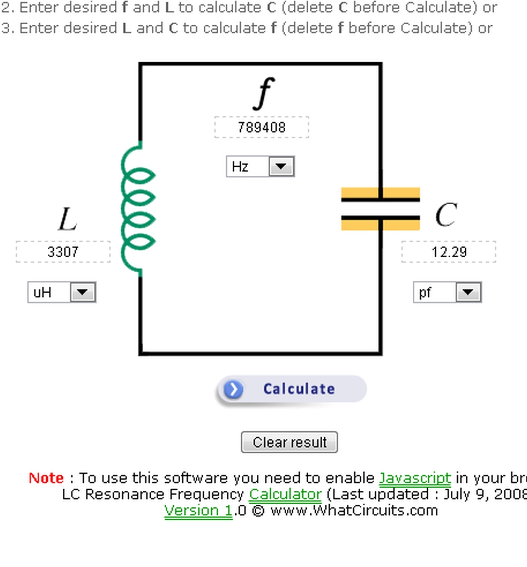

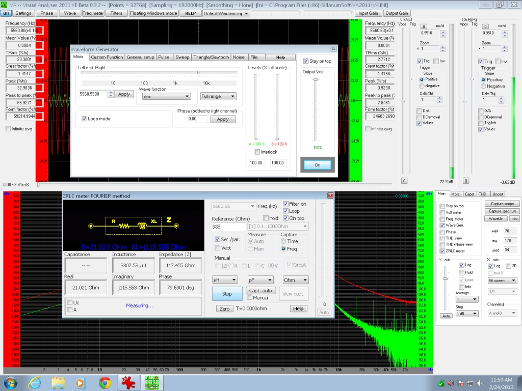

Yes, that was the whole point of building the oscillator and that was to check its values.
My coil is a home made coil that I made some years ago.
At first I tried my transformer jig setup because I was using a power amplifier to drive my DUT.
This worked okay for large values but it did not work for the smaller finer values or my home made coil.
So, I removed the resistor dividers and power amplifier and powered the DUT straight from the output of the sound system.
I still used the unity gain buffers to drive the inputs as this isolates the sound systems input impedance from the results of the test.
I am using a TL082 for the buffer.
Here are some pictures of my setup and screenshots of the test I just did this very second.
The repeatability is excellent at 3307uh, with only a 2uh difference from my first test early this morning of 3305uh.
The capacitor was right on and the parasitic capacitance of my oscillator did change by 5pf from moving things around.
This is reflected in the calculations as well.
It worked pretty good for me perhaps you can show us the details of your interface and maybe be able to figure out the cause of your errors.
I used a 1k and a 100 ohm resistor for the inductor test at different frequency's and they all returned the same results.
I then used a 1 megohm resistor for very low capacitance values.
Last night my 3pf disc read 2.7 to 3.2 pf and today it read 4.2.
But I will let this slide as nothing is in a box to shield it from stray capacitance's.
The more exact you have your reference resistor value the better the accuracy the results will be.
I failed to do that this time with the 3pf ceramic disc capacitor, But I did it for this test using the 47pf capacitor.
I will be trying many many more samples to make sure that every thing is working properly as well.
Enjoy!!!
Enjoy!!!

Repeating the earlier tests without paying attention to the Reference resistor the values were still within range by by .4% to 1.5% depending on what resistor I happened to grab out of the pile.
Actually my coil is now reading to be 3372uh instead of 3307 of earlier tests.
I don't know why this is but it is only a 2% difference.
I can say that it is better than no percent of any value at all !!! He,he,he,he
Any how I will keep checking and see if I find an error from my earlier setup as I have moved things around again.
~update!!~ I just found out the difference was caused by anti-phase of the of the 3 turn tickler coil.
With this coil connected in series and and out of phase to the tester my value is now exactly 3306uh as it was before. ~
When it is working it shows shows the actual DC resistance values to 1/1000's of an ohm depending on the range.
