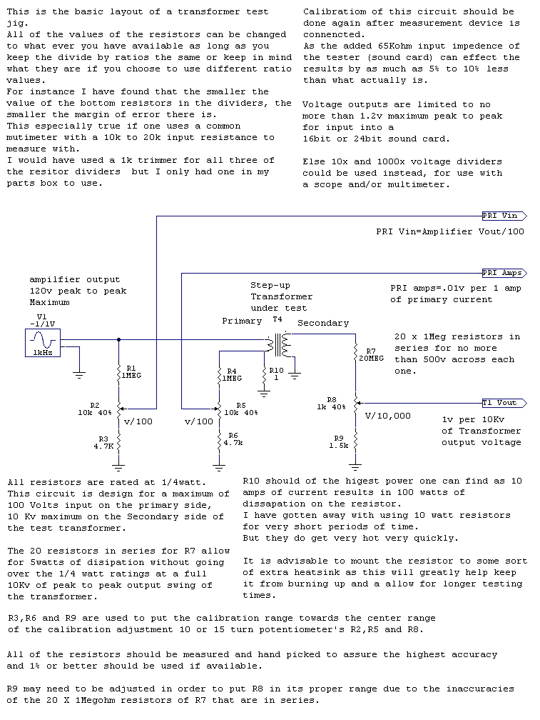

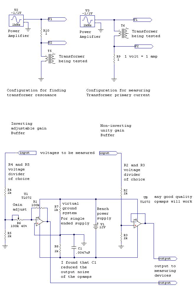

Use a unity gain buffer on the input of your sound card.
Some if not all sound cards impedance varies with the input frequency and this can cause false reading especially if you are using a resistor divider between your probe and the input to the card.
I show such an interface here that I use to measure high voltages from step-up transformers and amplifier outputs as well,
A TEST JIG FOR FINDING ESL STEP-UP TRANSFORMER PARAMETERS
Below I have posted the schematics from that thread.
You can omit the dividers if you wish as long as the A.C. content of the signal is below about 1v to 2v peak and the D.C. voltage is within range of your opamps.
Your sound card will be already DC blocked by its internal DC blocking capacitor.
Some opamps are not unity gain stable in non-inverting configurations as well and may cause issues as I have had this problem occasionally.
I plan on revising this circuit with something like the LT1007 which is a high speed precision opamp and it is unity gain stable in non-inverting mode.
I used this same technique in my regulated HV supply as well here,
http://www.diyaudio.com/forums/plan...tor-insulation-mylar-coating.html#post2848194
This same technique can be found here in its simplest form without the divider resistors,
http://wb6dhw.com/RLC_Meter/RLC_Meter-sch.pdf
This is the link to the original website,
WB6DHW
I have used this interface a lot and with great success and I have found it is necessary to use the due to the fore-mentioned issues.
In this thread I show how well VA does with very low level signal buried in the noise floor compared to my scope and it basically puts the scope to shame in the particular test!!!!
http://www.esldiy.com/index.php?topic=176.msg310#msg310

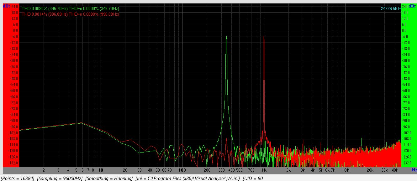

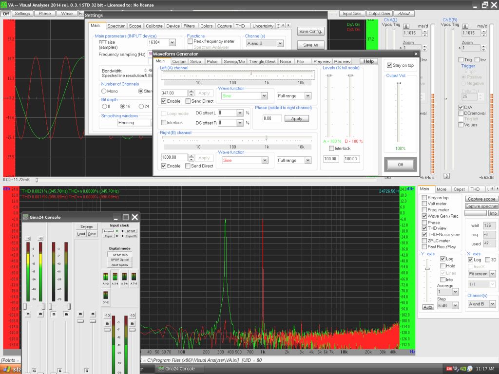

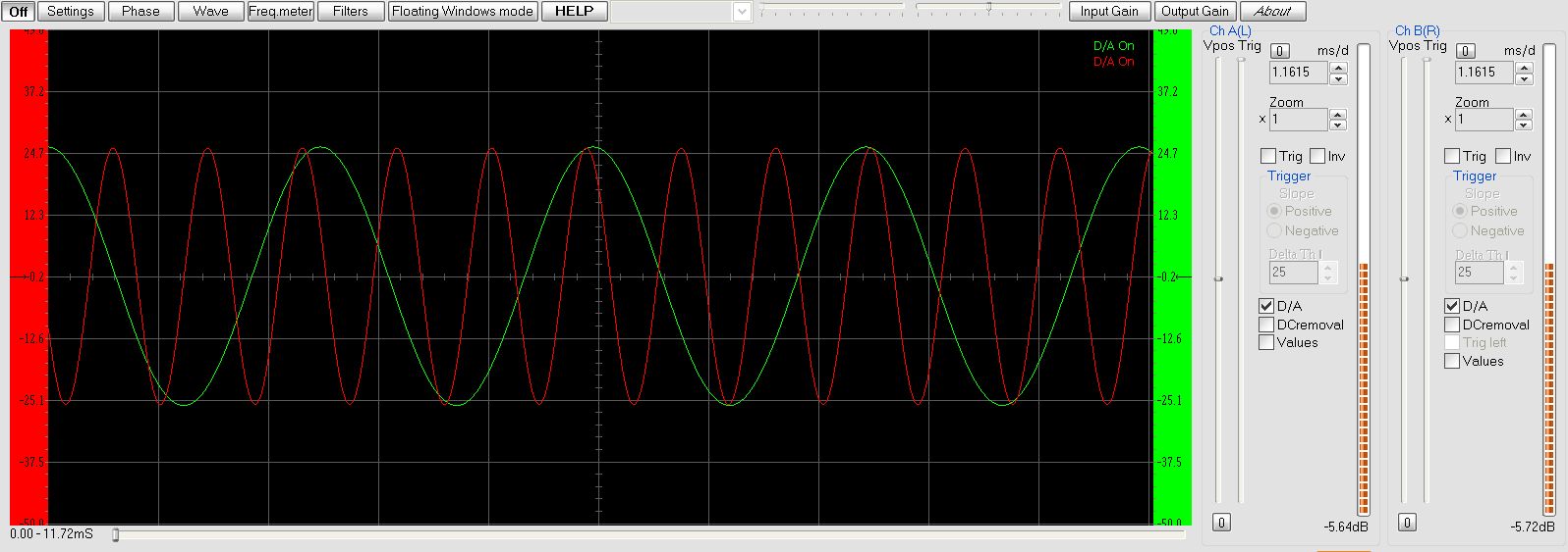

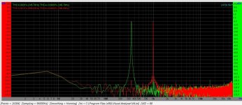

I just gave VA 4.2 2012 Beta a small test run and it seems to work much more smoothly than earlier versions.
I didn't give it a full test with tones yet, as I will do this later.
However, I could only get it to work in Win7. 🙁
I don't have any sound cards that will work in Win7 at this time except for what is on the motherboard.
I figured that I would give it a quick try before I wiped out my Win7 drive as I have switched every thing back to XP64 at the moment because I am tired of incompatibility issues I have with my older hardware and Multiplicity.
I guess I will have figure out a multi-boot system as I use linux as well and I have done it before, but it is a PIA to do sometimes.
Anyhow I did get VA4.2 2012 beta to lock up under one condition and is probably expected by doing a calibrate function using 0v and no signal was applied only using the noise floor of the onboard sound system.
Also I didn't have anything plugged into the input jack so they were probably shut off, as it does this in Win7, and is what could have caused it to get lost and lock up.
Let alone trying to calibrate to Zero.
I will give this another full test once I get my machine reconfigured with a Multiboot of the Three OS's that I normally use.
It sucks having to keep Win7 around as I just don't like it!!!
But this is not the only program I have run into with this problem of only working in Win7 these days. 🙁

OMG!!
I just tried out the latest VA2014 and so far it looks really good!!!
It still doesn't pick up data from my Gina24 sound card in 24 bit mode but at least it doesn't crash when I set it to it.
Sometimes it will stop when switching modes but it does recover easily.
Here are some screen shots of a simple un-calibrated loopback test, The abnormal Green FFT trace may be due to a crappy cable.
I can't wait to start putting this new version through its paces!!!
You can find it here,
Download
Nice Job, and, Cheers to the developer!!!! 😉
jer 🙂
P.S. You have to use the 32bit version if you are using XP64. 😉
