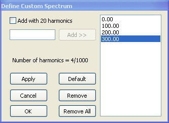

Conrad and Pano - I'm not sure how the topic of compensation curves came up, and I haven't got this far myself. But just to mention, on the Settings / Spectrum window, there are buttons marked Compensation and Custom Spectrum.
Compensation offers the standard A, B and C curves as well as the ability to invoke .cmp files.
Custom offers more capacity, including the ability to define musical presets, like flute and harpsichord. Now that has to interest a flute-maker and sometimes harpsichord-maker (like me), surely! Haven't a clue yet what it's about!

The flute and harpsichord were listed among others under Music Presets (tempered scale) in the Define Custom Spectrum window, available from the Spectrum tab of the Settings window. (How many layers does this onion go down?) As I say, I haven't yet investigated it.

We must have different version or I'm missing some parts. My define custom spectrum window has no musical presets.The flute and harpsichord were listed among others under Music Presets (tempered scale) in the Define Custom Spectrum window, available from the Spectrum tab of the Settings window.
