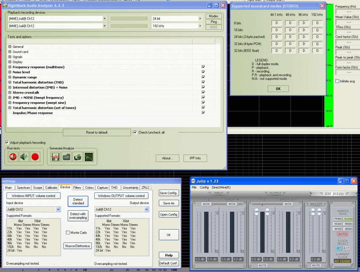

I'm using this nice piece of software since the days Pedja recommendet it.
However, one thing I never understood:
After having installed the decent ESI Juli@ Soundcard, which is able to do 192kHz/24bit in and out, VA, when detecting the device, tells me always that it's only capable of 96/24.
This goes for VA 2009, 2010, 2011 and 2012 Beta.
I'm running XP.
Does anyone of you have the same problem?

Zinsula: Perhaps 192K is not available. Here is an extract from one of Alfredo's papers:
The idea could be realized using low cost and ubiquitous hardware, for example a standard Windows-based PC and a sound card as data acquisition board. The only additional hardware could be a standard oscilloscope probe and a simple protection circuit to guard against excessive voltage. The newest soundcards with a 192 kHz sample rate will manage signals with frequencies up to 96 kHz (which is well beyond the audio frequencies).
@zinsula:
If your soundcard unable functioning full duplex mode (192K in, 192K out at the same time), then VA switching downward.
Thank you both.
Strangely, RMAA says that full duplex mode at 192/24 is supported.
See attached printscreen:
on top RMAA windows, bottom left VA settings window, bottom right Juli@ panel.
The Juli@ panel shows setting changes, when RMAA tries to detect supported modes.
Nothing happens, when VA does the detection. I can even set sample rate manually at any rate, the result is always the same.

I have pretty well the same experience using XP, an E-MU 0204 box via USB. Maybe this is just there for future development. E
I'm pretty sure I could do 192 with my EMU 0202 way back, but when I switched to newer drivers for Vista, 192 operation was lost. I haven't updated drivers in a long time.
