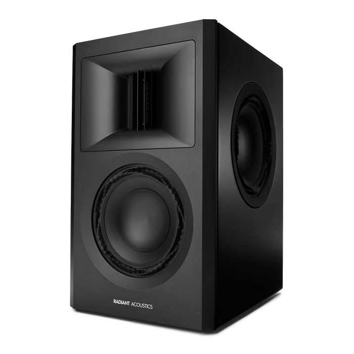

Purifi goes mass market = Radiant Acoustics
The international facing direct to consumer site:
https://radiantacoustics.com/
Model is called Clarity 6.2 offered at 3,998 euros pair including shipping. Or for europeans from the 150 HiFi Klubben retail stores.
At the level we like to deep dive on diyAudio this promotional video "Behind Radiant Acoustics: Clarity 6.2 | Innovative Technologies & Craftsmanship"
goes into both the technology and teamwork among Peter Lyngdorf's holdings that resulted in the Clarity 6.2.
I also enjoy Stjernholm Reviews YouTube reviews for the info and irreverent humor, here is part one of their review. "HIGH-END on the CHEAP! Radiant Acoustics Clarity 6.2 - FULL REVIEW! PART 1"
Also respect to Stjernholm Reviews for pushing devices under test until the drivers hit their stops, I wonder how many tweeters they loose?
For those of us who are long time followers of this diyAudio thread I can't help notice how the Clarity 6.2 size and configuration follows advice Lars Risbo – Co-Founder & CTO, PURIFI has shared here.

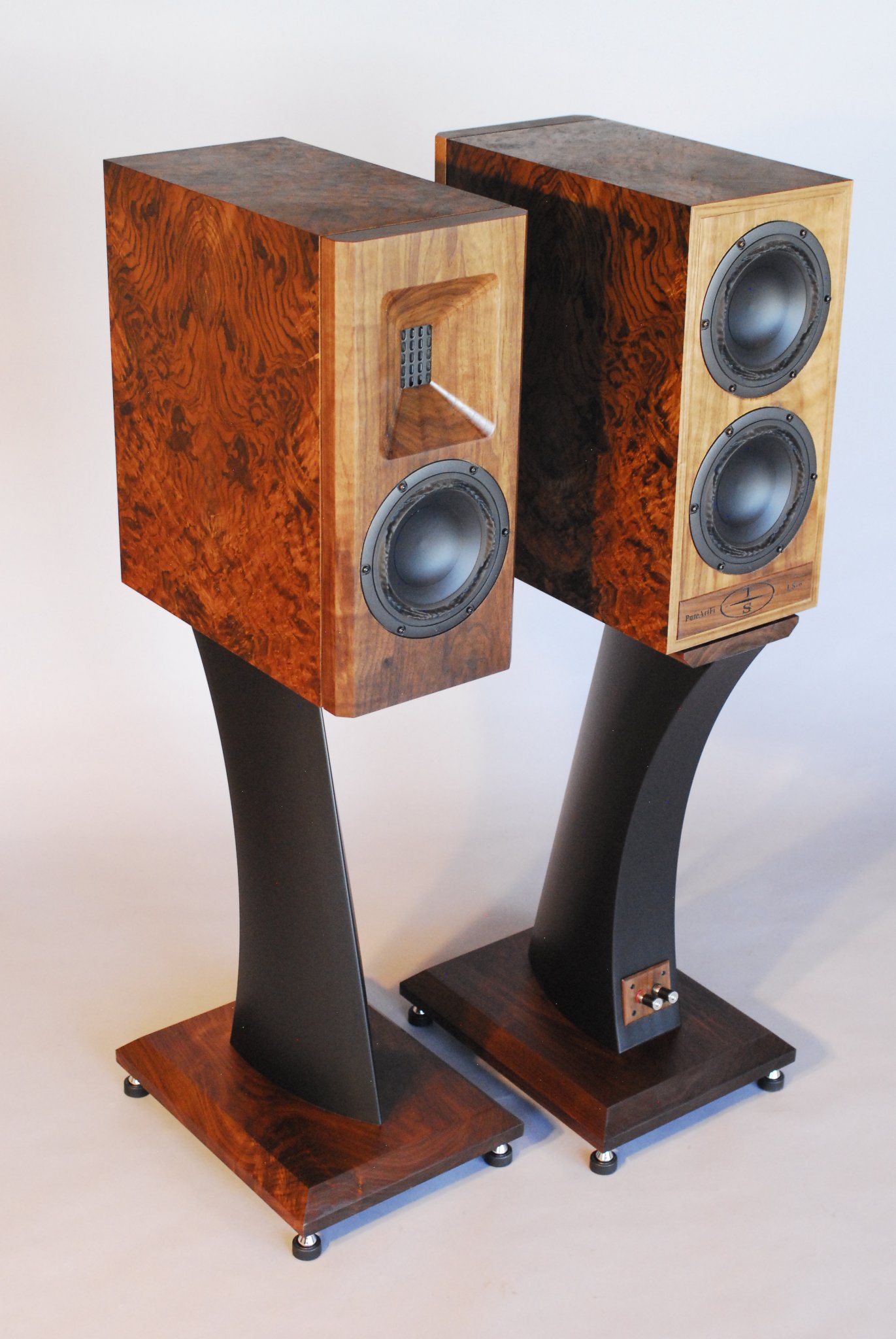

It is an interesting example of similar design goals leading to similar designs comparing the Clarify 6.2 to my design introduced in June 2023 as the PureArtFi LS-6. PureArtFi
Both use:
  • Paper cone PTT6.5 series woofer and pair of matching PRs.
  • Tweeter in horn/waveguide. Radiant an AMT, PureArtFi a planer type.
  • Squared off styling with baffle front edges chamfered.
Our PureArtFi LS-6 is considerably upmarket compared to the Clarity 6.2. PureArtFi featuring master craftsman built enclosures and stands in solid hardwoods and shop sawn veneers. Speaker designers here on diyAudio will spot the LS-6s' enclosures is considerably larger. Much of that volume is used for the interior features. Sub enclosures are used to pot and damp the crossovers, others hold compacted sand acting as loose mass dampers and a large rear chamber for tweeter. All the interior sub enclosures also act to divide interior space into complex non-parallel volumes.

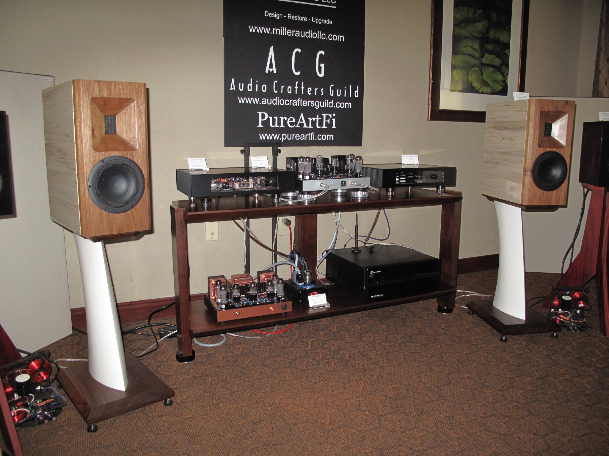

Hi Simon,
While the sensitivity of a typical Purifi woofer based speaker seems to point to high power amps I have a couple of experiences that lower power high quality power amps can work very well indeed.
First on the tube side at this years Lone Star Audio Fest my demo room used the Miller Audio Dyna-70 tube amp. The Dyna-70 is a new production version of the classic Dynaco 70, like that amp its rated 35 wpc. The Miller Audio version does have larger capacity power transformer and uses solid state diodes for B+. These are 'jumbo' tube watts. Playing into the PureArtFi LS-6 (PTT6.5 woofer & PRs) or other times the Audio Crafters Guild Pure 70 (PTT5.25 woofer & PRs) I was very pleased with the quantity and quality of sound produced.

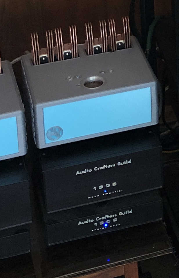

A second data point is I was lent by my friend Tony Crocker of Swan Song Audio his prototypes for a LiPoly battery packs powered mono blocks to try at home with the LS-6s. Tony lists the specs and features of these as:
Battery powered
  • 11 watts current limited
  • 4 gain levels. No volume control
  • Adjustable 1st stage transistor power supply for 1 watt and under listening
  • Melf resistors vs thick film
  • Resin and polymer tantalum caps
  • Hand matched transistors
  • Wattage meter
  • TFT display
  • Copper heat sinks
No way 11 watts should work but wow it was fine. The bass depth slam and quality set a new benchmark for the LS-6. My theory is this due to the extremely low source impedance (equals very fast current delivery into load) of the LiPoly based power supply. Tony charges the PiPoly packs in balanced parallel then for use switches them to highly noise filtered series connection. Every aspect of the circuit is fanatic design meets talent and experience. Beyond the new depth and detail in the bass everything passing thru the Swan Song amps had a sense of purity and transparency that was very special.
As seen in the closeup my usual amps are ACG 1000 series based on 500 wpc ICEpower modules. The blue 3D printed cases of the Swan Song amps placed on top for the loan.
Of course both of the lower power amps cannot play in the 90-100+ dB range my usual amps go. And at LSAF the hotel room small listening space helps. My home space is a large great room with 12 foot ceilings, both smaller power amps worked well there. What allows me such good results with purity-over-power amp designs is my typical listening levels are mid 70s to 80s dBs.

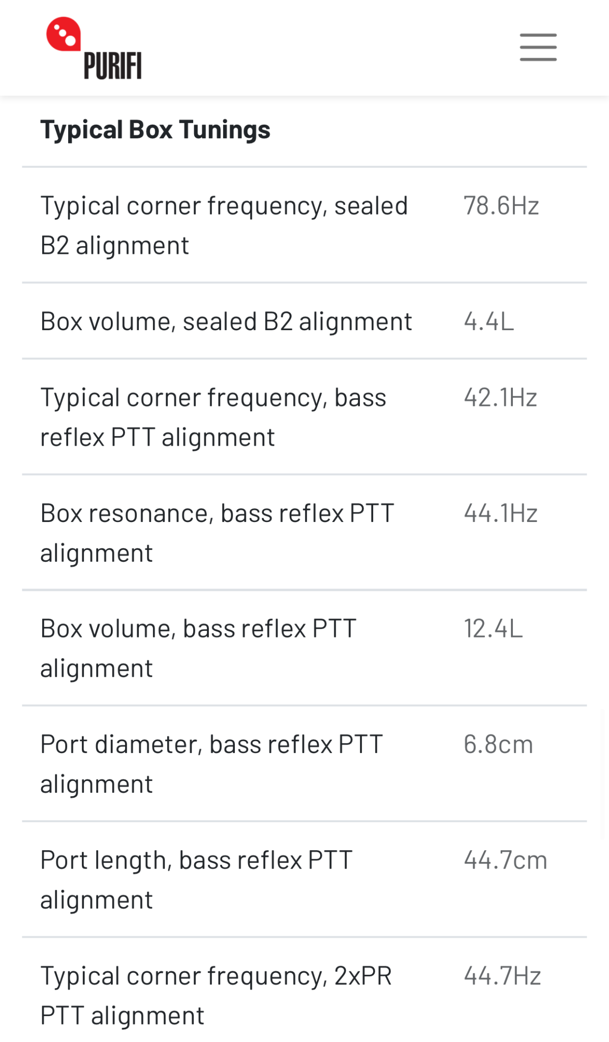

Can someone please explain ”PTT bass reflex typ alignment”?
Great question! Its a new alignment we invented giving an equi-ripple response with a selectable ripple in the pass band (typicall 0.5B is allowed). This gives a deeper bass extention and lower pass band group delay compared to QB3. I am writing an article for Voice Coil about it to appear in the Dcemeber issue. It is also applicable for passive radiator boxes as we show. Note that I made some updates to the algorithm and we have a pending update of the box suggestions in the web shop
