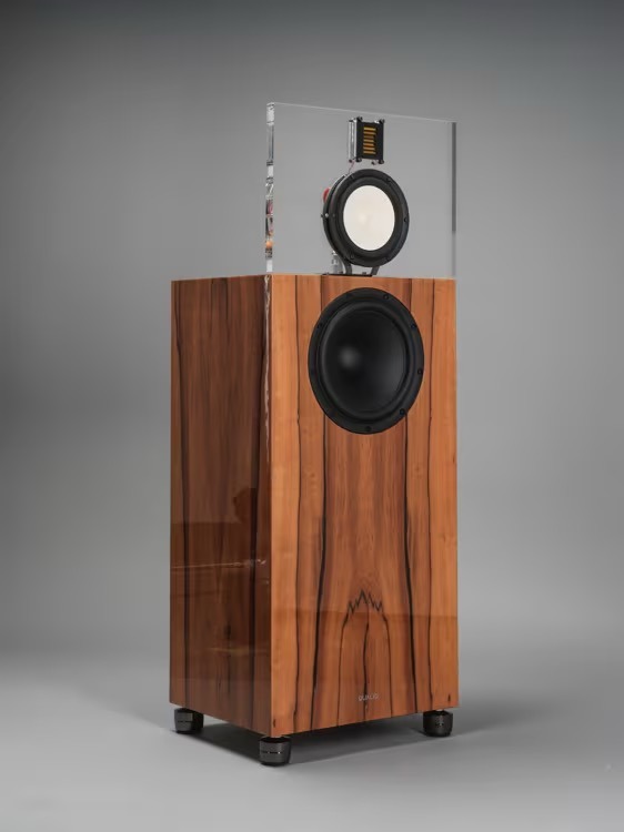

A neighbour is trying to convince me to package protect for mounting open baffles above the bass cabinet… with a wider and less deep bass cabinet below, on which the open baffle can sit. Like Wolf Van Langas.
Qualio does something similar with apparently pleasing results. https://www.qualioaudio.com/products/qualio-iq-1

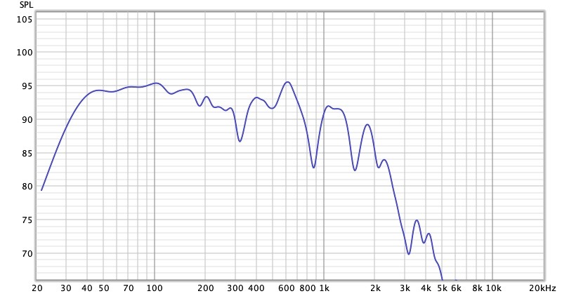

May I suggest, if you are not able to complete a ground plane measurements, or a mic-in-the-box measurement, as suggested by @lrisbo , consider alternatives to do bass response measurement that doesn't include the effects of your room, but includes/ incorporates both the midwoofer AND passive radiators.
One way to do this, is to place your microphone equidistant from all three sound sources-
As you have your MW on the front panel and PR on the side panels, find the point equidistant between the passive radiators- hopefully they will coincide with the centre point of your midwoofer. Next measure the front the back distance between your woofer and passive radiators. The intersecting line between these should be equidistant between all three. This point is INTERNAL to the cabinet.
Now imagine a point external to the cabinet. This point will be above (or below) your speaker cabinet. The levels will be different depending on whether you choose the top or bottom panel. But you're interested mainly in the shape of the response. So you can choose either, for convenience. Place the tip of the microphone there, about 5-10mm away from the cabinet panel, and perform a measurement at a practical level eg.
(at -20dB FS/1V to avoid overloading your microphone)
This is a close approximation of the 2i anechoic response (before considering baffle diffraction losses) from 10Hz to about 150Hz, before the drivers become directional.
Edits: spelling/grammar for clarity
Well, this is fascinating. I've never done a measurement like this. Here's the result. Seems like the low end is actually quite even in the omni-directional area.

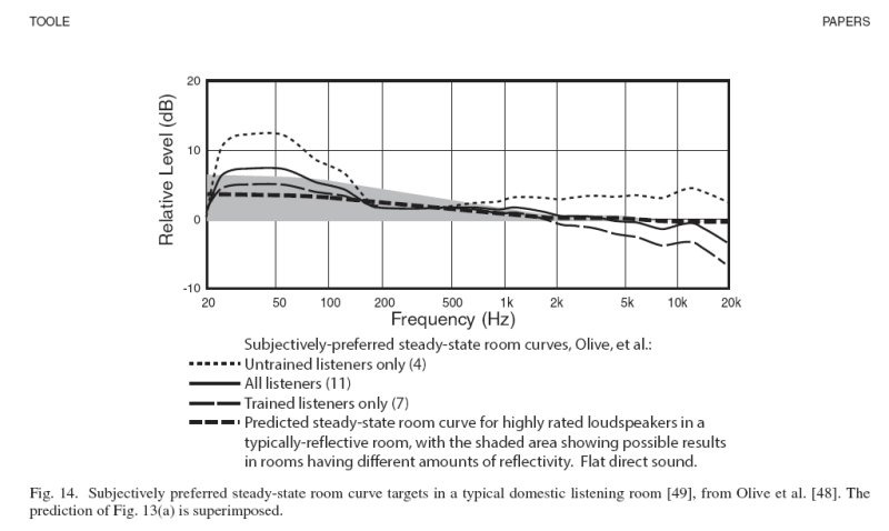

That's a good goal to have in a high-fidelity loudspeaker.
Actually not a good goal. Listening tests tell that we humans prefer non-flat spl response at listening spot. Flat in nearfield 0,5-1m would be ok.
It's a good goal to have in a loudspeaker since it better translates to the listening curves above once the speaker is interacting with the room. This is why the klippel is so telling how a speaker will act in a variety of listening environments. Flat anechoic speakers will generally give a downward trending slope in a room plus the room gain gives us more bass which coincides to listeners preferences. So, starting flat with a speaker is the goal.

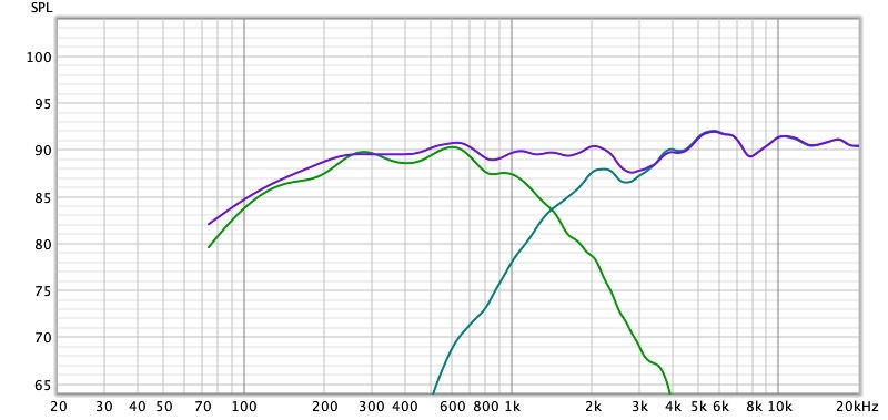

@ThatSoundsGood When you perform the measurements of the loudspeaker (on the tweeter axis I assume), do you apply a window to the measurements to remove the room reflections of sound that are typically captured in an impulse response? I am asking as your measured curves that I have seen look a little rougher through the crossover region and at higher frequencies than I might have expected.
That looks like a very good result: ±2dB around the 90dB level between 400Hz and 20kHz. It looks like you've achieved 3rd-order acoustic roll-offs, so the crossover region is relatively narrow, which is likely to be beneficial as the dispersion is better controlled. Also, the −6dB level at the crossover point indicates an in-phase crossover network, so the main radiation lobe is pointing directly forward.

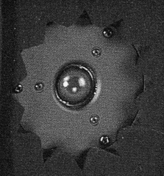

The small dip around 3kHz is possibly due to baffle diffraction at the cabinet edges. Have you considered placing some felt or other type of acoustic absorption material around the tweeter so as to reduce the intensity of diffraction effects? Something like that shown below might help to get the full, unadulterated potential of the T34B-4 to your ears.
It's stylish but the wide open baffle section is going to severely limit the range of dipole radiation this speaker can provide. This wide baffle is even more silly an idea if they are running the planar tweeter open back.
They need the baffle to be as narrow as possible and to be stepped so that it gets narrower around the tweeter too.

Yes on all fronts to what you're saying, except for the felt as I don't like how it looks. I made the cabinets with a 1.5" roundover in order to control diffraction (no small feat with a hand held router and solid oak baffles) and I'm still having some diffraction artifacts, particularly the 4db swing from 2.5Khz to 5.5Khz. But that was ultimately a compromise with the off-axis measurements to make the in-room response better. I was able to get it flatter on-axis but it was worse off-axis so I stuck with this final result, which I'm happy with.

@witwald: I have yet to see proper evidence, that felt on the front improve diffraction effects of tweeter. There is one simple study about it here: https://audioxpress.com/article/Diffraction-Doesn-t-Have-to-Be-a-Problem
I guess some felt between drivers in some situations may be good. But in the whole I think study is flawed in the way that one measurements on axis says nothing about actual dispersion.
Commercial use of felt around tweeter example in Wilson Sasha show ragged response on the graphs:
https://www.stereophile.com/content/wilson-audio-sasha-wp-loudspeaker-measurements
Im curious if it is actually working or it is more a myth going on.

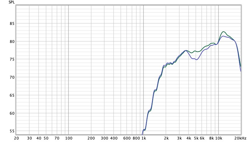

I tried the felt ring that Madisound sells around a CSS LDX25 tweeter. The tweeter was flush mounted in an 8.5" wide baffle with a 1/2" roundover. The felt changed the frequency response for sure but it was less flat. It made a 2db dip between 4kHz and 6kHz plus reduced everything above that by about 1db. I tried some other versions of felt and it never seemed to flatten the frequency response more so I never tried again. I've attached 2 measurements here. They were taken at 1 meter on axis of the tweeter and the only thing changed was placing the felt around the tweeter.

Thanks for sharing the measurements. The simple felt ring does make things worse. Maybe that's largely due to the circular shape, which if the felt isn't all that absorbing adds a strong early reflection to the tweeter's sound radiation. Would a circular arrangement of triangular shapes perform better? And possibly a thicker amount of felt, as the example provided seems relatively thin.
If the felt is actually absorptive then it can have a positive effect on diffraction. Most felt that looks good is quite hard and is actually reflective so it gets worse.
The Wilson star approach can create a chaotic diffraction pattern that may or may not have a positive effect.
I don't think it's the circular shape, but I don't really have any proof of that. I did try some other felt that was square. I cut it and applied it in several different ways to the baffle, but it never gave satisfactory results and never did much below 4Khz. I think the big problem is actually the thickness (or lack of). We know how thick room treatment needs to be so I would imagine that you would need 1/2" or maybe even 1" thick material to really help flatten things out.
