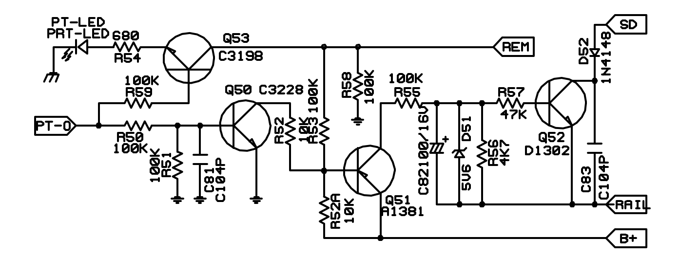

First, confirm that the output stage won't start oscillating if you connect the collector to the emitter on Q10 on the driver board.
Drive a signal into the amp to make sure that it has a reason to start oscillating.
Q53 on the photo seems Q10 (MAX marked)
Q50 on the photo seems Q5 (1D marked, SMBTA42)
Q51 on the photo seems Q4 (2D marked, SMBTA92)
Q52 on the photo is not connected as on the photo.
I can't find a connection between Q52 base and Q51 collector other than a capacitor in series.
Q3 is marked 2A (MMBT3906)
