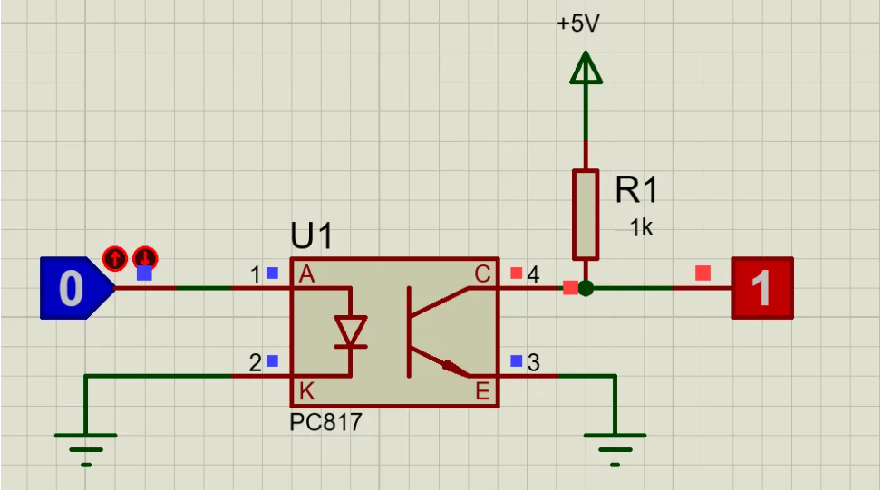

For a 4-pin optocoupler:
Try inserting the transistor side of the optocoupler between the 4148 and the resistor driving the gate of the jfet.
Power the diode side of the optocoupler with the remote but you'll need a series resistor to prevent damaging the internal LED.

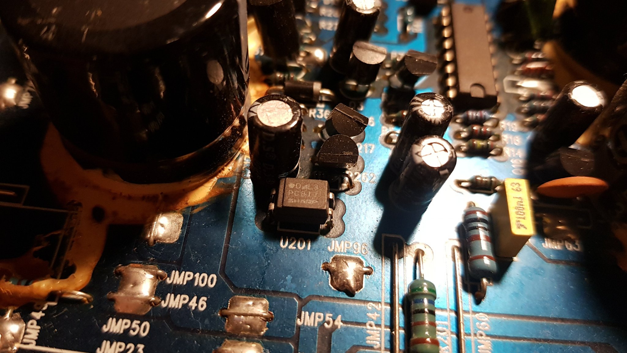

Connected the PC817.
And it works absolutely fantastic! :)
Not a single drop of rail voltage during power off. It also waits with oscillating until max rail voltage is reached.
Very strange, since I would expect the optocoupler creates an even bigger delay and would not be faster since the optocouplers transistor VCC comes from the same source as before (D22).
Anyway, would it be safe to remove the 15v rails and solder the rectifiers back in place?
Amplifier seems to behave correct currently with both powering on and off. It also produces clean audio.
I don't know if it's safe to go to full rail voltage but you'll have to try it at some point.
The remote is switching off before the rest of the amp can respond so, even if the optocoupler is adding some slight delay, it's a better point to switch from.
