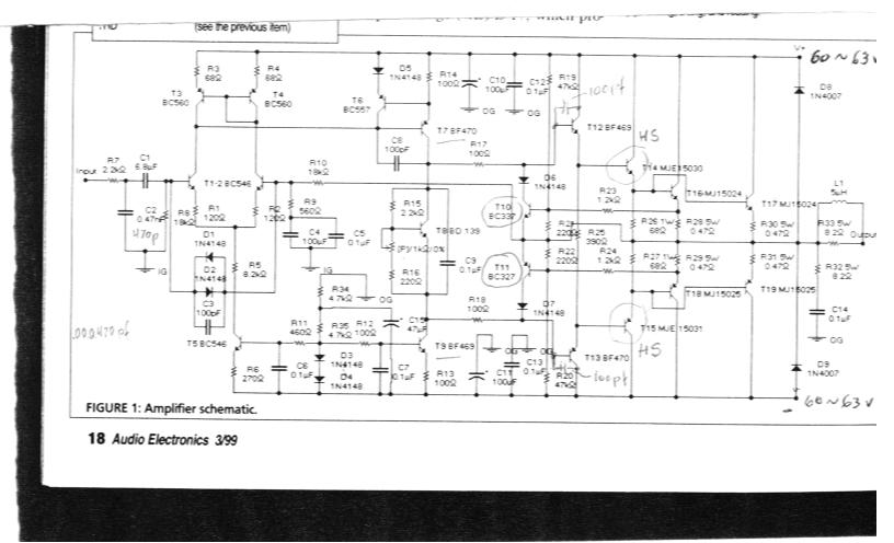

Need some help
Hello fellow posters
I've been triyng to get a layout of a certain schematic using
three different free PCB programs. For some reason, including
my own ineffiency I can't do it, including what I thought would
be the esasiest one (Eagle) to use. I guess is too complicated
for me or on the other hand may be being free programs they are
not complete and won't do the job.
It is an amplifier that I want to translate into layout but either
I can't edit the complete schematic or if I do the program does
not get the layout.
To be honest with you guys I'm not at ease with these programs
(at all) and having tried three different ones I tend to think the
problem is me that doesn't know what to do.
Can anyone help me a bit in this endeavor?
I'd really appreciated.

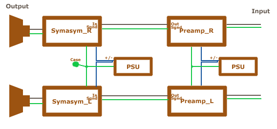

Hi Ben !
About the grounding scheme, you should not build it as you posted. Symasym has a signal-gnd input and through only that you should connect the preamp. Do you use a single supply for both channels ? And an extra supply for the preamp ? I assume that the preamp also has it's own signal-gnd. Also, only from the groundstar there should be a connection to the case, the RCA-jackets for input etc needs to be isolated from the case.
See my painting... Never connect signal-gnd and power-gnd. Use the supplied pins on the PCBs and use shielded cables for the signals (to preamp and from preamp to amp). Keep the 3 supply wires to the amps close together, the currents through these are zero in the sum, that means the magnetic field cancels itself.
I am not sure if you should connect the 2 groundstars, i think you shouldn't. You might connect them through a resistor, maybe 100ohms.
Mike

The schematic I'm trying to layout is a power amplifier published
in AUDIO ELECTRONICS number 3/99, author is José Arjol Acebal,
the amp is called Arjol professional amplifier. It's a common
configuration, and if I can post it there it is:
