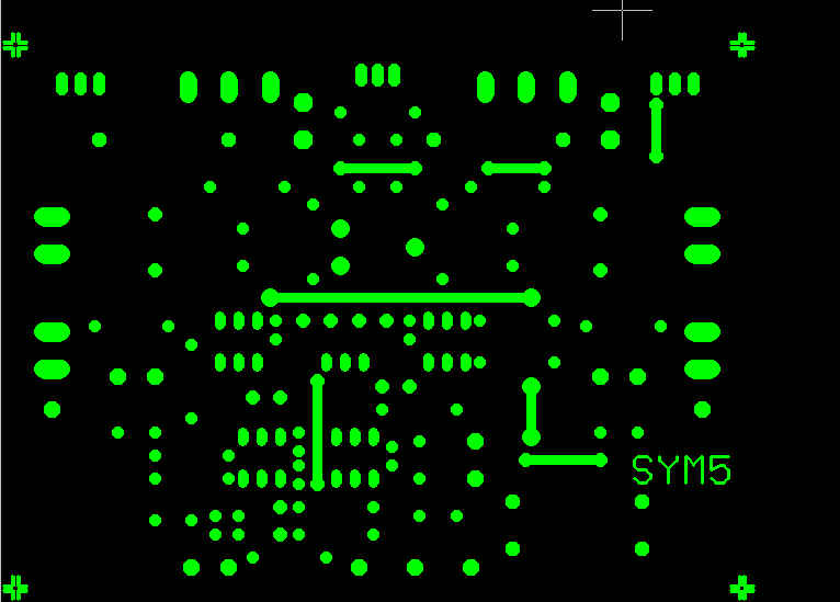

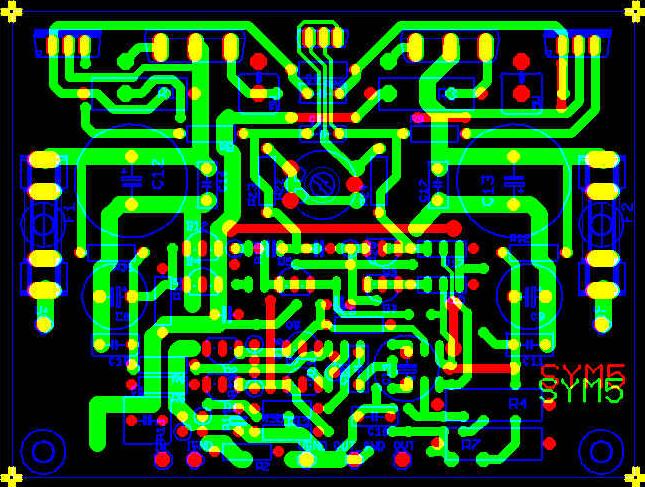

The layers seen in the Eagle *.brd file are not directly used for production. The production files must be created for example by gerber274x.cam (top and bottom film) and excellon.cam (drill). These production files are created from the *.brd file. You get many files with same name and different extension by this process. You will need *.drl, *.drd, *.cmp, *.sol, *.sts and *.stc files for double-sided PCB. Only top (red) and bottom (blue) layers of the *.brd file should be observed to see how produced PCB will look like. For additional questions please read Eagle manual, it can be downloaded from CadSoft website.

Pavel, thanks for the reply. What I did not understand was that why we have those pads on the top component layer too? Isn't the bottom circuit layer enough? They certainly wouldn't hurt though.

MikeB, I meant what's on the component side did not seem to be necessary other than the jump wires. I have attached the component layer from the Gerber file that I generated from BRD.

Hi tttking,
By default Eagle generates a double-sided PCBs.
I guess, if you ask for a single-sided PCB the manufacturer will ignore layer 1. If you ask for a double-sided PCB you will have pads on the top and bottom plus the "links" will actually be tracks on the top.
I think it is normal on double-sided PCBs to have a pad on top and a pad on the bottom with thru-hole plating.
Generally, if you design a single-sided PCB you would probably have larger pads so they don't lift when soldering (or resoldering).
Correct.
And *.sts, *.stc files I spoke about are solder stops (non- solder mask data). You do not need them if you do not want non-solder mask.
Keep some alphabet label at the bottom side for the manufacturer to be sure of film orientation.
Anyway, I would recommend double-sided PCB. As there are metal through-holes, the PCB is very rugged and resistant to common DIY solder/desolder actions due to often mistakes.

Would you please be so king to review my Gerber files here and give me some advice? I am worried about the Gerber files that I generated with Eagle gerb274x.cam. The .sol picture seems to be flipped from what I see in Eagle, therefore the image from .cmp and .sol no longer match each other in VIEWMATE display. Is that normal? Did I do anything wrong? Please refer to the Gerber files I attach here. Would you also ckeck the .DRI and .DRD files, if you can. Thank you.
