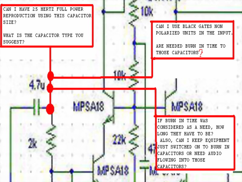

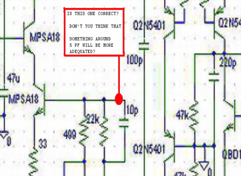

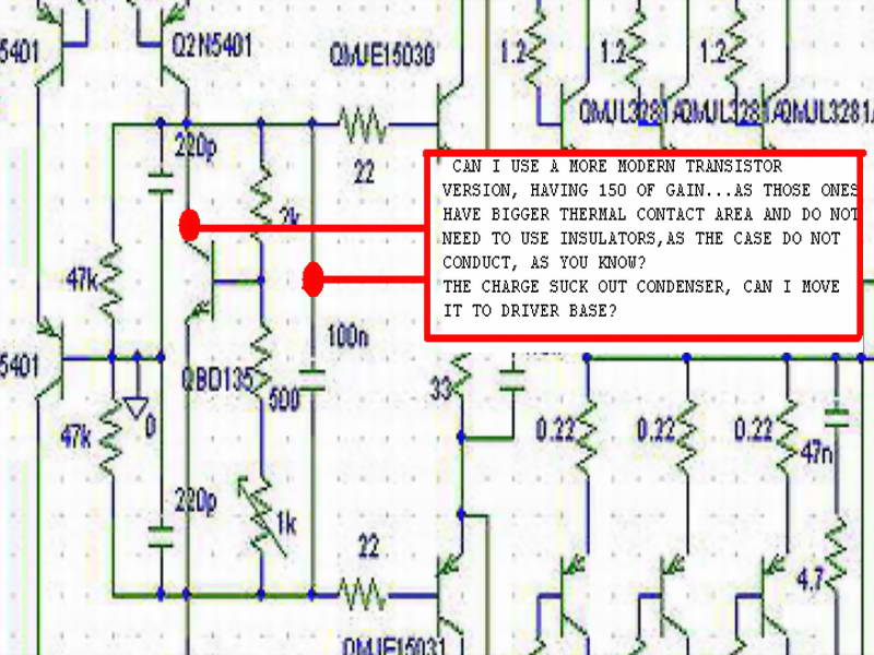

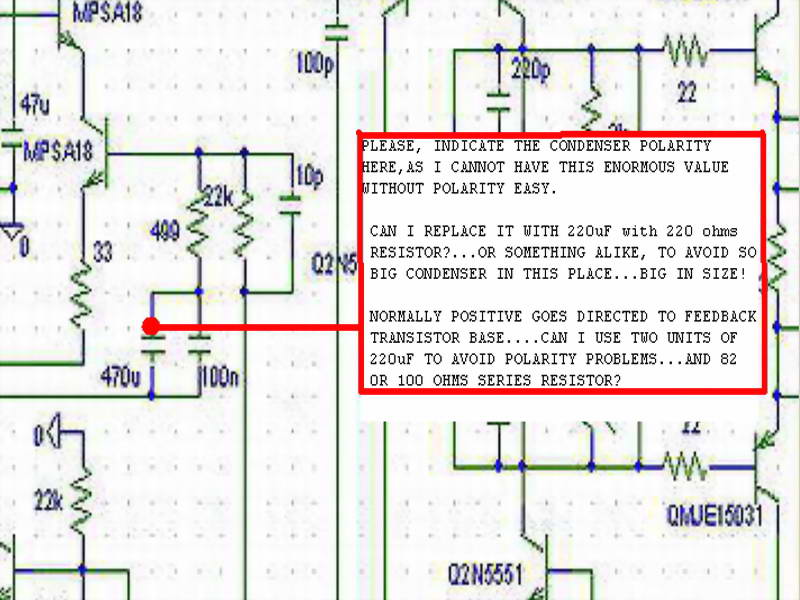

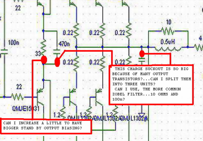

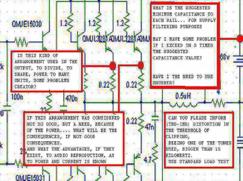

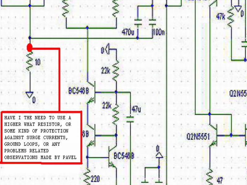

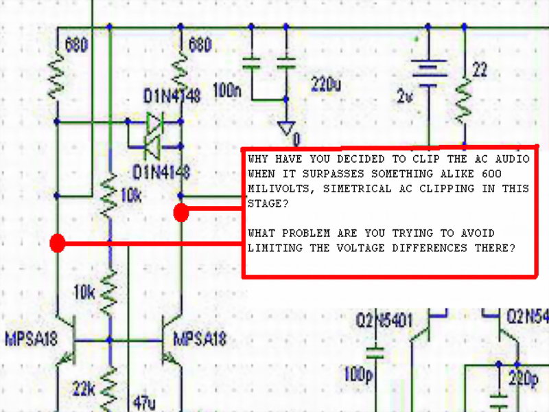

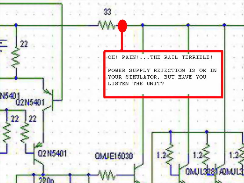

tttking..salivating was adequated...well, i have questions to Michael, because he is
the designer, but, other competent guys, skilled people, that can help me related some doubts are welcome too.
The questions are inside 10 images i prepare, showing the circuit.
This way will be easier to me than to explain in English what i mean.
regards,
Carlos
