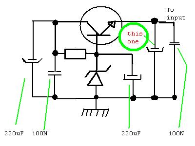

Please Pavel, an information, do you think that too much big condensers to rail
filtering can create some problem to sound reproduction?
I will explain...i prepared two transformers to Symassym, the higher voltage unit is beeing used to input stages, and an electronic filtering is used....those standards transistor, resistor and zener simple series filtering...... alike capacitance multiplier,or electronic voltage reducer.
I was in doubt related the electrolitic condenser to use at this circuit output....i decided to use only 220uF.
What do you think?
If i installed there, for instance, 10000uF....do you think that can create some problem....have i to snuberize...well, those CarlosFM circuits?

Hi DestroyerX,
I will put that circuit to work in my version of the low power symasym for the input stage PS in place of the resistor. I would say that in the higher power version that is even more necessary IMO.
If that is a series regulator I often see a resistor from the rail to the cap to bring up the voltage a little more gradually. I prefer to use a mosfet as the active device. I have a few left.
