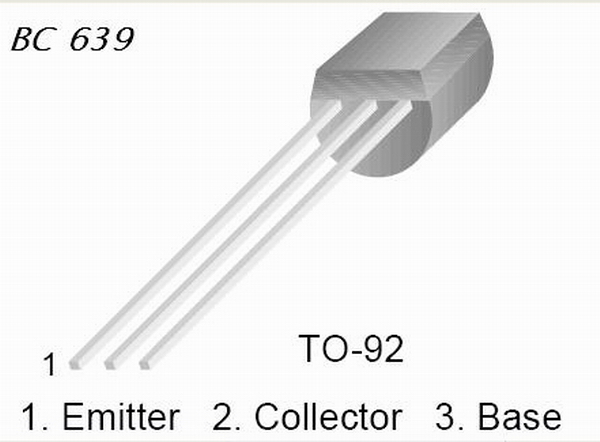

Atention!,Achtung!, Atenção!, Atencion!...there are problems with BC639 pins
You can find different pins, related Base position and emitter position.
I already had problems with this transistor because of that.
This way, i am showing you one example...between Philips or Fairchild and Siemens.
Check with your diode test, the one you have in your multimeter...for the ones that do not know, the base is the only pin that you can have conduction to the others two pins fixing one probe point on it.... inverting cannot conduct to other pins.
See the pins inverted.
regards,
Carlos

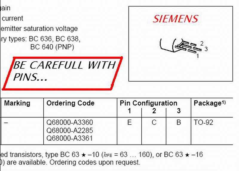

regards,
Carlos
Here is the oposite sittuation, this is dangerous.
So, as those forum people use to say, always test your amplifiers using series resistors from the supply into the amplifiers rails.
Good practice is to use a fuse to speaker.
See pins inverted related other manufacturers.
regards,
Carlos
regards,
Carlos

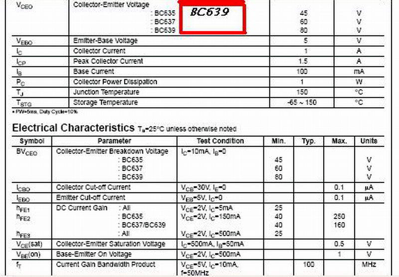

This transistor is not the recomended transistor for Symassym4 or even Symassym5 amp.
Michael do not like them, as he prefer more modern and lower capacitance units.
But despite of that, they work in the VAS position without problems, and have a very nice FT and reasonable Hfe.
Of course, using the ones Michael suggest, you will have the guarantee that all data he informed be correct in real world.
I am using them, because I have not the correct ones.
Attached some informs from data sheet.... i could see units that can work with 100 volts.... and i have tested that, connecting one unit to a 100 Volts supply.
This transistor problem is the gain, around 150.
regards,
Carlos

Hi Carlos !
The bc639/640 is no problem, it's quite similar to the 2n5551/2n5401,
gain is nearly identical with 150. The 2n5401 is slightly faster and
more modern (whatever it does mean) and has much higher voltage-
rating. So, the bc639 is a good substitute !
Mike

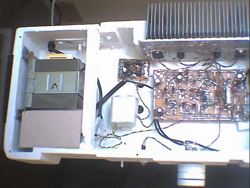

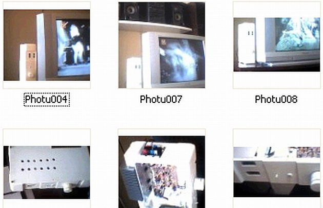

I installed the Symasym4 as a home theater.
Only one channel to observe the awfull audio quality of cable TV.... really, very noisy, i could heard on my Television Set...and the TV set was considered guilty.
Negative!...the fiber optics receiver produces noises into the audio band...checked with headphones.
But sounded great...i am still hearing.
regards,
Carlos
