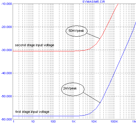

dinamics is astounding
Carlos, below is the input voltage for the first and the second stages of symasim5 at 870 mV(peak) input voltage, when output just prior clipping point.
You can calculate very fast what amount of distortion will be generated in the second stage at 20kHz with 100mV p-p input signal.
This sound stage you are babbled about is accentuation of transients by intermodulation products…
Sorry
Okay, next thing i see is that feedback drops ~5db at 20khz, which
does not mean increased distortion ? (Openloopgain is reduced
by 5db at 20khz, matches my simulations)
At these powerlevels the 2nd stage is at ~50% swing, that's how
i designed it. I don't see the problem ?
Mike
Mike
I am a blind version of Michael when i see those graphics
But Michael can understand your meaning, if you explain with more details... i think he is interested, his language is direct Dimitri, and sometimes it seems that he is saying something alike
- How deer you tell me that?..... What you mean about?... too much objective, short form, abreviation, ...the guy is German.
- I am sure he is crazy to understand what you mean with your graphics.... distortion is high, but more details related the way you measure, the schematic used, were you pick the signal, the details of the analisis variables used, frequency used.... a little bit more details...maybe i will capture too Dimitri....

Michael:
I could see Dimitri's Curriculum Vitae!!!... the man is a "monster" related know how.
I am blind for those graphics.
Thanks Dimitri
