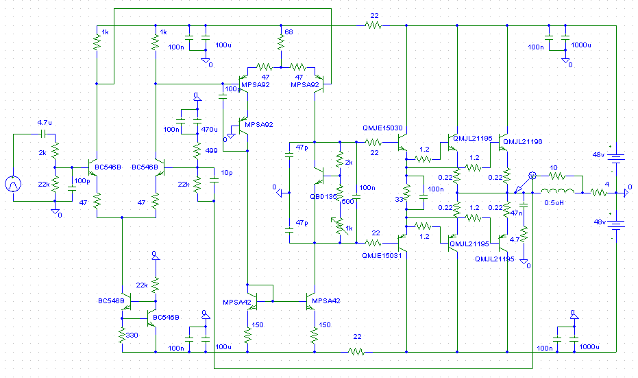

Hi htrinkle,
The p3a is for sure a very good amp, especially regarding partscount...
If you have difficulties with some parts, here are some possible
substitutions:
mpsa18: bc550c,2sc2240,bc546b these should do the same job...
2n5401/5551: mpsa92/42, bc639/640, but i i recommend to keep them.
mje15030/1: better not to replace...
output: every highly regarded bjt should do it, sanken, toshiba,
mjl21193/4/5/6...
I can post my layout for symasym4 if anyone interested, for symasym5
i have no layout yet... (i modified a symasym4)
The layout would not work to good with the sankens...
One important thing, the drivers (mje15030/1) must be mounted
on the heatsink, they are heavily biased...
Mike
This one is first Michael's suggestion, 200 watts over 4 ohms.
This one i did not assembled....and i think i will not, because i am more interested in 250 watts over 8 ohms.
My idea is simple.... 30 watts i feel as beeing good.....twice of that, 60 watts will be perceived as some increase...double again.... 120 watts will be more perceived as power increased...and once again....240 watts will be perfect in my mind.
I mean, three perceptive steps of increase, as we normally do not perceive diferences alike 30 to 45 watts..... almost the same...the speaker perceive...but i do not!
When Michael produced the one i am asking him, we gonna construct together.... we will share our opinions about, they will be compared to the expensive Yamaha he has, i will compare with my class D, will compare with AKSA, will compare with GEM, will compare with Symassym4 and will compare with JLH 1969 design and also with DOZ.
If the amplifier appear to be good comparing with those...yes, can loose here or there, but not loosing too much, will be aproved and "guaranteed", based in my own honor and Michael's honor, that force us to be true with all forum guys, the informations are something you can trust, as the unit will be good to hear, something that you can believe that will work, and that will not sound not too much worst than those Magnificent ones i told.
Of course all this is subjective, as i am not a computer, and i am not a distortion analiser, and even i am not a spectrum analiser...so the unit can be terrible to some guys...as even JLH designs can be bad to some guys, in my idea those guys are too much exotic related their music preferences, and may have some screws loosen inside their brains... or, they can be rigth... i can accept this possibility as something very remote..but i can respect this.....more or less....hummmm, very hard to respect someone that do not like JLH!
Almost half of forum guys aproved JLH as something very good, a Aksa has thousands of units sold, and i could not heard any customer talking bad things about it....GEM is a product, result of more than 10 years of research, and the man is a Scientist, that honored us with his presence and humble personality, giving atention to all guys, including the ones that enter to create problems, and to dennie even that the sky is blue....using some bad arguments alike:
- "bad weather turn the sky gray"...those guys, very feel they are...need some protude object under their motorcicle seats, maybe, to turn them more confortable, to be waken up in a long travell, or even to perceive how hard is the reality...having their medicine to themselves.
I repeat, to the ones that have some confidence on us, and my group of friends that help me to present myself have: Hugh Dean from AKSA, have Graham Maynard from GEM, have Michael Bittner from Symassym, have my own dirty boards, have support of many good guys, as Carlmart, Gilles Drolet, Sheldon, Barry Husbands,Greg Erskine, La fontaine,Jacco Vermeullen,Snuberized FM,JPenteado,Palesha,Barry Notifyme,Noel,Workhorse , and many others that can produce enormous list, to the ones, not written here, my apologizes because of my week memory.
The guarantee, and care to test the things designed, are done to those guys already listed, and also to be fair with all forum guys, not to let them construct timing bombs.... guarantee that they can have confidence, that if something works bad, they can trust in us, and check their components and construction, because it is guaranteed that the mistake have to be made during the construction...the amplifier is guaranteed to operate, and working very well, and i am confident that you will apreciate it very much.
The guarantee cover that the amplifier will work when correct constructed following the schematic, that will sound good, very near the most famous forum units made with BJTs, and that will not present problems related stability, heat and burns
Here is the Symassym5 schematic, modified to 200 watts RMS over 4 ohms....not constructed, not tested, and not guaranteed for a while...this one, it is your own risk to construct...and that sittuation is for a while only, as we will appear with a hard tested unit near future.
regards,
Carlos

Michael told me to produce those 250 watts over 8 ohms, will need some lethal
Will need some lethal voltages...and he do not want to be responsable of someone that can be severily damaged because of that.
We agreed in 250 over 4 ohms....i expect this can be good to many guys..... 125 over 8 ohms.
To avoid so big voltage.... i think he have good reasons, and this shows how serious this guy is.
regards,
Carlos

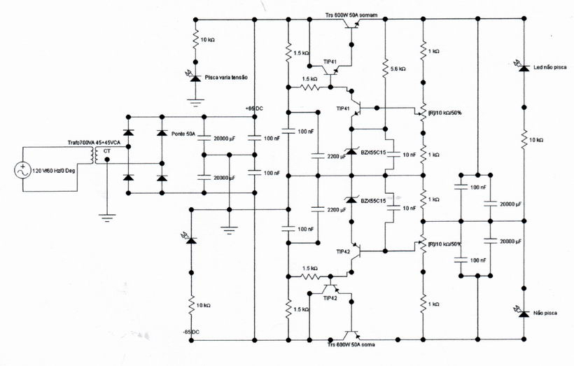

When i need higher and not commom voltages, i use this circuit.
Modified from a Sony Videotape machine, used in early seventies...was hard tested, and almost 50 supplyes alike this one where made and sold by me.
Normally they are produced not simetrical and to 30 amperes and 13.8 volts, to Ham Radio equipments.
I have not informations of problems with this circuit...maybe some resistors can be changed for higher values, to be more safe.
regards,
Carlos
