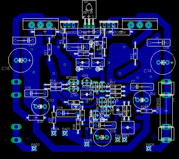

PCB Attempt
I have attempted a PCB for symasym5. Untested.
It's my first amp PCP, so I'm not sure if the layout is any good.
Some points to note:
Not shown are two jumpers (holes are there):
- One for supplying the ground to the VAS and 330pf/47K load.
- Connection between high and low side outputs.
I am thinking of using a double-sided PCB, and making the top side a big ground plane with channels cut to implement the above two links. Not sure if I need to isolate the gound for the VAS stage or not, but feel that I don't want decoupling noise on it - therefore seperate. I would connect the ground-plane to the de-coupling grounds (solder legs both sides, or use vias) but probably not to the signal grounds. I think that a, say 3mm, drill would be OK for removing copper from the ground-plane where component leads should not connect.
Would welcome any feedback.
Hans.

tlf9999 said:
and that's the least of his problems, unfortunately.
I see that the output caps are returned to the wrong spot. Anything else?
edit: the redundant led on the lower right is missing a series resistor, besides being backward.

htrinkle said:I have attempted a PCB for symasym5. Untested.
Hi htrinkle, i will take a close look to your PCB this evening.
I see that you use eagle for layout, i could upload my eagle-files,
but they are for syamsym4 and contain a confusing part, i had
no 2n5401/mpsa models, so used bc546/556 throughout, but
this way they are all mirrored. Because of that i had not uploaded
this layout, it does confuse... (lazy me...)
With my first PCBs i made some heavy mistakes with grounding,
resulting in heavy hum...
BTW, how do you transfer the layout to the board ?
I could send you 1200dpi-bitmap for transfer...
Mike

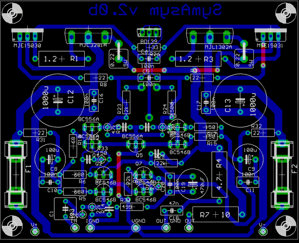

Hi Hans !
I tried to check your PCB, but have real trouble reading it...
It's a bit to dense... But i saw no problem.
I attached a shot out of eagle, showing symasym4, the one i used
for my boards that i showed earlier. Are you interested ?
Some of the traces could be thicker, but this pcb plays without any
problems, and should not take long for me to adapt to symasym5.
The pcb-size is 10*8cm.
Mike

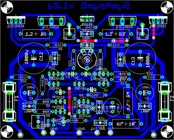

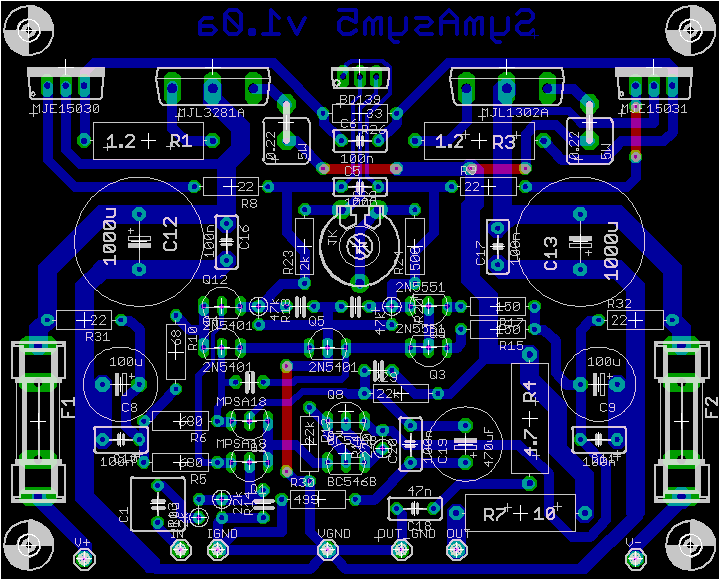

Symasym5 - Board files
Hi !
Thanks to Greg for making the packages to the 2n5401/5551/mpsa18 !
I changed the layout to symasym5 and fixed a minor issue...
So here are the boardfiles for eagle v4.15, the layout should work
without any problems, it's based on symasym4, the next days i will
make a test-etching to verify complete functionality.
Have fun !
Mike

Thanks Michael
I'll use the eagle files you provided - I think its better than mine, and tested.
I use toner transfer to etch my boards. Not perfect, but I found that it works good enough.
Thanks again,
Hans
Thanks again,

Hi Mike,
the grounds of the 100nF blocking caps C16 and C17 should be tied together on the shortest possible way, otherwise they are useless.
A via should not handle more than 1 amp. In this way I'd suggest to extend the via diameters so you can use solid core wires for the EAGLE top layer
Hi bocka !
I forgot to mention, the "upper layer" are wire jumpers, so the vias
are just pads. About the caps, i will check, i am at work now and can't
have a look to the files...
It's just that eagle seemed not very cooperative with wires, so i
misused the upperlayer for that. The PCB is still singlesided.
Mike
Mike
