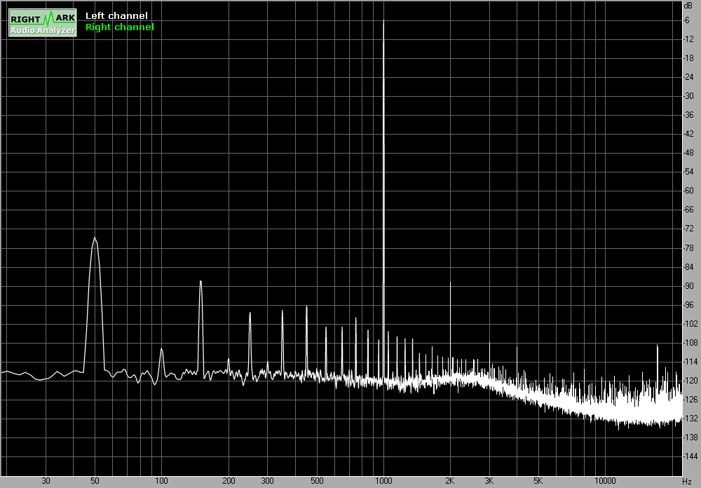

Example of fuse short-circuit current vs. time, if anybody interested. Note that interruption current strongly depends on di/dt, the higher the derivative, the higher the interruption current.

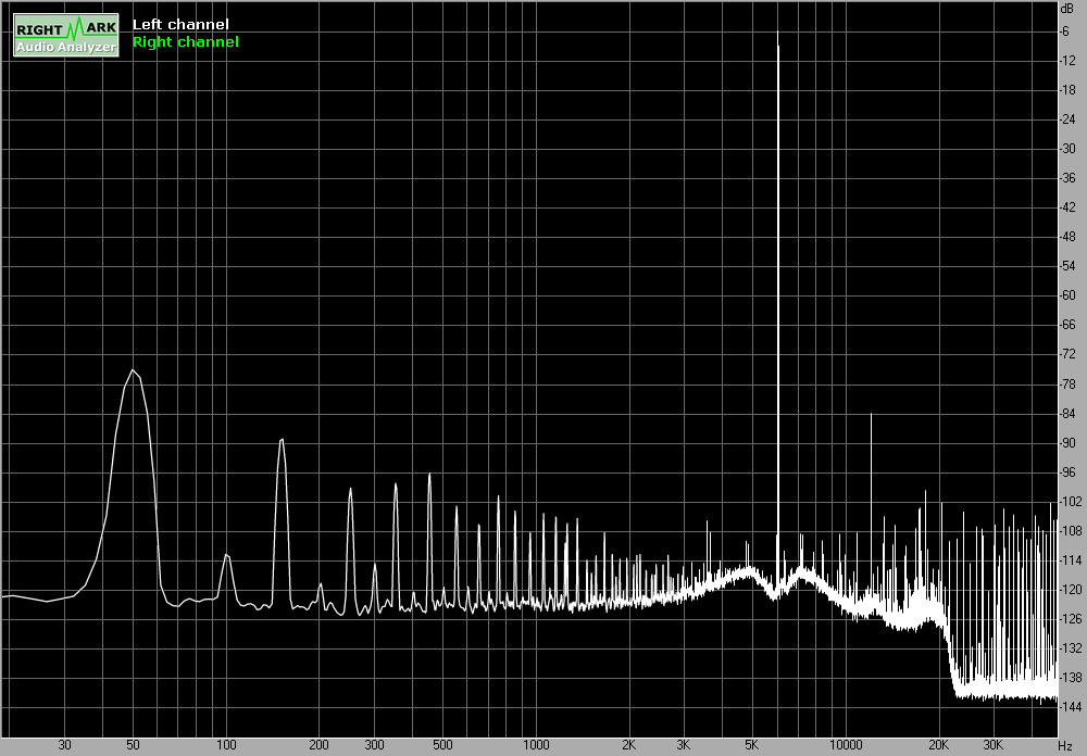

Hi !
I did some measurings today with new pcb, i attached a result...
My setup is very unlucky, the cd-player (signalsource) injects bad 50hz stuff with tons of odd harmonics. It is not caused by amp itself, if i pull the powerplug of the player everything is quiet...
H4 and H8 are caused by soundcard and player, everything else looks like it should, H2 is that big by design... (sightly bigger than in sims) PSU ripple is ~-110db, H3 is below -100db and the 17khz signal is caused by computermonitor...
Yipee, i changed the right stuff !!! :happy1:
Next days i will make 2nd channel and listening, quick listening showed that the amp might sound slightly clearer/more transparent/detailed...
Mike
Hi Pavels ! 😉
Upupa Epops said:
By which power is it measured, Mike ? I mean bellow max. output power....
Not much, this is ~5v into 8 ohms... The problem appeared the moment the amp entered ClassB.

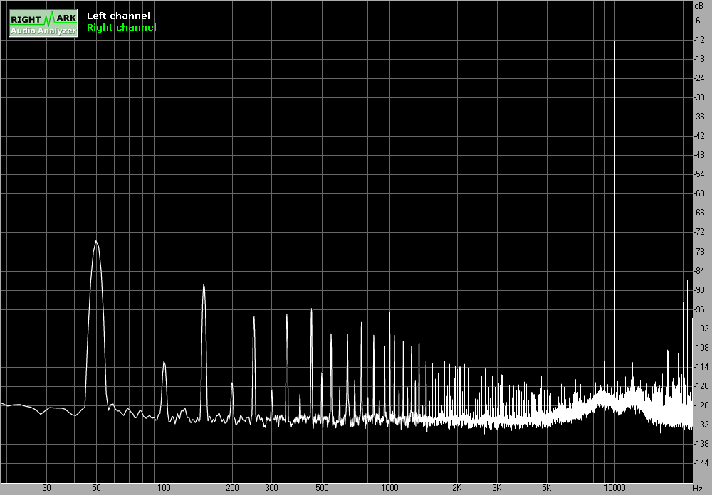

Hmm, measuring is not my best ability, that's why you had to do it !
You need to compare it with my old measuring. Observe the even harmonics having gone. And, this is with normal 50ma bias.
My ugly spectral lines ? I should do measurings only at daylight, without thousands of dimmed lights turned on everywhere... 😀 And i did not use any buffers, everything connected straight.
I attached a 6khz measuring, the harmonics increased only very slightly, ignore the horrible spectrals ! 😉 Okay, harmonics are hard to find, my measuring setup is a disaster, but okay for just checking the problem...
Mike
