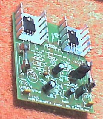

BTW there is not too much difference in this new board and
the previous one, at least it doesn't seem to be, except may
be the provision for a ground (thick) bar completing the ground bus. There are two more jumpers which I can't see very well
by the picture; but I'm going to wait for your veredict after you
test the amp with these mods.
