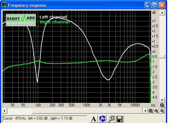

About speakers impedance...
Hi Carlos.
You can have a nice graph of impedance vs frequency for your speaker IF, in the schematics you posted above (resistor in series with speaker),
a) as an amplifier you put your sound card output
b) you take the voltage drop at the resistor and feed it into your audio card input
c) then some software that analyses frequency response (Rightmark Audio Analyzer is suitable) will give you the graph (reversed) of the impedance vs frequency.
In the following picture the graph for my small bookshelf JPW speakers is the white line. You see that the minimum impedance is at around 250 Hz (because the graph is inverted) .
If you want to find how much exactly is the minimum impedance, feed your circuit (resistor+speaker in series) with a signal at that frequency (250 Hz in my case) and measure voltages across known resistor and speaker. Using Ohm's law it is easy to calculate. In my case the minimum resistance was about 6.4 Ohm (speaker says 6 Ohms, so it is quite close.)
Keep well....
(and sorry for the off-topic).

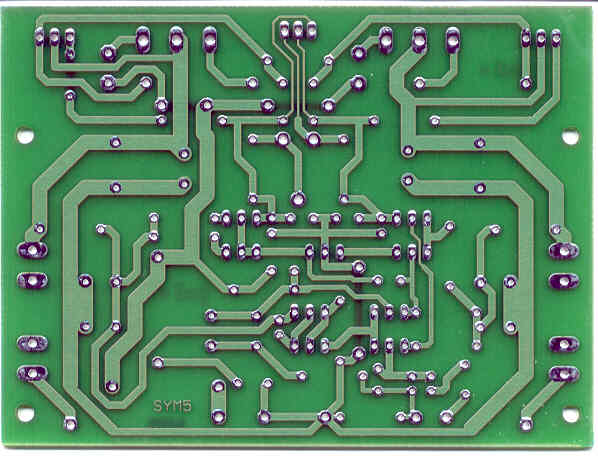

Could someone give me the dimensions of the PCB so that I could resize it correctly? I viewed it with Paint Shop Pro, but the printout is a full A4 page. Nice, but a problem for the components. I would like to try to build this design.🙂
