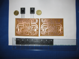

Hi Jarno !
I don't see any flaws in the etching, looks well done !
Obviously you have more than enough devices... Going to build a 5 channel ?
For resistors i use normal metalfilm 250mw resistors, except the
4.7/1.2/10 in outputstage, there i use 2watt version (also metalfilm). And the 0.22ohms are 5watts.
The trimpot is a normal Piher.
Happy drilling ! 😉

Hello Mike
Drilling is tomorrows business... Now it´s time for a couple of biers.
You should have a few too!
This is way OT but I am beginning to be worried about myself. I got few friends over on the other room and I am here browsing throuhgt the forums
I´ll be back after drilling and assembly is done
Jarno

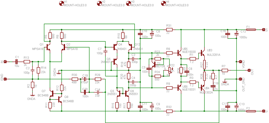

Hi, mr MikeB.
Can I use this amplifier with 1ohm? How I can use it on 1ohm? Addiding more pair of output transistors?
Thanks a lot.
Thanks a lot.

mod_evil said:Hi, mr MikeB.
Thanks a lot.
More output devices are not enough. To drive 1ohm load, You need to use predrivers between the VAS, and the MJEs.
sajti
mod_evil said:Can I use this amplifier with 1ohm? How I can use it on 1ohm? Addiding more pair of output transistors?
Hi mod_evil !
Symasym was not designed to deliver THAT much current, it does easily drive a 4ohm speaker, but not 1 ohm...
To do that, it would need a complete redesign. The VAS does not supply enough current, and changing it to triple darlington like sajti suggested will make it oscillate without further modification.
One possibility would be changing the outputstage to mosfets, and put enough of them in paralell.
Mike
PMA said:Do not forget their high input capacitance.
The highly biased MJEs in combination with the charge-suckout cap should be able to handle that, in theory...
Don't forget that the MJLs also have a very high input capacitance !
Mike

Michael,
input capacitance of large IRFs is about twice the capacitance of MJLs, and you suggested MOSFETs in parallel, that's why I commented. I remeber that you always told before that such changes should be tested.
Pavel

Pavel, using mosfets is only a theoretical possibility, of course this is untested and right now i can't recommend it.
I personally think, driving 1ohm directly is "nuts" and only asks for problems. An outputransformer might be best choice.
I can "guarantee" quality and stability of symasym only if it is unmodified.
Mike

Hi MikeB,
I think your homepage is simple and clear with good quality pictures! 🙂
Though the Eagle schematic have component text on top of each others making it a bit difficult to read, but I made a small effort and changed it! 😀
Cheers Michael
PS: Note for instance Q3 and Q9 text now have their right position, not that it makes any difference here as both transistors are the same!
Cheers Michael
Thanks Michael ! New Image already uploaded... 😀
Michael
