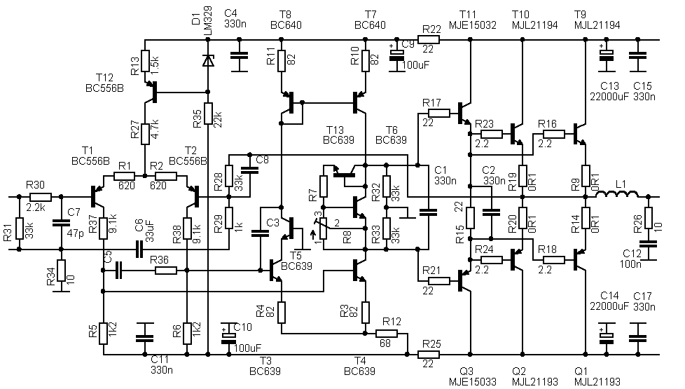

Explendid amplifier designed by Michael Bittner, our MikeB
Yes, I had lot of work, so there was not too much time for the amplifier.
So here is the schematic, but I don't remember the values of the compensating network, due it was set during the measuring with scope. I use only the RC between the collectors of the input stage.

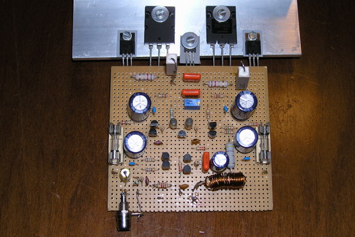

A new Symasym was born
Symasym 5 prototype finished. One channel, parts were placed as in PCB and connected point to point. PS voltage is 2x32V. It worked flawlessly from the beginning. DC offset is 3.5 mV. Small transistors were matched with DMM. BC550C instead of MPSA18 at the input.
First impressions are very good, I will soon make PCBs for two channels.
Mr Mike Bittner, I think you should be proud about this amplifier🙂
Though I 'd like to have both channels with PCBs (and better capacitors and resistors) to make a more valid evaluation, I must say that from the beginning the most profound characteristics of this amp are dynamism and extraordinary detail in all frequences. I must also say that this is the first time that my speaker gave me correct, good, rythmic, controlled bass.
Minuses? Perhaps a little hard high frequnces? Or maybe I imagine things, or perhaps with all these ceramic capacitors all over and common resistors one cannot expect everything perfect 🙂
Have a nice day....
Hi Dimitris,
welcome to the club ! And thanks for the compliments... 🙂
Nice to hear that it worked at once without problems and that you are pleased with the result !
About the harsh sounding, it shouldn't be, my latest version got rid of
any sign of harsh sounding. My latest changes were adding the 10ohms
between signalgnd and powergnd, the wire connecting the gndpins of
the supplycaps, and replacing the last ceramic-cap with a mica.
It's good possible that the use of ceramics cause harsh sounding.
The bc550c instead of the mpsa18 should not have big effect.
Are all components exactly the values from schematic ?
There is one thing i see on your photo and might be a problem, your
outputdevices ! What are they ? They are no MJLs, the right one looks
like a Toshiba, but the left one ??? I was wondering because of the
different packaging between npn and pnp...
Mike

"the RL circut in the output need to be after the Zobel-circut!"
That usually seems to be the norm, but not for the Leach,why?
Is the diode connected transistor in the bias generator to modify the multiplication factor for an EF output, as per Doug Self's idea?

These Fujitsu-devices do not look bad, especially the ft is impressive.
But, the vbe-curve is very weak, it's already 1v below 3A, the MJLs
have 1v at ~9A, also Vce-sat of 1v at 8A is not too good, the MJLs
have 0.25v at 8A. This might result in a weak, less powerful sound...
Regarding the powerhandling the Onsemi-devices seem unbeatable.
Just compare the SOA-charts for 10ms, the mjl3281 has 3.5a at 100v,
the Fujitsu only 1.2a...

There is one thing i see on your photo and might be a problem, your outputdevices ! What are they ? They are no MJLs, the right one looks like a Toshiba, but the left one ???
They are 2SC3281 (it is the same as MJL3281 I think, not sure though) and 2SA1943, because I had them handy.
It is very very possible that the harsh sound is from the CD Player (Marantz CD-67SE) as PMA suggested, but I 'll have to build both channels on PCB to find out.
Mike, I am very pleased with the result (this harshnes is probably my fault and is very very small anyway to keep us talking about something so minor) and I am really going to build this amplifier as monoblocks, because I think it is in a class of its own, at least for me.

About your outputdevices, the 2sc3281, have you bought it long time ago ?
I ask, because this transistor is obsolete, it is not manufactured since 2000,
so, all devices on the market with having a 2sc3281 printed on it are something else... 🙁
About the MJL, it should be quite similar to the 2sc3281, it was done by Motorola (now OnSemi)
to substitute the Toshibas some years ago.
The complementary to the 2sc3281 would be 2sa1302 (or 1304?), so your devices are very likely to be mismatched.
This could create problems, i don't know...
I suggest for a final version to get real complementary devices, you could use the sankens, the MJLs,
or the newer Toshibas ? (this 2sc5200) There are many good devices !
