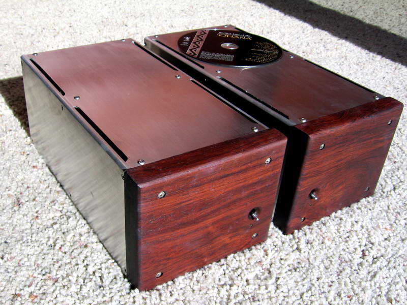

The external view.... hummmm this wood block...hummmm ...pretty!
Will be nice....hummm, put lamps over it..... maybe some color at nigth...well....my God!....having wine with a good and beloved woman.... eating Schrimps toasted with garlic....listening Ohana with Symasym....well..... something we can have, Paradise in earth.

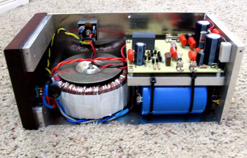

Ah Carlos, that does sound mighty fine. Thanks for shrinking those images to reasonable size. After this post I will figure out how to send you some music.
Regarding construction and cooling: The back plate is 8.3mm thick aluminum and the sides are 4.7mm and the top and bottom are 1.5mm thick. I used heat sink compound between the sides and back, which you can see in the first picture. Actually you can see it in the second picture too. You can see it as messy fingerprints. It gets all over the place if you are not careful, or hurry, as I did. I cleaned it off today. I played some music with a good amount of bass at a volume so that it wouldn't clip on the loudest passages. This was done on 8 ohm 87db speakers. It's louder than I would normally listen. After an hour or so, the back plate reaches a temperature of about 40 degrees C. My intended use is as a midbass amp in a speaker I'm building. It's 4 ohm but 96 db efficient, so the neighbors would probably complain before I have any heat issues. If I had an application where I needed more dissipation, I could add a finned radiator to top half of the back plate. Or, there's enough room to add a fan inside.
As far a sound: I was going to do a bunch of careful AB testing and report back, but I've changed my mind. I think I'll do it casually over time instead. Why? Well, it sounds darn good, and that being the case, I'd rather just listen to music. Carlos is right about the highs. There is something subtle but distinct that makes certain sounds just sing a little more. Otherwise, top to bottom, the sound is rock solid. No grain or edge at all. I compared with a chipamp I had made. That's a nice little amp and it sounds better than it has any right to, but these are in a higher league. Not just more power, but clean and tight all the way around. I also compared it to my 30watt pp tube amps. Those amps were expensive and sounded clearly superior to a lot of other high end amps I listened to before buying, both in tonal accuracy in imaging. The output transformers likely cost more than the entire symasym. With the 8ohm speakers, they are only a little behind the sysmasym in volume and are also solid top to bottom. I would not say that they are in a different league than the symasym. Between these, it would be a matter of preference. A subtle silkyness vs. a subtle touch of definition. The tube amps may have a very slight edge on imaging - maybe, but as I said, I'm not going to do intense AB study to find out. It comes down to this: These amps are very good. There is nothing that resembles a defect to my ears. From there it's personal preference for the subtle things that appeal to individuals differently.
The symasym is also very practical. I built mine with mostly components that I got at an electronics surplus store, including the ps caps. No exotic components at all. The most expensive transistors are the output units and they are about $5 each from Digikey. And I did the bare minimum for matching the transistors (two 9v batteries in series across the transistor and a 22k resistor, with base shorted to collector, measured across transistor). The power supply is as simple as can be. So you could probably tweak these for some subtle changes if you are so inclined. Maybe a few better caps here and there. The speakers I'm building will be at least tri-amped, so I didn't want to heat up the earth just to listen to music. I built these partly because, being an AB design, they only consume a few watts at idle. If I put my ear in the speaker cone, I can hear a very faint 120hz buzz, and there is no power up or power down thump. As for possible oscillation, the only way of testing I have is to put the antenna of an AM radio right next to the case or boards. I get nothing except a faint 60 cycle hum. So if there is hf oscillation, there ain't much.
The bottom line is; you have nothing to lose. Mike has designed a very fine amp. Carlos was right to guarantee it. And his threads are way more fun than any others.

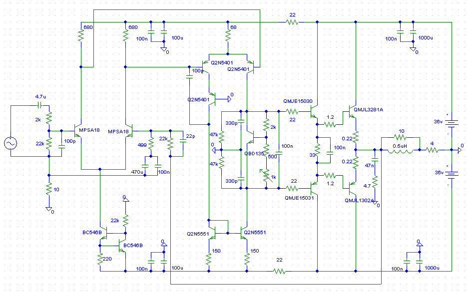

ps. Carlos. I did lift the input ground with a 10R and isolate the input rails with 220r, as you suggested.

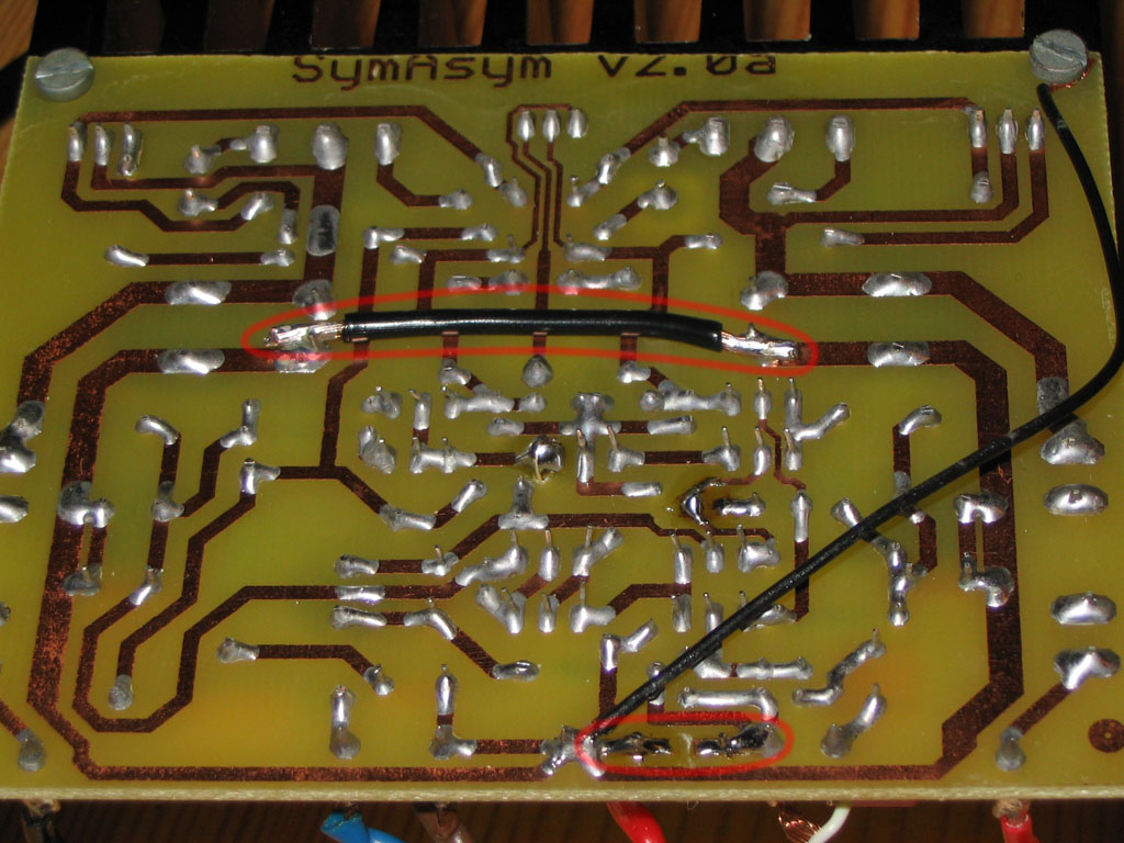

Hi !
I made some minor optimisations...
First, i added a 10ohm between signalground and powergnd:
And i connected the groundpins of the supply-caps close to the output:
(With thick and short wire)
Also you can see the 10ohm is easy to change into existing PCB. (On the lower right)
If someone is interested i can update the PCB with these changes, or redesign the layout. Anyone ?
These 2 changes came from optimizing while measuring, they reduced
the thd. Listening to it definitely confirm improved sound, it got slightly
softer and more detailed !
Mike

Michael
This modification is already made in my amplifiers, both Symassym are using this ground connection.
Also i am using 220 ohms in the rails..... yes, loosing power there, but turns more stable the input, as my supply is not so wonderfull and voltage variations can reach the input.
I am very satisfied with your amplifier...it has nothing to change in my mind...if you try to increase, check your evolution keeping one channel untouched.... to produce an A to B comparison, to have sure that modifications worked fine.
Yes, you know that!...this is just to remember.

yes I had some reservations to the results shown in the past, we have clarified that case with Michael and I believe that it has pushed the development in right direction, as Michael told me the results.
I have already started - firstly with simulation. The circuit has good perspectives IMHO. I can see slight problems with tuning of correction capacitances, especially those 330pF against ground in voltage multiplier. Also, I would probably appreciate lower value than those 100pF in the 2nd stage. This is only simulation, but shows that some problems might rise about 30 MHz approx. Have you got any experience?

Added a 10 Ohm resistor between input ANA GND and PWR GND, as mentioned by Carlos. This one must not burn, otherwise speaker damage will occur. We know this from another amp. Anti-parallel diodes of higher current rating could help. This 10 Ohm resistor may be burnt if there is an excessive ground current between input and power gnd.

Hi !
Phew, many responses ! 🙂
First, big thanks to Sheldon for the evaluation, makes me proud that symasym can at least keep up
with your tubeamps ! Also for me, the power is way enough for serious listening or to bug neighbors ! 😀
And i am very reliefed that you are pleased with it !
Yes, simple circuit without too exotic parts was one of my priority goals, and having no turn on/off thump
is simply a must for me. I do not like having to add protectionrelays afterwards...
Uncolorized/natural sound was also top priority !
I am quite sure that the amp is stable, the scope shows 2mv RF-stuff, but no matter if it is turned on or off...
If there would be an instability, it should have shown up with the squarewavetest.
And, very nice job with the cases ! And yes, symasym loves percussions !

I am not sure what happens if the 2n5551/5401 are substituted by devices with more gain, no idea...
PMA, the boardfiles on page 22 are the latest, the boards i use are a direct predecessor, until then i only
made minor changes, nothing that would be critical if my brain is still functional...
The traces on the upper layer are some "misuse" by me to easily implement wirejumpers.
This should only be a problem when giving these files into industrial production.
I have not etched the very latest version, but it is extremely unlikely that they have an error.
Thanks for the tip with the 10ohms, it would be really bad if they burn up, do you think a 1n4148 is too weak ?
Adding the 10ohm to the existing layout is very easy, i had planned it when i made the pcb.
Yes, the acsweep shows some artefacts at 30mhz, this seems the frequency where feedback collapses.
I once gave up having a perfect looking ac-sweep and concentrated on optimizing squarewaveresponse to have
low internal overshooting and no ringing. I had scope attached while playing music and never observed any
stabilityproblem. But there could be optimisation possible. I made the experience that stability is the
most important thing when using nfb, any instability (not just oscillating or not) causes bad/strange sound.
But, obviously i do not like millercaps...
Maybe you can detect with your experience some last problems ?
The 100pf in the 2nd stage seems quite uncritical as it is not a real millercap, i choosed this value as it
seemed maximum before phasemismatch started to occur in pushpull-operation of the vas. I used this one
to replace the RC in LTP i used before, but it showed internal overshooting.
I personally think, this little amplifier shows how much is possible with standard-topology... 😀
