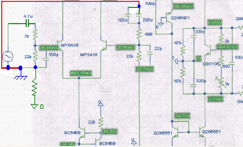

Hi all !
I updated my measurements, i was able to get rid of most artefacts,
now looks much better than my previous result !
I still have some problems left, somehow halfwaves from the supplywires
induce signals somewhere... This creates the "big" even harmonics.
The hum seems to come from the amp not beeing in a shielded case,
most of it is already present before amp is turned on...
http://www.lf-pro.net/mbittner/rmaa/Symasym4_cd_3.htm
I have not changed the amplifier itself, only wiring and groundconnections.
It looks like that without the induced signals the thd is somewhere at 0.001%.
It's really horrible that wrong wiring can change thd about factor 100 !!!
I got everything from 0.12% to 0.0012%...
Mike

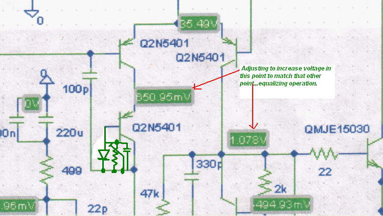

Michael, yesterday i was observing small differences in current related up and down
differential voltage amplifier related its mirror.
The rigth one is conducting more....so a preference for input or feedback will happen there.
I do not know if you will understand what i mean...but maybe, suggesting a diode in the Voltage divider auxiliary transistor...the one with base to ground.... a series diode there....before the base, with a resistor in parallell to adjust current in upper transistors..... well...matching them perfectly, without any room to milivolts fluctuations there.
If not understood...hehe.... i am not designer, nor a programmer....so, you may not understand me..... so.... tell me and i will send a MP3 audio to you.
regards,
Carlos
regards,
Carlos
Hi Carlos !
Yes, i think i understood you !
Are the differences measured bigger than the currents shown here ?
http://www.diyaudio.com/forums/attachment.php?s=&postid=683534&stamp=1121552477
You mean the difference between the 2.466ma and the 2.442ma ?
This is hard to avoid and is caused by unbalanced load from the
unmatched mje15030/31.
About the diode, you can put it to the emitter of the voltagedivider-bjt,
that is much simpler !
The slight imbalance in the currentmirror can be killed by a cascode,
eliminating the 2nd harmonics, but who wants that ?
Mike

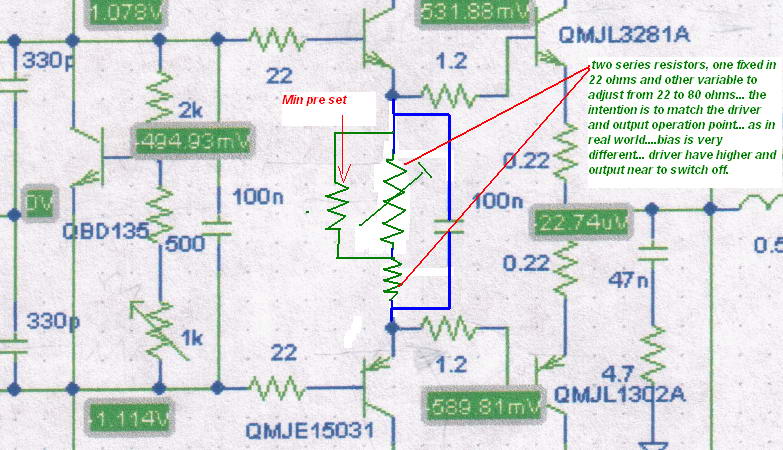

I could see that here things turn very different when changed
I am talking about the floating 33 ohms resistor from driver's emitter.
But this image is showing the matching of the voltage amplifier.
Do you think can be good?
Yes, i know those ideas can be a little idiotic for you Michael...but this is cooking inside my boiling brain a long time...the input ground and rail are already modified in my units....absolutely no hum....input open....no signal...no hum!

Re: The input can be a little different.... what do you see that cannot be good here.
I already did that modification with a 10ohms, gladly i had planned
it when making the pcb... It's an increase in quality regarding grounding-issues ! (Measurable)
I will show later in detail, after having listened to it...
BTW, i have/had no audible noise/hum, have you ?
Mike

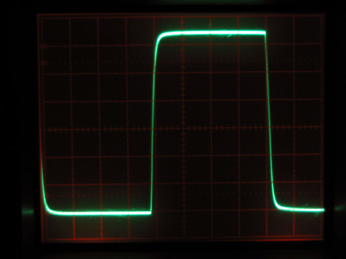

Really pretty square wave...hehe
This is passion..... those things are hard to explain.... someone turn full of passion watching a square waveform.
Hummm....what do you think if she turn sinusoidal....hummmm?
Well.....there are people that prefere triangle.... triangle wave shape...hummmmm.
ahahaha....
cheers for your square wave Miky...uncle charlie are observing that you are happy...you deserve...you made a good amplifier, and cooperate with our diy friends....they will feel good listening.

I am sure that Michael is catching the right end of the rope now ... 😉
BTW, what was the repetition frequency in http://www.diyaudio.com/forums/showthread.php?postid=734246#post734246 Mike? Or time per division?
Ooops, small detail...
Frequency is ~11khz, made with a 2bjt-multivibrator and a buffer.
This gives 10us/xdiv. ydiv was 2v as i remember.
Slewratelimit is not reached yet. SR measured ~20v/us, this is no
record-number, but seems way enough.
My dummyresistor is not big enough to make photo of this measurement,
but looks identical.
Mike
