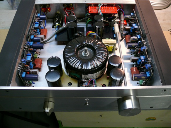

I have finished a newer version of symasym 4.1 described in my earlier post, but now I'd like to make it a powerful amp using 2 pairs of 2sc2922/SA1216;20,000mF/63V rectifier cap for per rail with A big power transformer weighing 8kg. The Power amp is running with +/-52V, predrive at +/-67V. I use separate rectifier for each channel.
The amp turn out to be the best of my amps till this time. The sound is very lively.
Although this amp is very powerful, the gain is quite low and I have to put on a buffer preamp with using OPA2134.
Finally, I have to adjust gain compensation circuit according to the type of output I'm using.
just to present the finished product.
4 channels

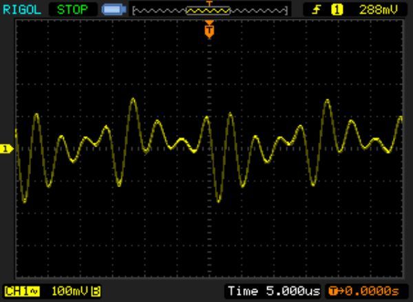

Hi All
I had taken the original symasym and designed a "Car amplifier" around it because I enjoyed the original so much.
The amp uses two sets of OP transistors and runs off +/- 42V, because I expected it to drive 2ohm loads as well. It sounded clean and detailed but about 2 weeks ago I noticed some distortion appearing from the speakers which seemed to fade a bit after warming up😕
I used a scope on the VAS section and noticed the attached waveform. The waveform measures 520mVpk.pk and the frequency was in the region of 266kHz. I tried different values for the stabilisation caps in the VAS thinking that driving 2 sets of OP devices could be causing the problem.... no luck. Changed the 22pF cap in the feedback line to lower values and slightly higher values (before it broke into huge oscillation)..... no luck here either.
The only time this "oscillation" dissappeared was when I removed the 2 x 22R base stoppers from the MJE* driver transistors effectively disconnecting the output stage. Please help as I do not wish to change values from the original without knowing what the consequences would be. 🙁
