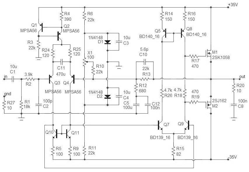

Blast from the past, I recall mid 90's, using lateral mosfets should anyone be interested in replacing the output with MOSFETs.
Can anyone explain how the idle current is set on this one?
I don't know if I get right but to me it looks like the current
is set by the voltage across R18, which depends on the current
in the LTP , which depend on the voltage across R15, which depend
on the common mode voltage on the collectors of Q10-Q11, which
depend on the current in the first LTP, i.e the current source Q1-Q2.
Does it mean that Q1-Q2 should be connected to the heat sink
for thermal stability?
Antother difference to the Symasym is the absence of the cascode
in the second LTP. Is the cascode used to increase the gain in the
second LTP?
/Peter
