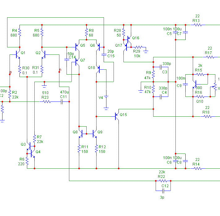

How about this:
Hi Chris.
You are right. Just to add, cascode output is high impedance, in case we need it for voltage drive (like VAS), buffering allows to utilize cascode advantages. It is the way how to reduce distortion significantly. Overloaded cascode does not decrease distortion, the only merit is a constant voltage operation of preceding stage and decrease of capacitive load of the preceding stage.
