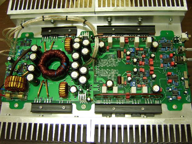

Explendid amplifier designed by Michael Bittner, our MikeB
The main HF ripple is being modulated by a lower frequency. I wonder if this modulating frequency is the 33kHz PSU leaking through?
If it is, then the PSU frequency is passing the filters on the PSU output AND the amplifier PSRR is still letting some get to the amp output.
Could the PSU be sending the amp into an oscillation?
If I probe the transconductance stage that waveform is so minute that on the lowest scale it can barely be seen. That waveform is present at both sides of the bias transistor.
Strange thing is that Mike's original amp layout ver 5.1 was tested with an enclosed switching psu (that I had built a while ago) that has the exact same switching freq. and that troublesome waveform is non existant in the VAS 😕
