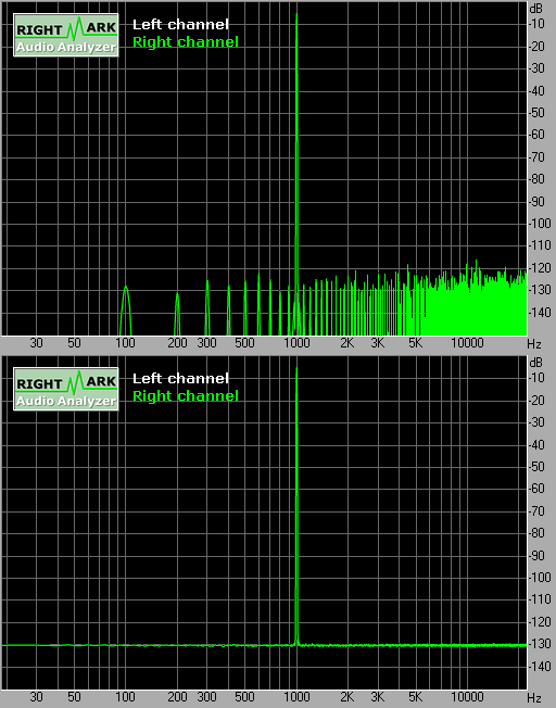

The latest measurings showed me that symasym would be capable of ~0.001%, and looses a lot of performance only because of grounding/wiring/layout.
Pavel, i analyzed your wave file (the 1025.5khz thing), you should have told me that i forgot the dithering... :headbash: That gave all these nice spectral lines... What a difference ! Attached is fft of same wave without and with dithering.
BTW, i have another idea why the jfets sound better, is it possible that they increase psrr at an audible level ? Variations from the ccs will modulate the base currents for q1/q2, having an impedance unbalance at ac to the bases (only dc is balanced), these variations are not eliminated. This effect would not exist with jfets...
Mike
