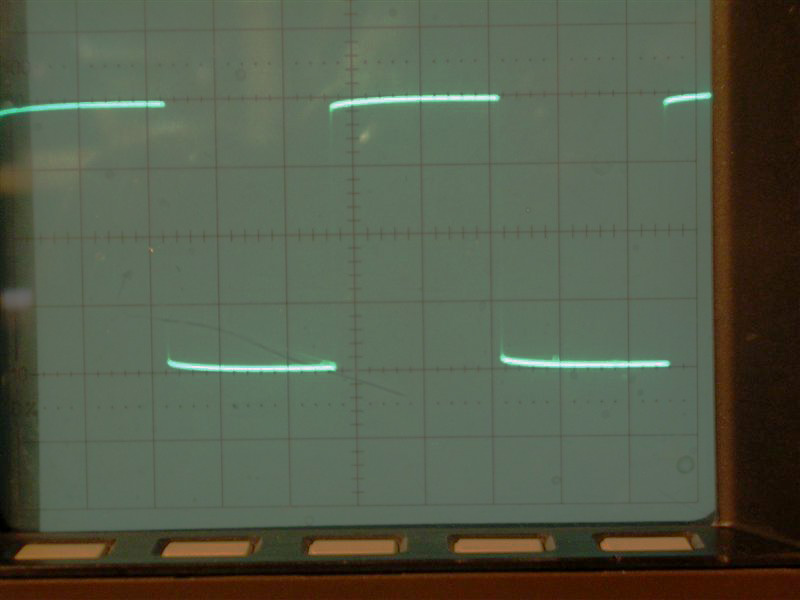

1 KHz square wave, 20 Vp-p under the same conditions.

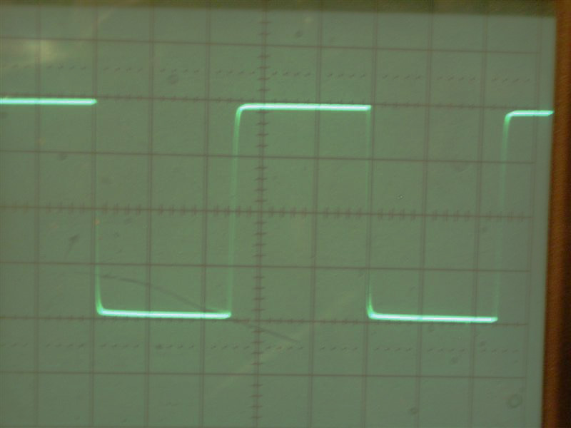

Hi Mike,
stability is obviously not the problem... The 10khz looks perfect...
Possibly even a little rolled off actually. Could be the input network doing that. Not that I'll complain because the 10 KHz square wave looks great. You can see a little droop in the 1 KHz square wave from the coupling caps.
I had this treble problem also with the MJL21196/5, higher bias (>100ma) solved it.
I was going to hunt for the "happy" bias point. It may be higher or lower. These effects may be from the drivers rather than the outputs. The sound quality will be capacitor related, if you look at the board picture. I can't easily measure the current draw at this moment except to say that the actual bias current in the outputs is close to 60 mA.

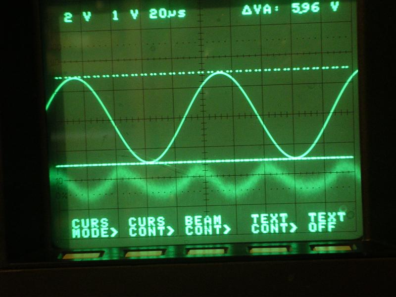

The bias point for lowest distortion was found to be about 22 mA. I was looking at the residuals at 10 KHz at 1.5 V rms into both 8 ohms and 4 ohms. At 22 mA the crossover distortion is completely gone, past that point a bit really. Above 22 mA there is increasing supply noise and hash, but no oscillation.
So here is what things look like now Mike. The measured distortion is higher, but the level is now at 1.75 V for this shot and measurement. I am seeing 0.028% right now. Not bad by the way.0.024% THD at 1 KHz with a similar residual. I am fairly certain that this is front end stuff.

Chris, what was the low pass filter setting on your analyzer when you did this shot?
Jan Didden
Hi Guys,
The Leader does not have a low pass filter. All the HF stuff comes riding on through. But that's okay because it does not dominate the residual. The 400 Hz high pass filter was switched out, I forgot to put it back in when I was looking for noise.

Hi Chris,
Reason I ask is, it looks just like 10kHz cross-over filtered through a 22kHz (which is standard) low pass of the analyzer. Has caught me more than once on the AP.
Might just be worthwhile to look up the freq response of the analyzer just to make sure what it is you see.
Jan Didden

Jan, good point, but the crossover distortion was visible at other bias levels, and the last measurement was at 1khz i believe.
