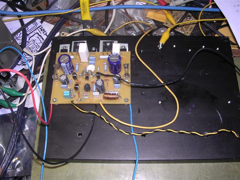

Hi Mike,
The first Symasym came alive in the most boring manner. No smoke, no excessive current, no oscillation. DC offset was +3.5 mV. Too early to form an opinion yet. Sounded much as I expected, and that's not a bad thing. I tried 70 mA bias to start.
-Chris
Hi Mike,
I lied. DC offset is actually -1.5 mV at the proper bipolar 34 V supply voltage. It drifted down to -2 mV warmed up. I'll have to build the other channel to let you know how it sounds in relation to some other stuff.
Promising amp.
-Chris

My work has only begun. Firing it up this morning the offset started close to -1 mV and drifts to -3.0 mV. Anything below 10 mV is great, below 50 mV I'll accept depending on the schematic. I think the annoying stuff I hear are those ceramic caps. They will be changed out once I fully test this one.

Hi Mike,
Instead of a clear "ting", there is some "shing" mixed in. Female vocals sound a little dirty in the high registers. I am listening to Loreena McKennitt. Harps and acoustic with femal vocal. Celtic (The Visit).
Keep in mind that this is only my impression. I have been able to eliminate this sound in other amp designs (some). Also remember that those darn ceramics are in there. Even the dreaded C14. I expected it to sound something like this with those components, but I wanted to do some testing before replacing them.

Hi Mike,
See the deplorable conditions these modules must work under?
At least you can see the heatsink is grounded. The supply is what is left of a Marantz 1180DC that died horribly, running through a variac.
-Chris
Edit: You can't see the ex-Marantz. Darn.

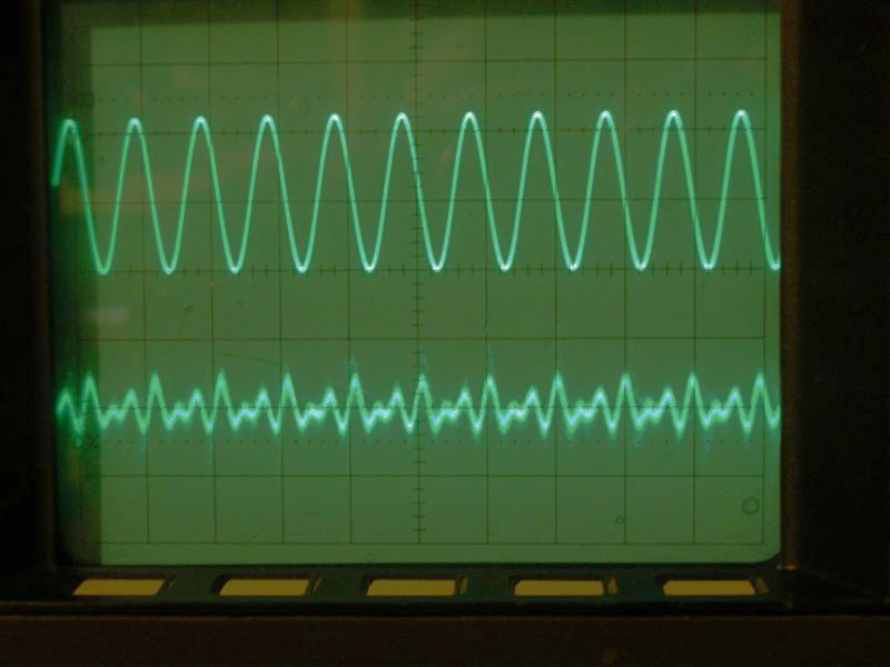

Hi Mike,
Here is some testing with standard test instruments. The measured THD was 0.017%. The Leader LAG-120B I'm using measures 0.032%, the lower impedance of the Symasym swamps out the hum pickup I guess. I am seeing 60Hz noise on the generator residuals.
So, 1 KHz at 10 Vrms into an 8 ohm, non-inductive dummy load at a bias current of 60 mA ........
The bottom trace is the residual from the THD meter (Leader LDM-171)
-Chris
