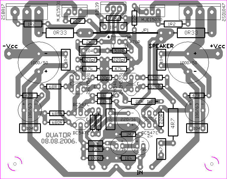

Hi Mike,
I’m interested in building your symasym amplifier as a part of my new active speaker design. 2 way speakers are already there, hand built by me, for now using standard speaker crossover.
What moves me to built symasym is that I’m already familiar with excellent sound of this topology, no need for exotic and/or expensive parts, and the fact that I already have most of the styroflex capacitors needed.
To be honest, I didn’t quite like PCB already presented. So I’ve decided to make my own with few modifications. Picture is attached.
As for the schematics, mine will be different from yours in these few details:
1) 18k resistor at the very input of the amplifier. Previous stage needs 10k for input impedance of the next one, so that’s the reason.
2) 2 x 22uF low esr or some audio grade electrolytic capacitors, connected as bipolar capacitor, just in case I can’t get WIMA MKS-2 4,7uF capacitors.
3) 1M resistor to keep those electrolytic caps polarized. Not quite necessary, but may be useful as an option. I’ve seen it here and there so maybe I’ll try.
4) Q1 and Q2 – BC547C as Mr. Pavel used. Can’t get MPSA18, and BC’s are readily available,
5) Q7 and Q8 – BC547 as well.
6) Since I don’t want high gain amplifier, I’ve added emitter resistors to Q1 and Q2. 33 Ohms is the value.
7) To lower gain, R30 is increased to 1k.
8) Because of the previous measure, C19 can be decreased to 220u/16V low esr type.
9) C14 will be soldered beneath the PCB, in parallel with R29.
10) C3 and C4 are going to be reduced to 220pF since I already have those and Mr. Pavel successfully used them as well.
11) Instead of mentioned output transistors, I’ll be using Rotel’s favorites – 2SD1047/2SB817, simply because I already have them. (In short: SANYO triple diffused planar Si transistors, AF 60W output applications, 140V/12A/100W, hfe 60-200, 15MHz, Cob 210pf (300pF for PNP type), TOP-3 case).
12) Their emitter resistors will be 0,33 Ohms since I already have those.
13) I won’t be using R7 with inductor.
14) I won’t be using fuses as well.
Any way, before venturing myself into yet another behind-my-wife’s-back financial project, I’d like to hear your thoughts of PCB design I’ve done, and of the changes introduced.
Best regards,
Nick

Hi Nick, nice work, but a few issues:
- if you reduce the 22k at input, you MUST also change r29 from 22k to 18k, otherwise you get a quite "large" DC-offset
- bipolar elyt at input is not really necessary, simply put + pin to the input pin, - pin to base of q1
- You somehow swapped -vcc and +vcc, the 680ohms from input diffamp are connected to negative rail ? This way the amp will not work.
- Where's the 10ohms connecting signal-gnd to normal gnd ?
- Grounding, like i did in v5.2, you have splitted postive and negative ground to the elyts, now you have large currents with half waves flowing around the frontend inducing large even harmonics.
- You shouldn't skip the fuses, they have 2 purposes, one is to keep the amp from causing fire in case of failure, and their resistance in combination with the 1000uF form a low pass filter to the voltage supply.
- i placed the output devices as close as possible to the bd139 to get better thermal tracking.
Without the fuses and with the 2 groundwires it might be better to skip the 2 x 1000uf and their bypass caps.
As the speaker wires are likely to get very short, skipping the output coil is no problem.
I will take a closer look this evening, i had not much time yet.
You have at least one issue that will make the amp not functional.
regards,
Mike

Hi Mike,
Thanks for your answers.
Regarding 18k resistor - this one is in front of the capacitor thus not affecting DC bias of the amplifier at all. This way, 22k stays as it is.
You're right about swapping +/- supplay rails. It's a typo. Those lectrolytic caps should also be reversed. Sorry. No matter how much checking things something always pass you by.
There is no resistor between grounds since I've never used them in my amplifiers and never, ever had any problems with buzz or hum. They were all dead quiet at all levels. Don't know if it's going to be a problem here.
About capacitor ground - do you mean that electro magnetic field of these PCB traces will be causing me troble? If this is the case, it's very easy for me to connect these grounds together (except signal ground). My intention was to lead these grounds with separate wires to the star ground. So now I'm puzzled.
Huh, about the fuses. I don't realy like them but I might do as you suggest. I'll place them on the board.
About output trannies position. Yes, I'm aware of the fact that they are a litte bit further away from BD139, but heatsinks are going to be large enough to compensate this. So far all my amps had trannies placed in this manner and didn't cause me any trouble.
OK, these are my thought for now. I'll change the PCB later regarding PSU orientation issue.
Like to here more of your thoughts.
Thanks and best regards,
Nick
Hi, you have made second star at the caps 1000/50
