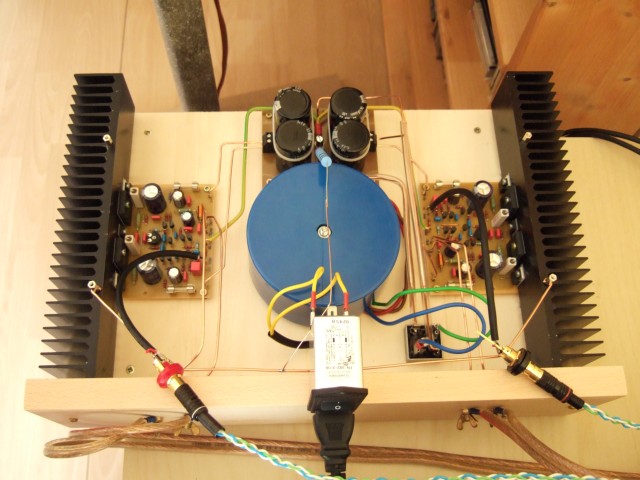

The casing? No it is the final box, wood with heatsinks left and right. But the connections will get some changes, I want XLR and maybe powercon...
I had better treble when i replace the output transistors to Sanken units
2SC2922 is the NPN...i was using 2SC5200 from Toshiba.
Related the suggested transistors to output, i cannot tell how they sound, as i do not have them...well, it was aproved and may be excelent.
But i could have better hi frequencies with this replacement i have made and telling you all.

Hi 12 cents, nice job ! What did you use for output transistors ?
Carlos, i haven't tried the Sankens yet, from the devices i tried i found the MJL0281/0302 the best, the Toshiba sc5200 sounded a bit too soft for my taste... I still have to try mosfets...

Well Mike...beeing you design, for sure will be good
And i already have Mosfets to try also into your design.
I am testing Holton units, and i can borrow some Mosfets to test your unit...keeping one channel of Holton amplifier untouchable... as it is elected as one of the 10 plus amplifiers... arrived to stay.
This amplifier from Holton is wonderfull, have exceptional sound.
Well...here is Symassym thread... and your unit is an Explendid unit of course.
Yes...i found 5200 mufled in comparison with the 2SC2922....i had much more brigth, more life, much more emotion in the high end with those units.
I had used in the past, but some monthes ago i decided to try some of them, the 2SC5200.
No!....of course amplifier did not sounded bad...almost impossible to make it sound bad...but had a new life....a more opened, aired...not soft sound...but present and defined...something sharp.
If diferences were easy to listen...yes!, they were easy to perceive as better option to output...well, better than 2SC5200.... about your design transistor, i can believe that it sounded great, but i really cannot confirm, as i could not use those output units till today.
Reliable the Symassym, very nice sounding, once adjusted do not change biasing...100 percent guaranteed!
Much more than explendorous thing.... it is explendorous, but i already did it!...so...explendid!

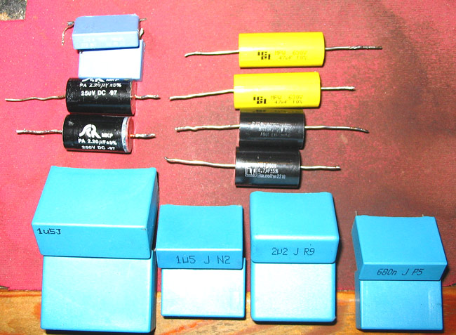

I have and extra set if you want to trade something for them. Some decent wima coupling caps or?
Sheldon
Sheldon
