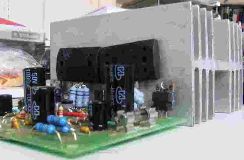

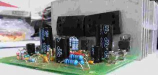

my progress
Hi Michael!
Please look at my efforts,
I do not have enough time to finish your amp v. 5.3.

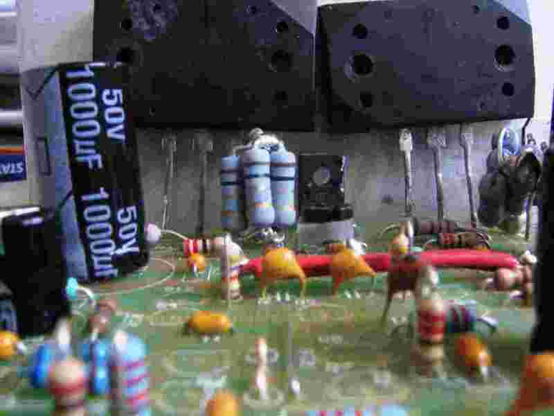

As you can see I paralleled 5 pcs of 1 ohm thick film resistors instead of 0,22 ohm emitter resistor, to minimalise its inductance.
As VAS transistors I used the pairs of BD243C/244C, what do you think, will they work properly?
The Sankens have too large cases, so I had to solder them at a certain angle to be able to mount them on a heatsink.
For soldering I used Pb-Ag alloy (4%Ag).

Hi padamiecki, about the sankens... 😀 Everything somehow fits !
About BD243 as vas transistors, thats a big no no, it has 12 times the capacitance and 50 times lower ft than the 2n5401, that's even bad as driver. You really should keep the 2n5401/5551 here, they are not really subject to substitution. Also, it is a to220 with different pinout than 2n5401, will be difficult to fit onto the pcb.
Or did you mean using them as drivers instead of MJE15030/31 ?
Yes, it should not be bad to move the outputcoil from the pcb, but you should keep the RC (4.7R + 47nf) where it is. Don't forget to replace the 10ohms with a bridge on the pcb.
I heard that the RC needs to be as close as possible to the outputdevices...

But, still as drivers these are lousy, with ft=3mhz they are 10 times slower than MJE15030 or your Sankens.
I missed somehow an information about bridging 10ohms res, thank you for it!
The coil was in paralell to the 10ohm, if you skip the coil you need to short the 10ohm...
Mike

More, I can see that MJE15030 are necessary...
How about Zobel? Better leave it on the board?

I think, keep the zobel as it is, it's asking for problems moving it. (in theory)
For the beginning you might build it as suggested ?
Mike

I built two versions of this amplifier, the first one upon the original
design and I concluded we were in the presence of a winner as
later on we found out. This amplifier was directed to my son who
needed a PA amplifier for his work. PA amplifier imagine!
But then I felt a little sad to have gotten rid of it even though
the amplifier was given to a very good cause.
So I decided to build another one to complement a series of good
amplifiers I own. And here I want to reveal a little secret to
everybody, a secret that I didn't even reveal to Mike B.
Due to my bad eyesight (I'm getting to be 68) I made the boards
mirrored without even noticeing and after they were ready to
install the components that's when I saw the boards were
reversed. But hallas, I said, I'm not going to make another pair of
boards, I'm going to go ahead and make the amplifier and see
if it works. What a challenge, installing components carefully
trying to respect their positioning the reversed way! Come to
think of it this is not a big deal, except I never faced a situation
like this before.
But guess what? It worked first time...It was just a matter of
adjusting the bias (very easy task) and here it goes playing
music the way it was supposed to.
I'm revealing this just to prove one thing, this is an "explendid"
amplifier that works the right way, upside down, mirrored way,
you name it. And what's incredible is it works, it plays with the
very same quality.....
So, to finish the story, I'm a proud owner of a UNIQUE piece
of Symasym, the "mirrored Symasym", ah,ah,ah....
