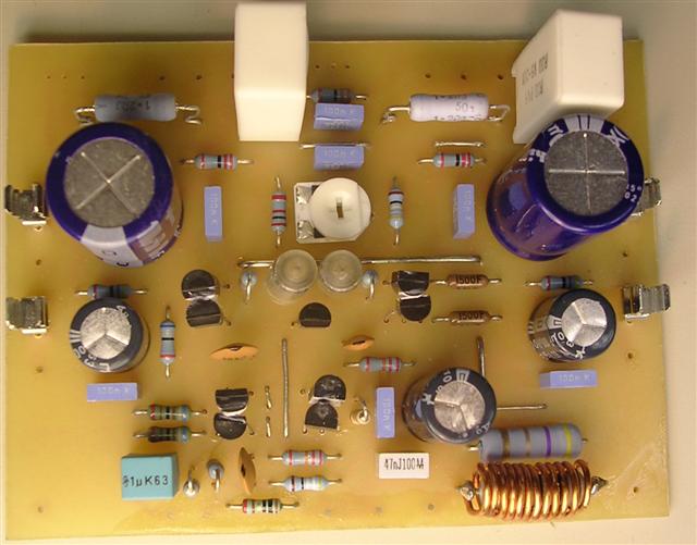

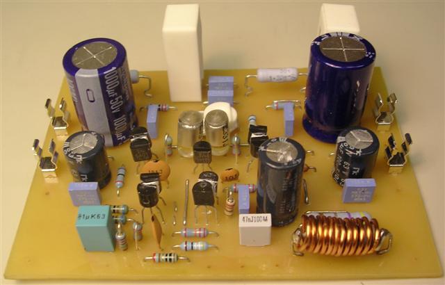

The first unit (ver 5.3) is almost ready for playing with. I am waiting for driver transistors. I may buy a bunch of polystyrene caps to relace the ceramics. My past experience leads me solidly towards these cap types. I can only find them in 50V. My input cap is 1 uF, 4u7 and 10uF both non-stock and expensive as sin!!
A shot of the board
-Chris
Hi Chris, i was too lazy to match these devices... The MJE15030/1 were not a problem, the ones i measured were very close in beta. The MJL21195/6 i tried should have been matched, my left channel shows DC of 5mv (was <3mv before), a good sign of extreme mismatch.
I did not take measurings, it's always a big rearranging of things.
The drivers (MJE15030/1) should be easy to get ? About the caps, you definitely hear the use of ceramic caps...

Hi Mike,
Yes, I have mica caps as well (they don't fit the board). I want to change them one at a time to get my bearings on the sonics. I am putting a Mouser order together so I can buy some polystyrenes.
I could not bear to install the 330pF ceramics. Those would sound horrible in the Vas section.
Anyone know where I can buy 100V (or better) polystyrenes other than Partsconnexion? Radial would be good for Mike's board. Don't want to spend a fortune.
Mine are back ordered on at least one of the pair. Figures.
