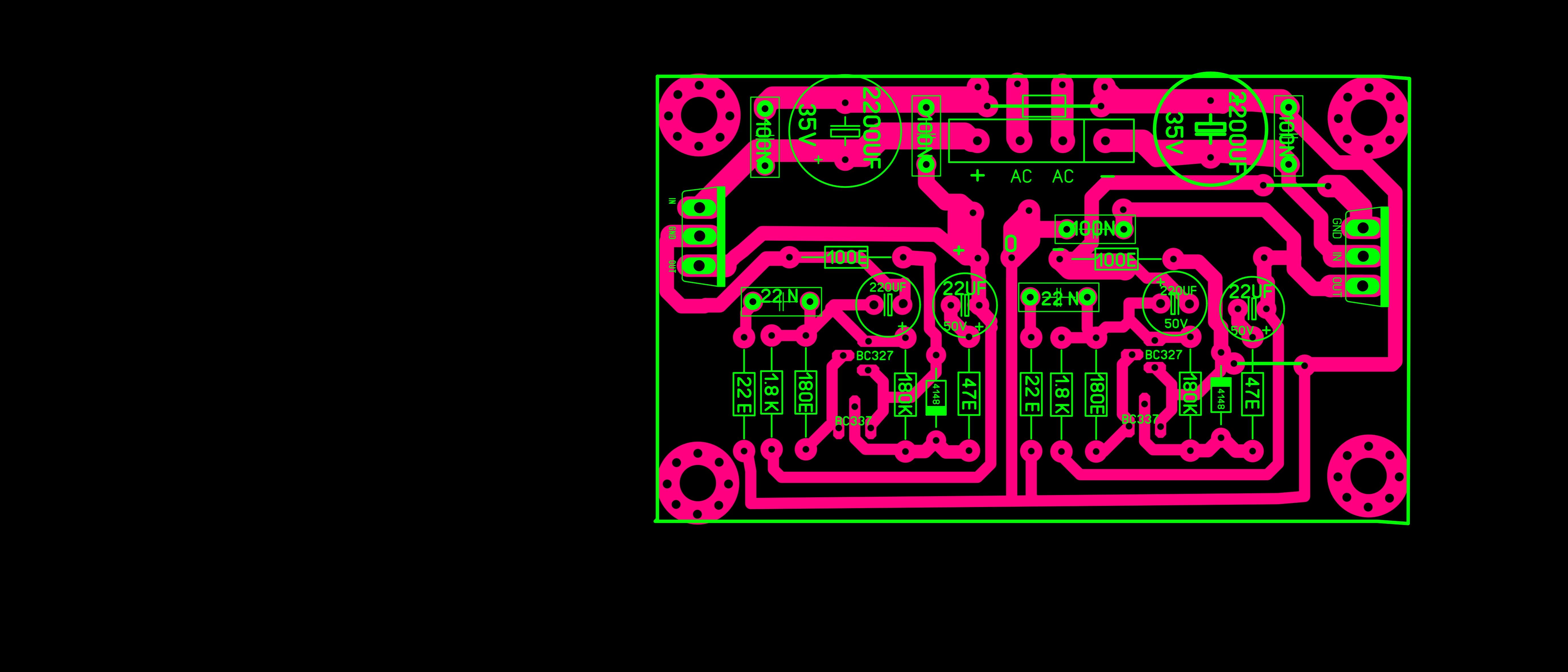

There is this hot fix with the gnd wire between the two caps on the PCB. And the note:
"Placing a short thick wire connecting the ground pins of the supply caps reduces THD"
Two questions:
- whats the background, why does it reduce THD ?
- doesnt make this wire a big GND-loop around the PCB ?
Thx !

Hi Cortez, there are many more ways to increase THD than by unlinearities in the amplifier itself, one is modulated ground, caused by large currents flowing in the gnd. This "thick wire" simply shorts out the current ripple introduced by the 1000uf caps. This mechanism can create easily >0.1%thd, getting really bad for higher freqs.
In theory this wire creates a nice loop which could act as antenna, but it seems that the signals received by this are very low compared to the currents flowing, at least it did not show problems.
With the revised layout (5.3) a single trace goes to this connection, nearly nulling out these currents.

Hi Mike
But this wire operates between the two caps, there is no big current there in theory.
And whats the base about this frequency dependence ?
Grounding is "just" wiring, which means mainly ohmic resistance, in theory.
I meant opposite, this GND-loop is the "radiator", and the other
parts inside the loop are the receivers, cause current loops are
coupled to eachother, arent they ? -> another GND current- modulation ?
It wouldnt be better if there was a separate wire from the non-signal GNDs to the main PS star-GND ?
(Under non-signal GNDs I mean: the local filter caps, CCSs, etc...)
And an other GND-wire would go from the signal GND to the same main PS star-GND.
(main PS starGND = right at the main caps, not on the PCB)

Cortez, sorry, i am not in the best mood for techtalk these days...
About the grounding wires beeing ohmic resistance only, their inductance seems high enough to cause troubles for higher frequencies...
And with larger supplycaps onboard, the typical star grounding could defeat their benefit.
You're right, this groundloop does induce the halfwaves flowing there into the inputstage, that's why i changed it to single trace in v5.3.
These half waves are visible in the THD measuring as even harmonics.
As i had no problems with hum, i did not research grounding further...
The PSU-ripple in the output measured with -110db for a 2.5v signal, that's <2uv.
Grounding is difficult as it is THE reference voltage throughout the system, but has to deal with large currents.
Mike
No problem of course, and I wish you the bests !
I see, really, so low ohmic and inductance GNDing is the ideal.
And what about capacitive GND problems, how they occur ?
Why? I dont see this. The point is, just not to share different GND-currents on the same GND wire, isnt ?
So if these onboard caps have a different GND-wire to the main caps, it wouldnt be a problem.
Sometimes unbeliveable how much depends on wiring, GNDing, layout....
Otherwise if I put my main caps near to the output transistors
(5-10cm) it also recommended to use these 1000uF local caps on board ?
I would be very interedted in this researches, maybe it counts a lot... 🙂
Grounds should be connected to the main GND on caps as late as possible, i guess.
And with a thick wire, to minimize the resistance too.
Thx for reply, cheers !
