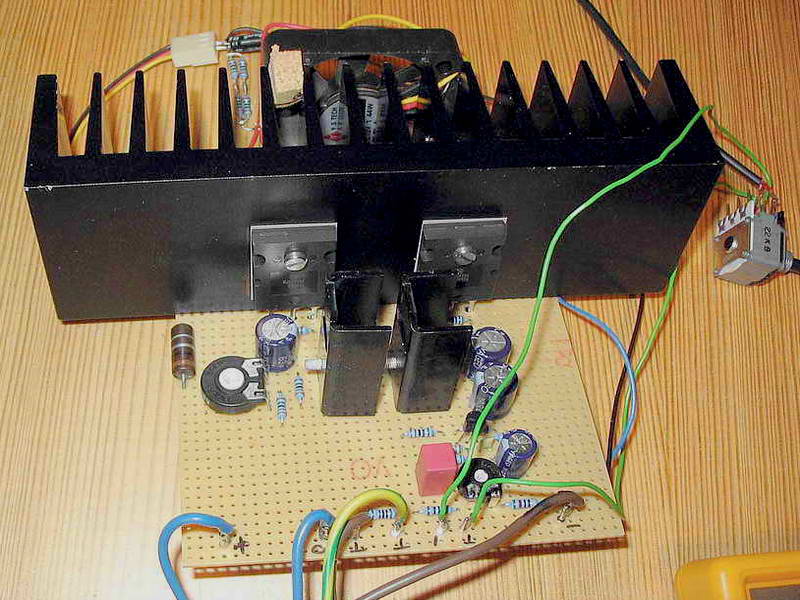

I have completed my SYMASYM and connected it to my main stereo system and the result is no less than phenomenol. It beats my previous DOZ power amp in every aspect:
1. The mid range is noticebly better than the DOZ. It sounds more open, clearer, sweeter and more dynamic. I do have to run the output transistors at 725 ma bias to schieve the result. At 500 ma it did not sound quite as open or dynamic. I was not able to increase the bias beyond 725 ma with my current power supply and the 1000 Ohm trimmer.
2. The frequency response is very good. The highs and lows really shines.
3. The 60 Hz noise is very low.
4. I used a SCSI CROM, a soundcard and a California Audio DAC with the DOZ to achieve satifactory sound. With SYMASYM I only use a standalone SCSI CDROM drive.
5. I had to use a tube preamp for the DOZ to improve the sound and I am able to bypass with the SYMASYM.
I believe the SYMASYM is not only an excellent power amp, its voltage amplification stage also matches the performance of the best preamps available, supplying plenty of sweet second harmonics.
Thank you again for giving me a chance to own such a beautiful instrument without beaking the bank.
P.S. I used MJL0281/MJL0302 power transistors, Blackgates as input capacitors and some Cerafines and blackgates at power bypass.
DOZ, beeing a JLH design is only a reference, and a very good one.
Hi Tim, thanks for the compliments !:cheerful:
Phew, 725ma, that's quite a heavy bias ! Have you also tried 113ma ?
If you use that "highend" elyts, you might be able to skip the 100nf bypass caps, except maybe the dc-blocking one.
One question, you said you use a standalone cdrom, does this mean you use the internal DAC of the drive ? But, of course, using less devices in the signal path is always recommendable...
The MJL0281/MJL0302 seem a good choice, they show good sound.
If you want to increase bias further, you need to decrease the 500ohms in series with the trimpot (R24), maybe 330ohms.
Nice to hear that you are very pleased !

Hi MikeB:
I just tried 113 ma and found out that bias level is a matter of compromise and personal preference. I found that 113 ma level gives me a lot of sweet harmonics, a very dynamic sound and a deeper/wider sound stage, but it also gives me a slightly restricted middle, most noticeble in human voices. Now I am running at 236 ma without compromising much of the merits of 113 ma, but with a more open middle. I suppose that I went overboard a little at 500ma and 725ma, since I was so used to the pure class A sound of DOZ. Of course, this restricted middle may also due to that my Blackgates are not quite break-in yet. They are known to take at least 200 hours to form properly.
Yes, I am using the internal DAC of an external SCSI CDROM (Plexor PLEX12). I am quite surprised that it can sound so good with SYMASYM. As I mentioned before I had to use a M-Audio sound card, an external DAC and a Tube preamp to make the DOZ sound decent.
