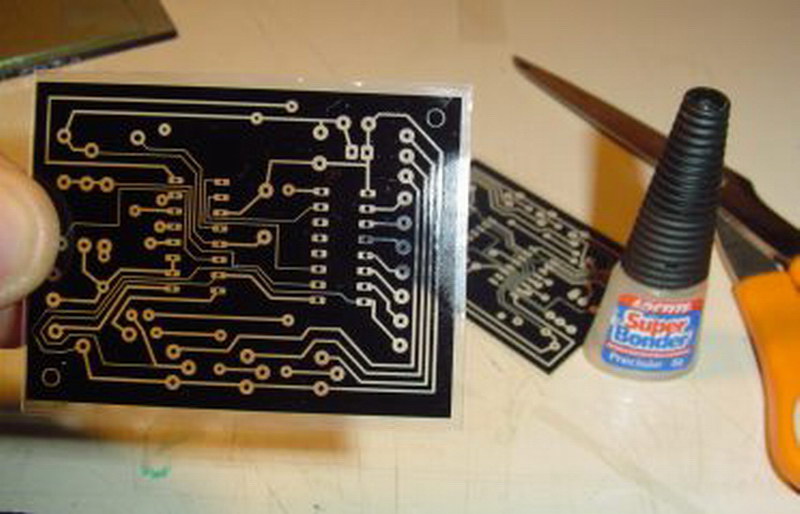

Symassym is beeing constructed in Brazilian Capital
Boards are starting to beeing made, my nephews are making them, some units will produce nice sound in our Capital.

Yeah!...my nephew is starting the work, today we gonna construct the transformer
reconstructing a 220 to 110 Volt AC transformer...it is a 1 Kilowatt trafo...it may work fine with a heavier gauge wire on it.
Here is the image of my nephew and the circuit to be made using a photo process.
