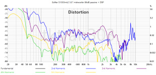

Here is a no-frills 5.5" midwoofer from this speaker
I measured it previously here
This time we see what current drive and a series notch filter can do.
Since one of the speakers has all the electronics, and the other speaker has none, it was easy to use this 2nd one as a test box.
First up we drive with a exponential since sweep at 2.83V, then put a 10 ohm resistor in series and drive again with 2.83V. As expected the SPL goes down. So we equalize it ("DEQ") with software, and drive it again to match the original SPL.
Now we can compare harmonics between the 2.83V drive and the 10 ohms series resistor + DEQ driven model:
Next we investigate the effect of a passive series notch filter. All harmonics are plotted at the harmonic frequency to help see the effect.
Click the thumbnails to see the difference:
Finally let's bring it all together-
What a digital EQ can do, in a traditional active speaker:
What a passive notch filter and 10R resistor can do:
Here it is in dB down, at equivalent to 86dB /1m
Appendix: impedance trace with the 10R resistor in series as well as the passive notch filter.
Conclusion- Active has advantages. Passive has advantages. We can use the best parts of active (crossovers by mouse clicks) and best parts of passive (reducing harmonic distortion) all together!
To put it another way, the active fanatics were right (convenience, cheaper) and the passive fanatics were right (it may sound better)
They/we are both right <-> They/we can be friends!
