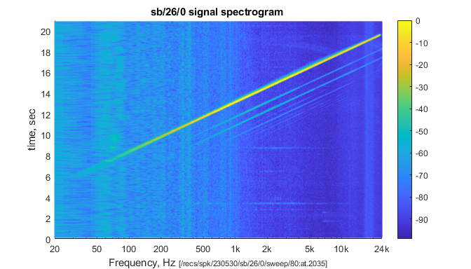

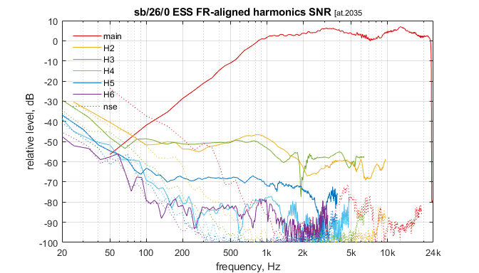

Spectrograms show all the harmonics, including the distortions that may not be included in the main/H2/H3/etc graphs. Let's consider SB26st tweeter, to start with. The "Raw" results of the exponential sine sweep aka Farina test are shown as a spectrogram. It contains the yellow main ridge (with FR coded as color intensity), and harmonics - the ridges below, which are much less intense. They follow in the order up->down, 2nd, 3rd, etc. If you move a horizontal ruler flat along the time axis (up-down), you will first see the main frequency, then its 2nd harmonic, then 3rd, all color-coded. If you move a vertical ruler along the frequency axis and look up->down, you will also first see the main frequency, and then the 2nd harmonic of f/2, then the 3rd harmonic of f/3, etc. Most often, this "ruler" is the source of the plots you see in datasheets, etc. IMHO, It is quite confusing because you need to compare (say) the H3 on a frequency with the FR on f/3.
If you see a horizontal strike at some moment of time, it's most likely a noise burst. You would likely see some low-frequency noise from cars passing by, their pitch will vary.
The spectrogram has all the info but it is hard to deduce the number values from color intensities. Often, I plot only the residual of ESS, with the main ridge taken out due to its very low informativity.
Thus, let's plot only the ridges of the main and its harmonics, below.
On this plot, you see the main ridge (red), and H2, H3,.. etc. The harmonics are relative and calculated accounting for the difference between FR(f) and FR(f*n) where the n is a harmonic number (that's why it is named FR aligned). This plot is not exhaustive. Sometimes you have a very long tail of harmonics (like AMT) but you don't have enough colors to plot all the Hns. Happily, in the cases of good drivers and reasonably low SPL, only a few harmonics exist, the rest are well below noise.
The plot above also exchanges precision with frequency resolution. You can see lines of it which you can hardly see on the spectrogram. For DIY home living room measurements, this is my preferred option - however, you can take an opposite tradeoff, your choice.

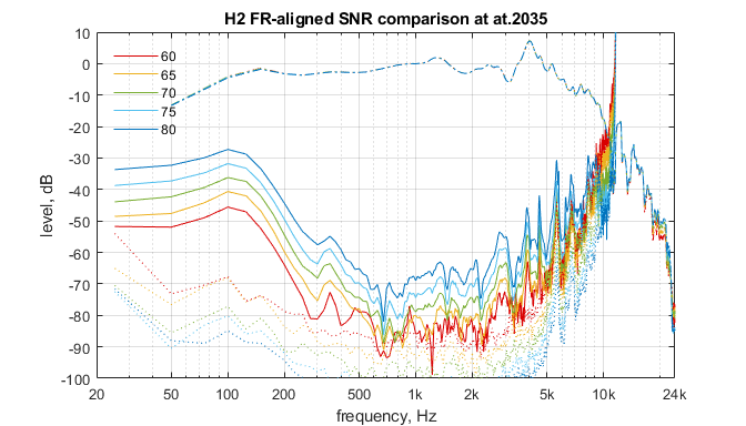

However, for woofers, these curves do not tell the full story, at all. For example, SB12PFC25-4:
Same 80 dB SPL - which is not too loud. Here you can see that on frequencies < 100Hz the number of visible harmonics is very long, moreover, there is a trace of non-harmonic distortions, as solid color goes well into the kHz range when the main is close to 20Hz. Basically, the implicit assumption of harmonic distortions becomes false, obviously. You can also see the resonance at about 200Hz, with a long series of whitish dots. Note that such resonances may be very non-linear. They may disappear completely if you drop SPL by 5 dB.
The same spectrogram is useful when the excitation is not ESS. It may be ... whatever. You can see the spectrogram of the microphone signal of 15 sec from Queen's "Another One Bites The Dust", filtered 300...3000Hz, as if SB12PFC were to be used as midrange.
and the residuals of linear filtering, basically non-linear and IMD distortions on real-world music:
Of course, the best is to listen to this residual - but just plotting its spectrogram may also help.
BTW, this is the spectrogram of the source:

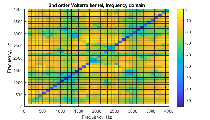

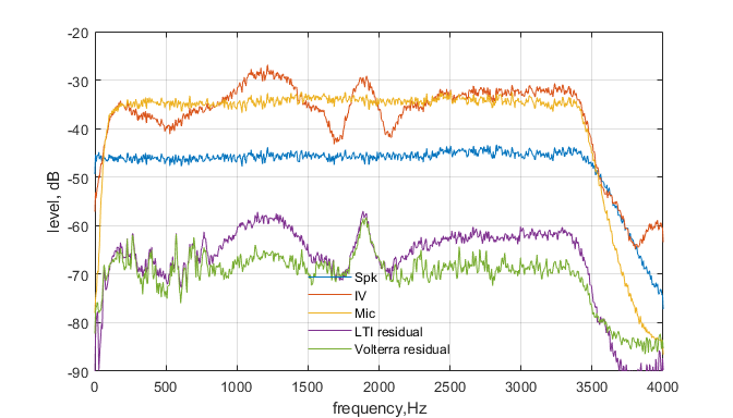

@mikets42:
Thank you for sharing your results, but to me the H3 graphs seem somewhat odd, as there is very little level dependency. In theory, the relative (to fundamental) level of H3 should rise at double dB rate (and the absolute level at triple rate) when SPL increases. This is also quite what I observed when doing my experiments way back. Any explanations to this? The H2:s OTOH seem to follow their corresponding rule.
@ETM - I agree with you re H3. Lars von Purify also wrote about it in length. I do not know of any explanations. I observed somewhat similar behavior in the non-linear systems with feedback, where the non-linearity was a soft central clipping as in class AB amplifiers... but I would not jump to conclusions.

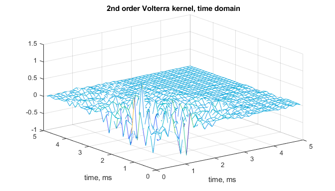

H2 is also not so simple. I tried 2nd order IV Volterra kernel. It converges fine but the residual error reduction is only ~8dB. I am quite puzzled by it.
If you or anybody else knows non-linear system identification well, please let me know. I would be very glad to cooperate.

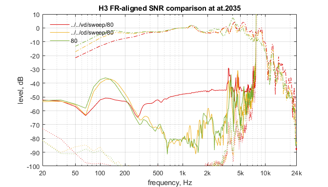

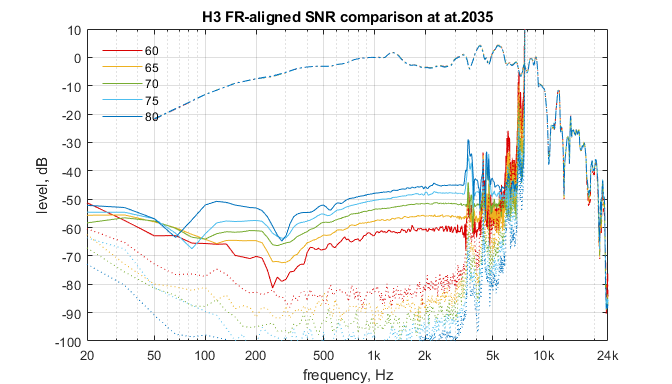

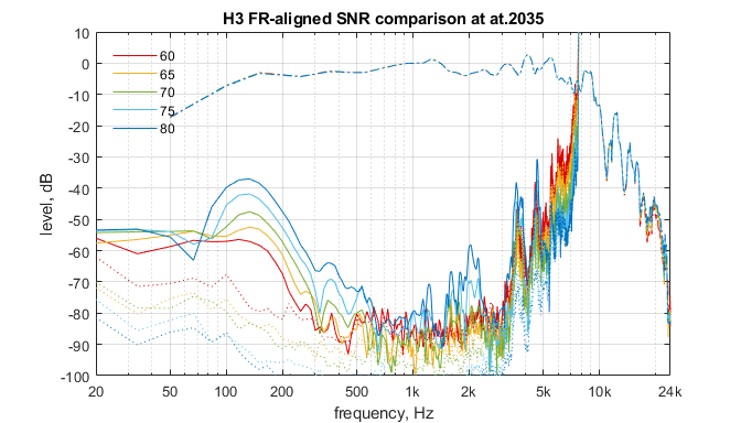

Voltage drive:
Now current drive:
and now current drive with a mod: a layer of foam tape on the top of the cone, and a thin layer of epoxy resin on the top, to make an I-beam composite.
The H3 in the range 600...1700Hz dropped by 35dB, from -45ish down to -80 dB, in half an hour of work to modify an amplifier from voltage drive to current drive, and cone from paper to a composite. I looked at all that ... and decided to change FSAF/etc licensing terms from GPL to BSD because the audio industry's state is beyond pathetic.
Voltage drive:
Now current drive:

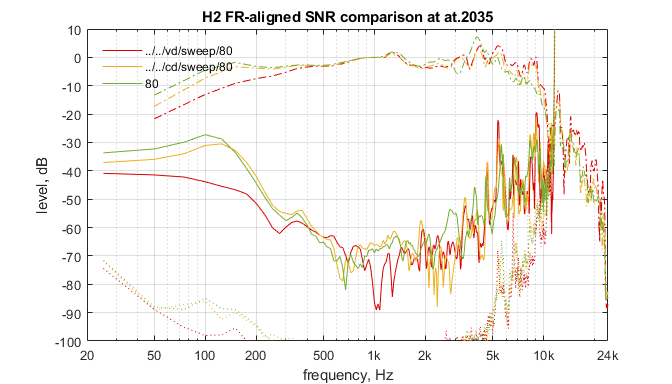

Hi, if you don't mind here are the above images as thumbnails to enable the gallery mode which makes comparison bit easier.
These are the H2 graphs as appear above, H2 voltage drive, H2 (1) current drive, H(2) current drive with cone mod.
Here the H3
It looks like there is some change on things with the cone mod, but biggest obvious difference seems to be just the current drive.
It's kind of understandable from business perspective to have bit worse performance if it makes more practical and cheaper systems, enables interchangeable amps / speakers and so on. But from DIY perspective there is no reason not to try and reduce motor distortion by experiemnting with current drive. Why not also distortion from the cone but it's not as easy as manipulating electrical impedance.

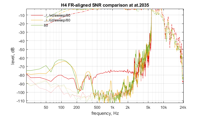

...and here is a direct comparison on 80dB SPL:
pretty much the same with the H4,H5,etc

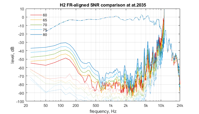

I've already been asked a few times why I do my measurements on 80dB SPL - and not on "standard" 94 dB SPL (=1Pa) and how to modify an amp to be a current driver.
1. 80 dB SPL is already pretty loud. 1Pa is horribly loud - and you may not want to torture your family and neighbors. IMHO, it's not worth it.
2. 80dB SPL is about as loud as a usual home speaker driver can sound without going into soft saturation. Many pro audio drivers are also not capable of producing undistorted sound above 85dB SPL.
The number of visible harmonics is ... high, and they are not decreasing fast enough. From the theory of Fourier transform, we know that discontinuity in a function derivative of Nth order produces harmonics decaying with (1/n)^(N+1) speed. Here, we have - more or less - 1/n speed, which means the discontinuity is in the sound pressure function itself. That shall also result in the wide spread of IMD products making them unmaskable. This spread of dirt is often limited only by the cone's capability to reproduce high-frequency content.
3. The only solution I am aware of is N-element line arrays. You produce 1/N sound pressure at each driver and, in the Fresnel zone, you get ~1/sqrt(d) loudness decrease with distance, instead of 1/d for point-source. No wonder 24-element TC9 line arrays sound magnificently (for f>500Hz).

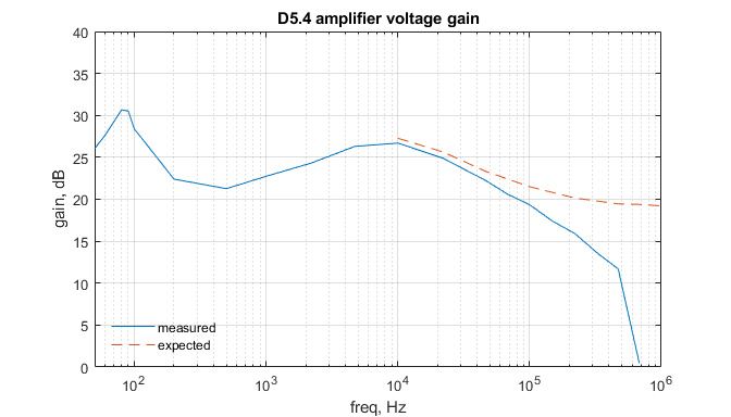

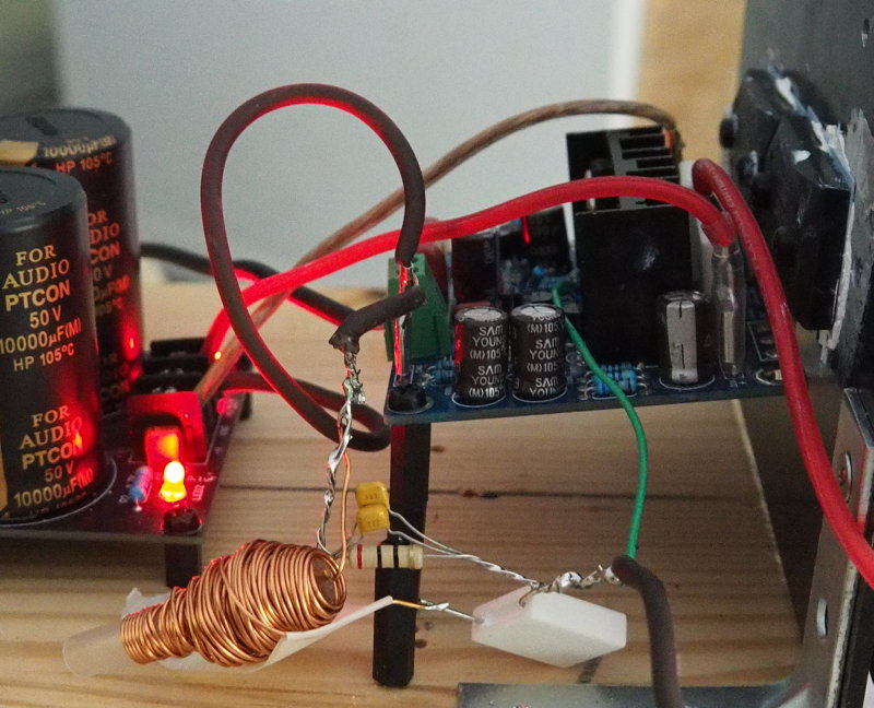

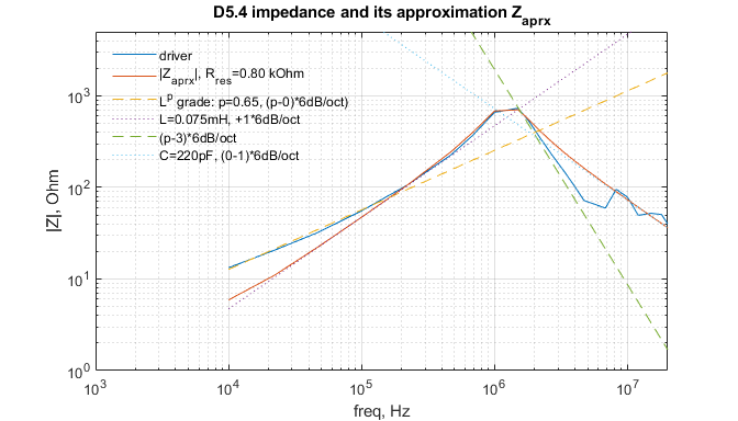

Modifying an amp, step by step.
1. You must have basic knowledge of electronics and the theory of control. Take an MIT/etc YouTube refresher course if it is rusty.
2. You'll need an oscilloscope and a sine generator, >= 5 MHz. Look at eevblog for honest reviews.
3. measure driver's |Z|.

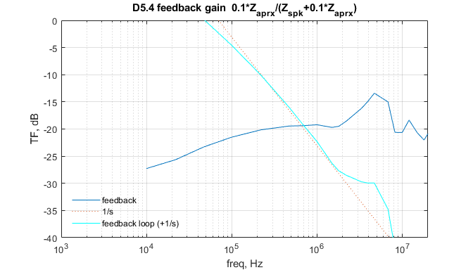

4. Say, you are targeting 20dB voltage gain. Make an air-core Lres/10 inductor if you can't buy it. Measure it by applying 1MHz, in series with a known resistor.
5. Assemble an |Z|/10 equivalent network. The gain the feedback loop shall look like this:
Make sure the feedback gain slope is not negative to be phase-margin-safe.
6. Attach the Z/10 /(Z + Z/10) divider output to the IN-, directly (green wire below) or via a capacitor. The value of the capacitor shall be > 1uF for the pure current drive, and less for the mixed drive (your mileage will vary). The amplifier, feedback network, and the driver itself shall be one "reasonably" compact device for f <= 10MHz. Long wires across the room from the amplifier to the loudspeaker are assured: "no-go".
7. Test the amplified + driver with a scope and signal generator. It shall not be any close to ringing on f > 100kHz. Here is an example using LM3886:
Most chip-amps are not unit gain stable. They must have a gain >= 10 or a phase-positive feedback network (like the one above) if the gain is < 10. Be careful and test twice🙂
8. You may or may not need to modify the cone. They often exhibit high-frequency ringing which is very nasty as it amplifies harmonics. They are generally not stiff enough and have too little internal damping. Technology-wise, they are stone-age. The normal solution is I-beam aka sandwich aka composite. Airplane modeling provides excellent tutorials on achieving maximum performance with the lowest weight. Foam / Balsa reinforced with carbon/aramid mesh and epoxy resins are field-proven to be quite close to the optimal aerospace industry materials (although lacking extreme condition toughness).
