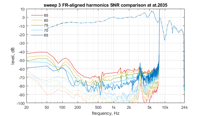

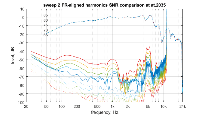

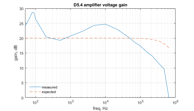

Here, amplifier voltage gain on HiVi D5.4:

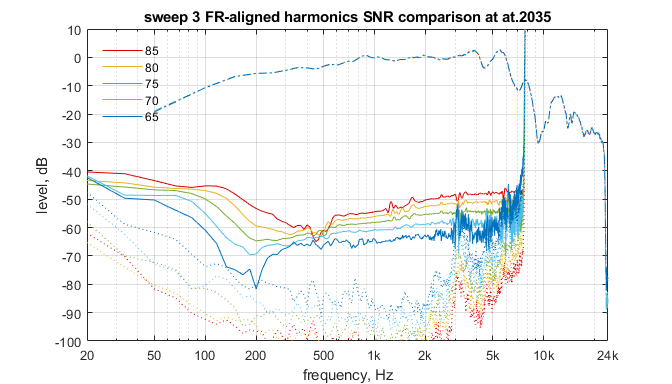

Same driver, on voltage drive, 2nd and 3rd harmonics for outputs varying from 65 to 85 dB SPL.

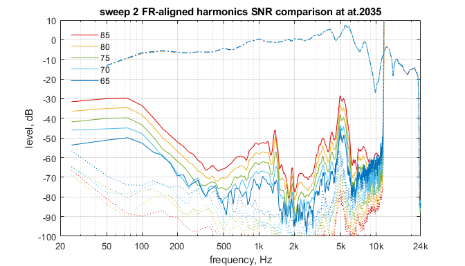

Same driver, on current drive:

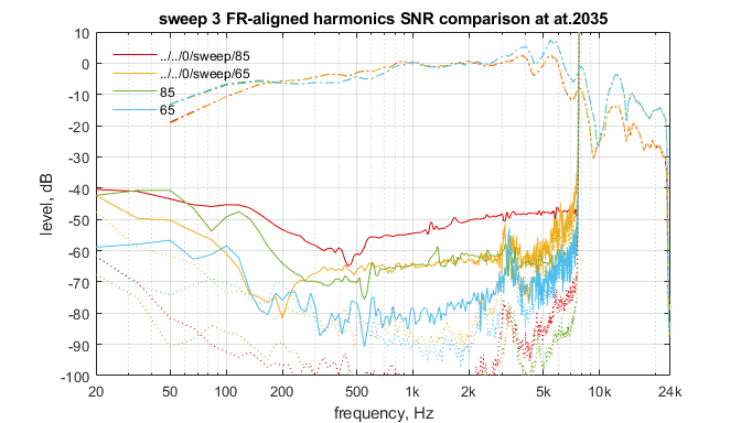

and here is the comparison of the 3rd harmonic on voltage (red+yellow) vs current (green+cyan) drive, for outputs 85 and 65 dB SPL.
I agree. Velocity feedback on the accelerometer - yes, tricky as any nested feedback system. Just preventing it from going nuts on last-stage-saturation requires a PhD in rocket science. Again, it's most suitable to be done in DSP where you have full visibility of what happens inside the feedback loop.

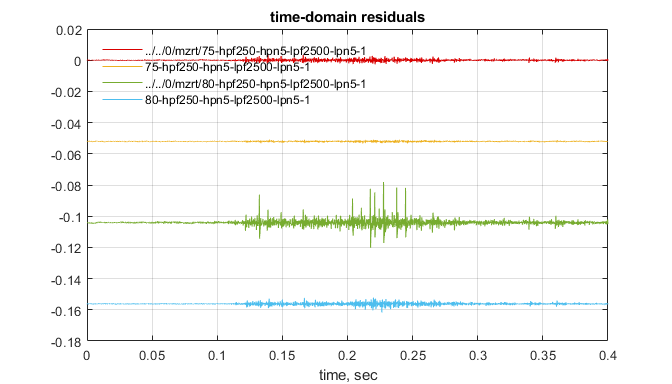

As I hoped, Barkhousen's noise is gone with the current drive. These noises are the short spikes, like Dirac's delta functions, during loud passages, corresponding to magnetic domain flops. Being delta-function alike, they have a very wide spectrum and therefore are not maskable. For my ear, they are especially annoying on piano.
Here are the non-linear residuals of playing a Mozart's 20th piano concerto's tutti through HiVi D5.4 on
red: RMS 75 dB SPL , voltage drive
yellow: RMS 75 dB SPL, current drive, distortions are much lower.
green: RMS 80 dB SPL, voltage drive: Barkhousen noise is prominent, emf/Zspk, when Zout (of amplifier) = 0.
cyan: RMS 80 dB SPL, current drive: Barkhousen noise is gone, emf/(Zspk+Zout), when Zout->inf

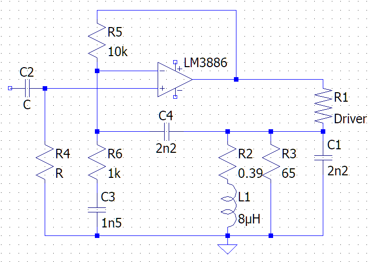

Make your own inverting input, add an op-amp, make your own feedback loop.

To DcibeL: On Mauro Penasa amplifier: it's quite complicated. I don't understand how it works - nor why it is advertised as a current source. I also live in BC ... could I see how well it lowers the driver's distortions?
